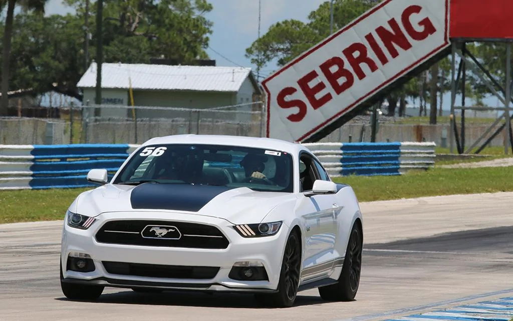

Here are some great some pic's of Our Steeda Progressive springs in action at Sebring International raceway.

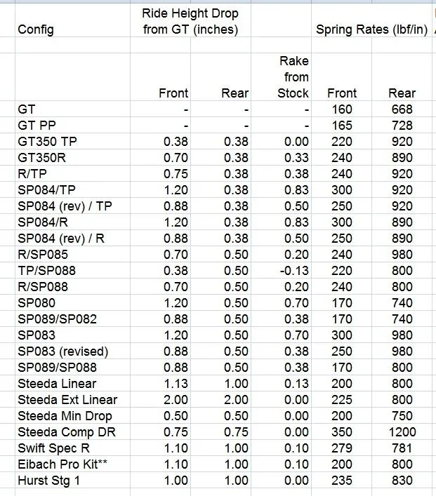

Given that you're going to sell or trade this car inside of two years, I strongly recommend against lowering it more than about 1".
Snipped from a spring compilation put together by BmacIL.
I have no idea where the cost of professional installation runs. Sorry.
