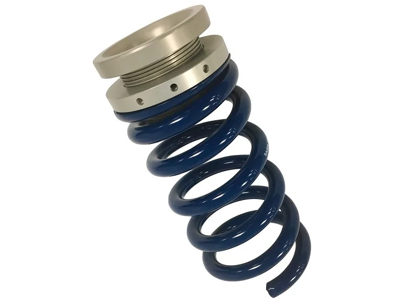

This is what I use. Steeda rear-adjustable ride-height kit. Works great and can adjust your rear ride height to whatever tires you use so it always sits perfectly how you like it. I have mine set slightly higher in the rear for when I swap 305/45/17 ET Street Rs on for the strip.
I also have the Steeda Pro-Action coilovers on the front with 225# springs. My front is on the lowest possible setting allowed 2+ inch drop.
Do you know what rear springs come with the kit? Also this might not be a bad idea, paired with some viking crusader shocks.

I believe they are 850-1000 progressive rate. I use the Steeda Pro-Action adjustables shocks on the rear. Supposedly the Steeda drag car uses the same setup but with 125# springs up front. Not sure what settings on the struts/shocks but it will be trial/error on my car once I finally get to the strip this fall.
