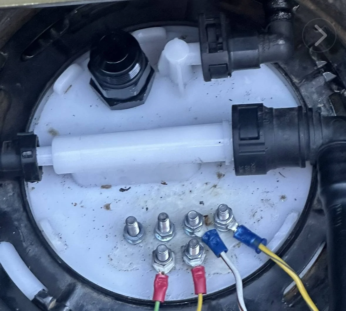

Need to x4 your filter/reg/line/ fittings budget. Quality reg and filter will be closer to $350 to $500. Not including fittings/lines.
You have a pump holder, not the best fuel system.
I'd work out your power feed for dual 525. Picked some of the highest draw pumps available. Might consider sizing pumps for your end goal. Will reduce excess draw on the elec system.The single pin in the stock hat is not advisable for 40 to 50amps. Ford provides a single pin for each pump on dual pump setups. And those single pumps are averaging 15amps with no bap. 1x more benefit for gt350/gt500 assembly. Designed for dual pumps not retrofitted.
Id consider a different hat if wanting to stay your path and keep the bottom bucket stock. Will give you more options on wiring and fittings. Getting that 10an bulkhead to fit, seal and leave room for stock line to be used as a return will be tight. There is only so much room under the hat that the plastic is flat/ smooth enough to seal for the bulkhead. A 8an fitting works better here.

Yes I agree on the cost which was way off and I was actually thinking it was not even a legitimate post and more of just a promotion of this product. Also two 525s can easily empty that stock bucket under certain situations.

I thought the budget was right on as I already bought everything. The bucket is already installed and everything fit fine. But this was put in a f150 so the mustang might have less room to work with, not sure. On the f150 the stock wiring and fuse are setup for 40 amps. As for draining the bucket empty, I can see scenarios where this could be a problem. I might run one stock and one 525.
we modified the top a little for the wiring
