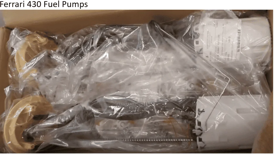

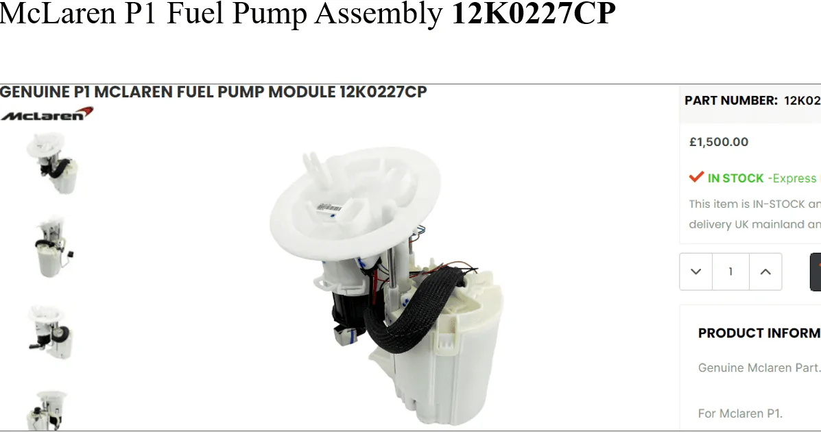

For me, after I evaluated the unique shape of my Mustang GT fuel tank, which has no slosh type bladders, and being small, I definitely agree. With such a small tank, and Ethanol burning about 30% faster than petroleum gasolene Under boost, I did not want to have to start looking for a E85 gas Station ever 70 miles or so (1/2 Tank), to me that's just plane crazy. I know people are running bucketless systems with no issues and I'm glad to see that But, I am a "What-If" guy and to me a bucketless setup with the mustang tank design, just has to many of them. Plus, something I happen to notice when researching HP Cars is, they all seem to use a Bucket style type design fuel pump assembly. But that is just me. When I made my final decision as to which Fuel Pump assembly with bucket I wanted. I went with a Bucket style Fuel Hat Assembly which not only continuously cycled fuel from the bucket into the tank to keep the fuel cool, I also wanted PWM controller which plugged directly into/worked directly with my OEM FMP, FPDM and PCM circuit/system. Don't know how it will work, I will see in the coming week.
Sooooooooo........ who sales a complete system on this style? Seems you and I have the same concerns as far as drivability goes. I have no idea what OEM,FMP,FPDM,PCM circuit system is either.

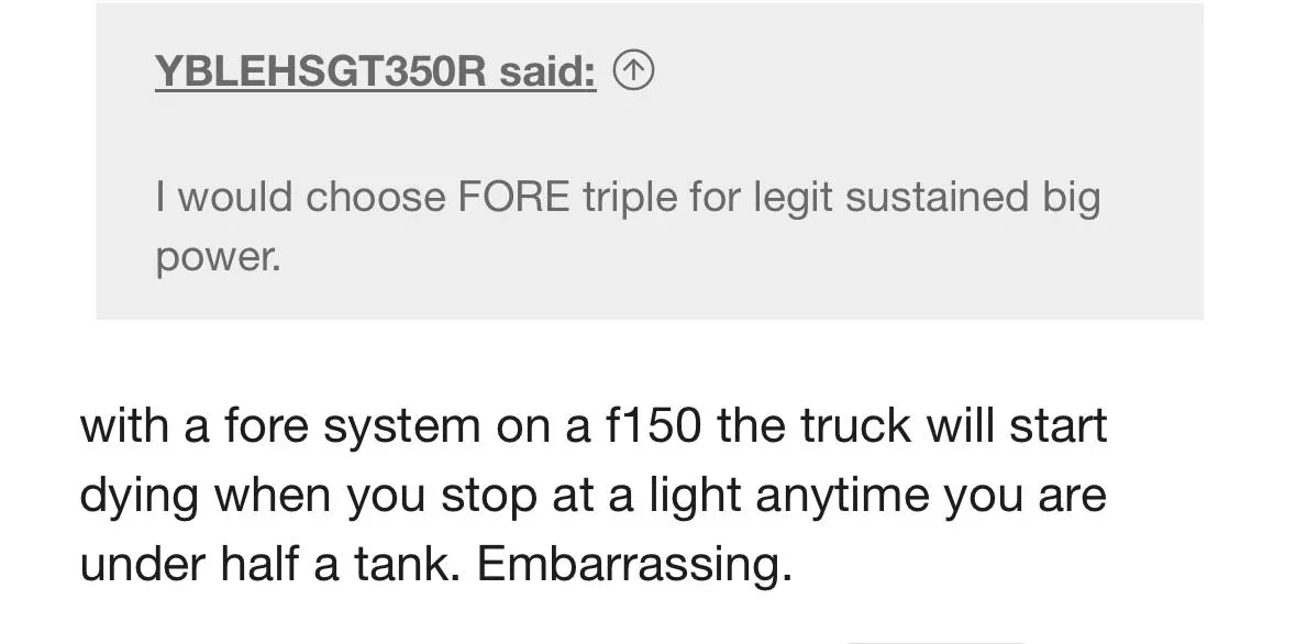

Mustangs with Fore systems die at lights under half tank? My car must have not gotten the memo.
almost seems like the trend after 2020 or so is not to come out with a product and sell it based on its merits but rather come out with a product and talk down every other competing product until people believe it and buy it….
Without the bucket. Pull up and stop hard and see what happens

s550
If you had been keeping up with the conversation you would have seen this
I’ve raced and braked plenty from 150mph….car has never shut off in a racing environment at half tank.
only shut off once going into a gas station at nearly empty, around 10miles to E.

And I’ve never had a car die or a truck at half a tank
Not really sure what high horse you’re referring to. I never said that people don’t have to make a profit. In fact I think I said that exact thing. I said that those kits were made for someone to make A profit.
Also those kits are not saving thousands of dollars. There are many different ways to build your fuel system, some can be thousands of dollars some can be hundreds. And you can get the job done a lot cheaper and achieve the same results with a little knowledge.
The f150 will have problems if you stop hard with half a tank
