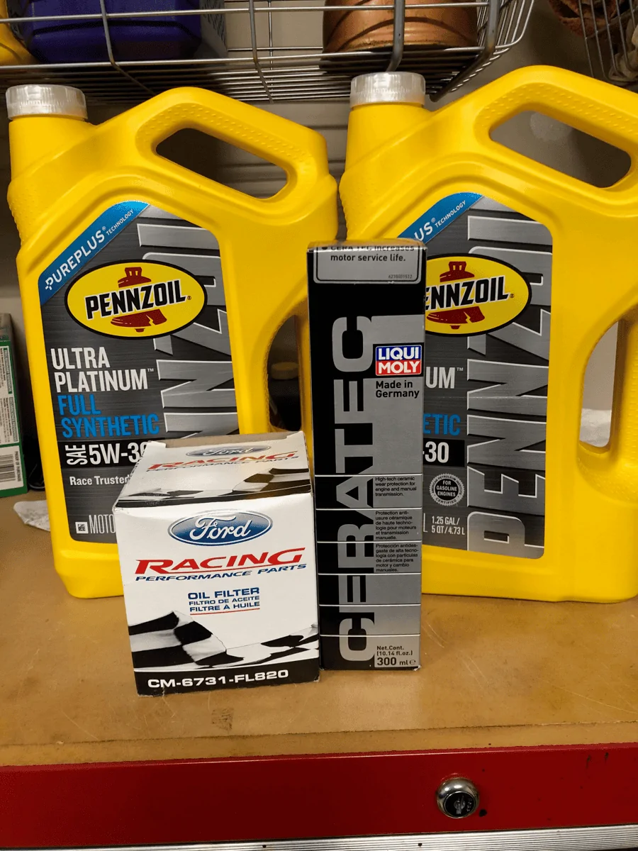

Posting a photo I took in humor related to this topic... so please take it that way... but also in seriousness as the Ceratec, for me, has simply become something I plan for. Also, the bottle(s) of Penzoil Platinum Plus (I prefer 5W30) say SN Plus on mine as well (ordered from Walmart)....with that, I present to you... "Mustang Oil Change Kit" :) This is what I am using currently and am prepping for another change... no ticks, rattles, etc... (note I did have the "tick" after my first oil change... Ceratec took care of it)...
Right you are Sir!
