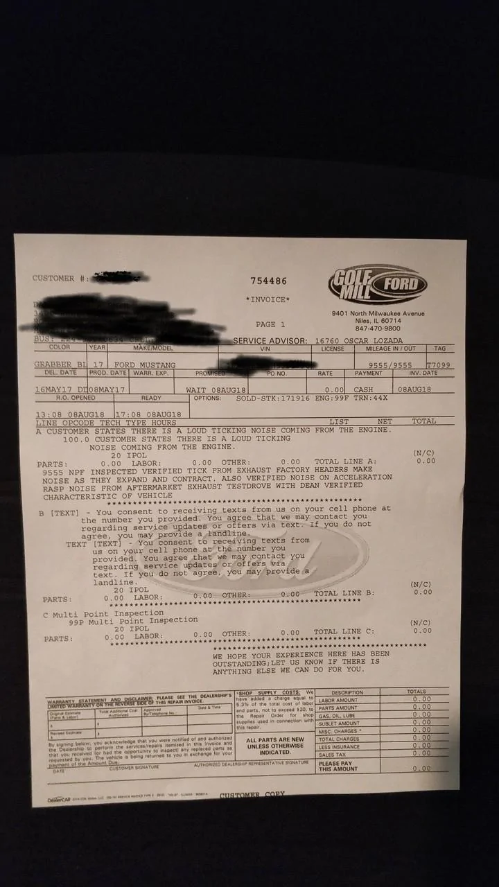

Not much of a drive since the mileage in and out is the same lol.Thats the report they gave me... Seriously, this is bullshit.
When they drove the car out of the shop I could hear the tick from 100ft away and it got faster with more RPMs... So how an expanding noise get faster when accelerating?

FFS, that's my noise to a "T".Thats the report they gave me... Seriously, this is bullshit.

Interesting data point. If Ford denies warranty because of an X-pipe they are total scammers trying to get out of warranty claims.UPDATE!
I just came back from the dealer. I talked to the technician.
First thing he asked me if I had a tune. I said no, it is all the way stock (I didnt mention about the X-pipe. It is the only thing I have).
He said, he found that the intake timing is advance by 20degrees. when he kills the vct solenoids the ticking stops. He reported this and now he is again waiting to hear back from Ford!
