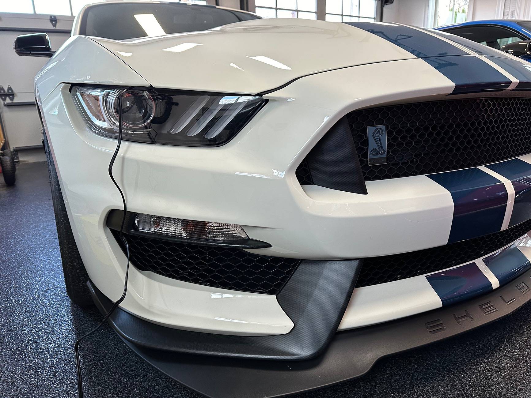

My 20 350, my R, and my 500 have all been hooked up to the terminals directly. The quick connect/disconnect is zip tied cleanly to the harness and when the chargers in use it comes out the front like NPTR did his. Mine have been set up like this going back to 2020, and I’ve never had that message on any of them. I use the Battery Tender Costco has for sale a few times a year on special.
