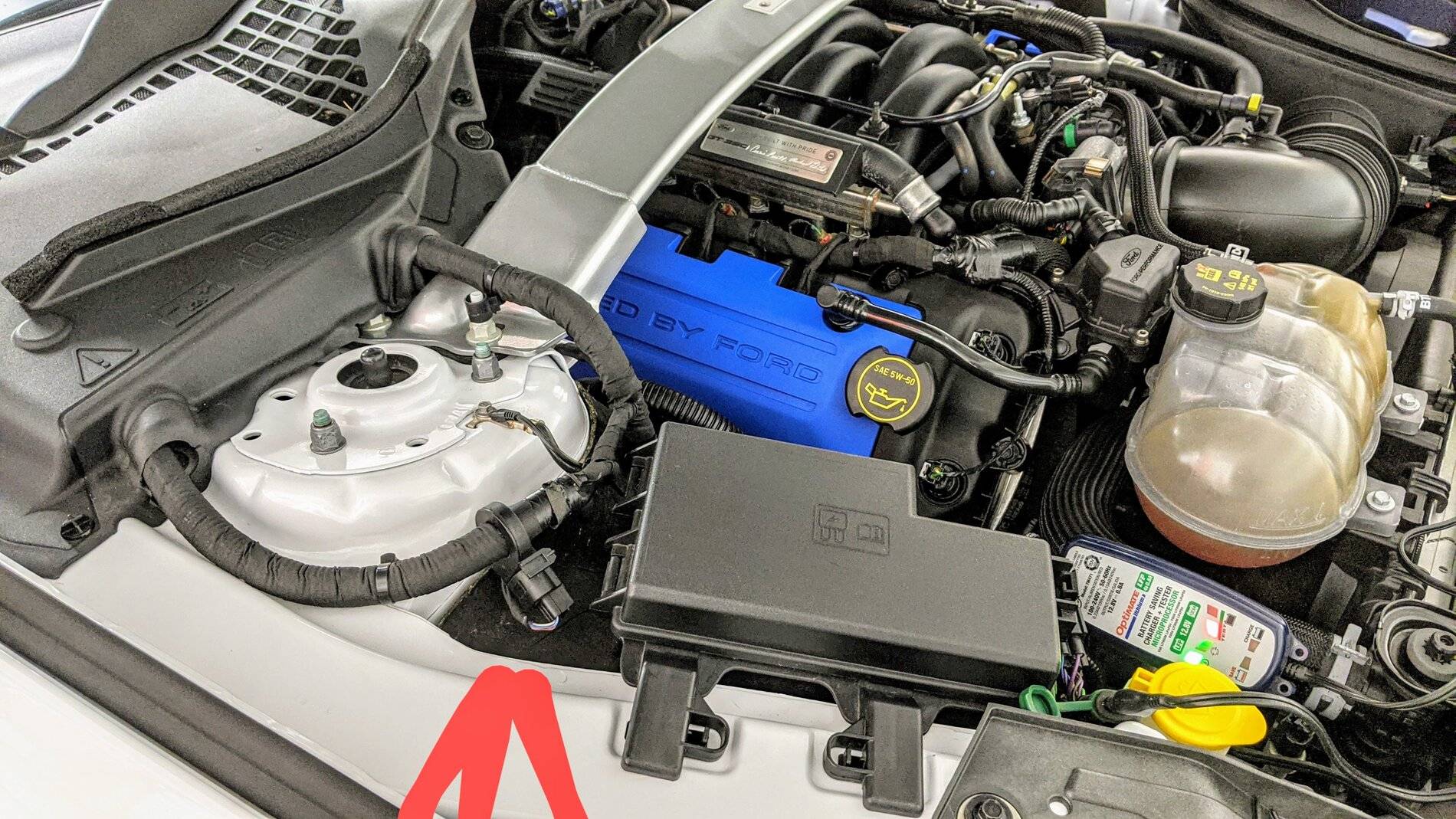

So as we know you cannot use the negative terminal .
On the shock tower there is a ground connection , can that be used or does the fact that the wiring harness is directly connected to it put in the same category as the negative terminal?

I've just been using one of the strut bolts. Seems to work fine.

Mine is connected to the shock tower as in your illustration. The reason for not connecting across both battery terminals is this:
From The 2020 Mustang Service Manual
Battery Charging
When charging the vehicle battery by connecting the charger to engine or chassis ground, the negative charger clamp must be connected to an unpainted chassis surface or a solid engine component such as a generator mount or engine lifting eye. In this instance, after charging, the BMS Reset is not required. Through this method of charging the BCM updates the battery state of charge during the charging process.
When charging the vehicle battery by connecting the charger to the negative battery terminal is necessary, such as when using a combination battery charger and battery tester/analyzer, like the GR 1 190 V3.0 Intelligent Diagnostic Charger, the BCM does not immediately update the battery state of charge. In this instance, the BMS Reset must be carried out using a diagnostic scan tool. This reset is needed for proper engine off load shedding and to prevent invoking of engine off load shedding earlier than normal.
If the reset is not carried out, when the battery is charged by connecting the charger to the negative battery terminal, it takes approximately 8 hours for the BCM to learn the new battery state of charge.
During this 8 hour period, the vehicle must be undisturbed, with no doors opened or keyless entry button presses. If the vehicle is used before the BCM is allowed to learn the new battery state of charge, engine off load shedding can still occur and a message may be displayed.

Yes. My CTEK - 40-206 MXS 5.0 instruction said the same. But my other cars manuals said to connect negative to the body ground. First I did as the CTEK instruction(negative and positive to the battery terminal) but then I changed negative to the strut bolt. Works fine either way but I want to be on the safe side.

That is where I attached my CTEK ground. I believe if you attach there, the current flowing to the battery is picked up by the sensor on the negative battery cable and updates the current state of charge. Or I have just gotten lucky and haven't had any issues with the smart charging system. I did this based on what I read in my service manual - same as what @Postal Bob posted.

As everyone else pointed out — the same applies for any smart charge/battery management system (BMS) Ford or any other manufacturer that isn't using an old school dumb charging system including GM. I haven't seen the message on the mustang but during my data logs after the car sitting on a maintainer for a month and going immediately for a drive — I have noticed that the car charges at almost 15V. AKA the car thinks that battery went dead even thought it's been charged.
This isn't a terrible thing... a little harder on the battery. Traditional dumb charging systems are definitely much less flexible and are apt to overvoltage scenarios. Part of the reason for a BMS is to extend the life of a battery by supplying the best possible power at the correct time.. difference between a Battery Tender and a dumb Trickle Charger for example.
As a few other folks pointed out — there is a BMS inductive ring sensor on the ground cable that helps the car determine the battery's state of charge (SOC). Many GM vehicles uses the same style system. Placing the maintainer after this sensor like on the strut tower helps the car take into account the extra power.
However I've still found the Ford documentation to still be applicable even with the above. Disconnecting the maintainer and waiting for the car overnight to recalculate the batteries actual SOC prevents the car from charging at 100%... but I haven't had an issue just going for a drive immediately.. just harder on the battery for a day.
