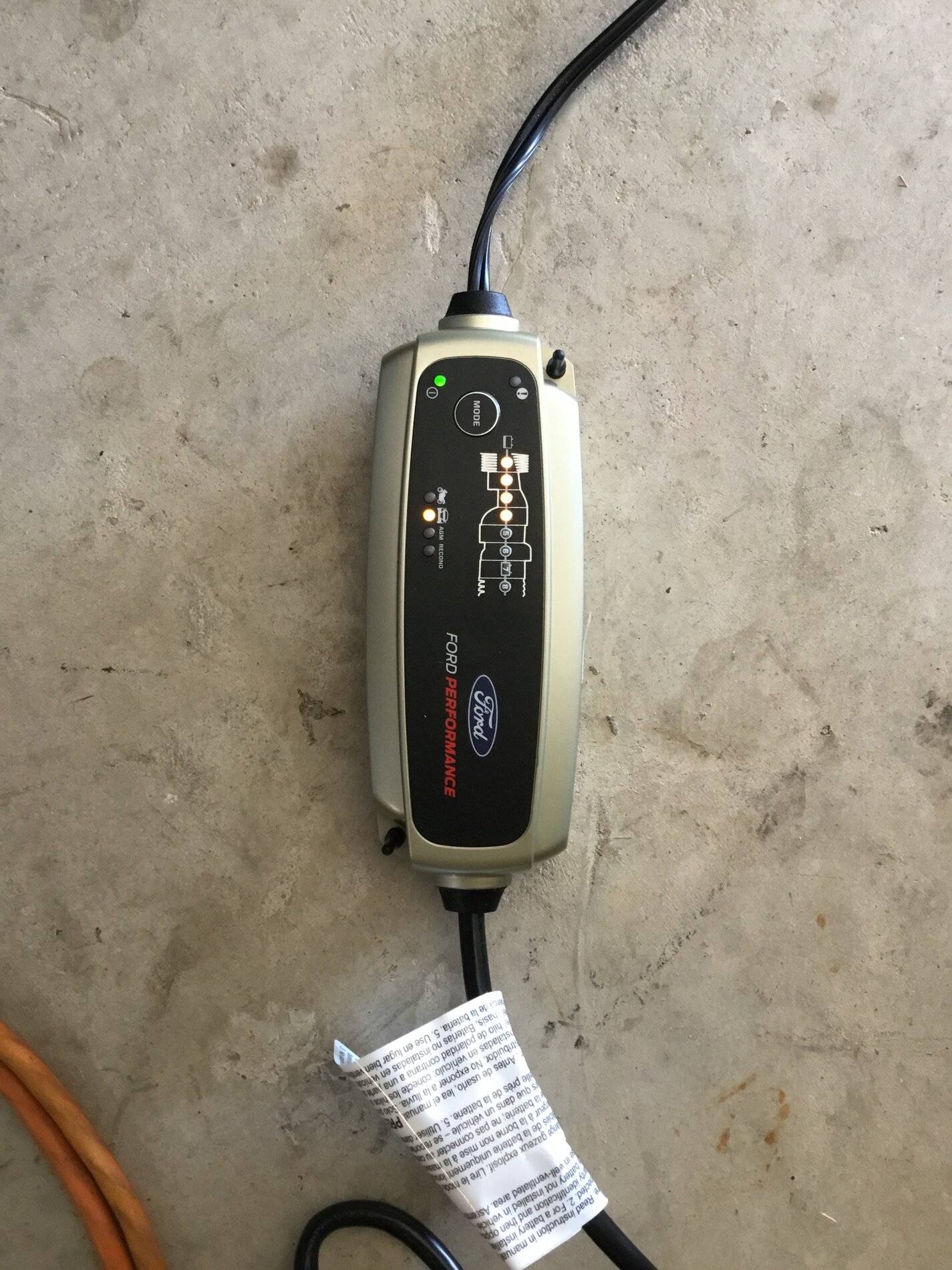

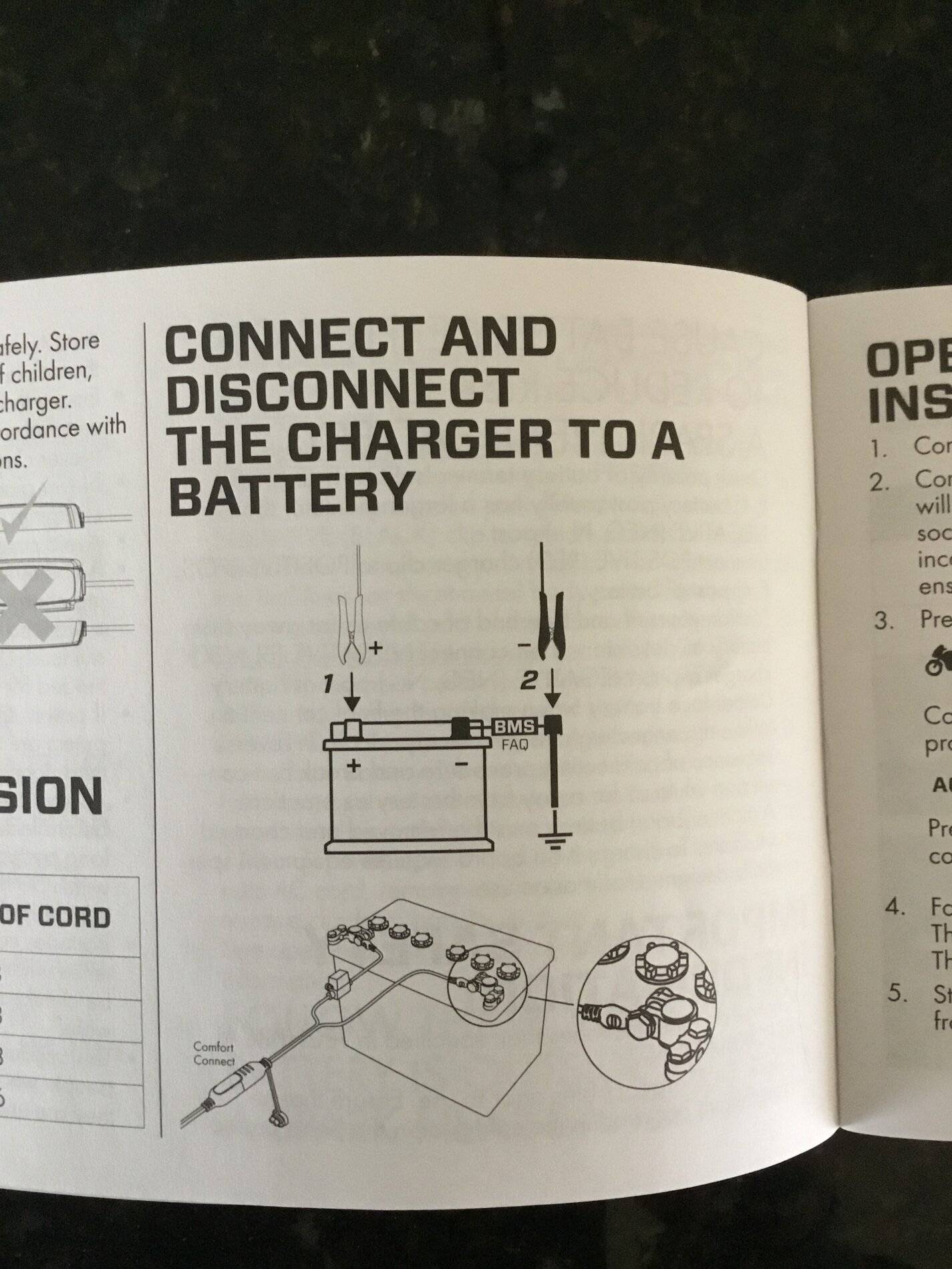

I purchased the Ford Performance MXS 5.0 and it came with the following recommendations. Positive first, negative second. Reverse the order when removing. Install negative after the BMS

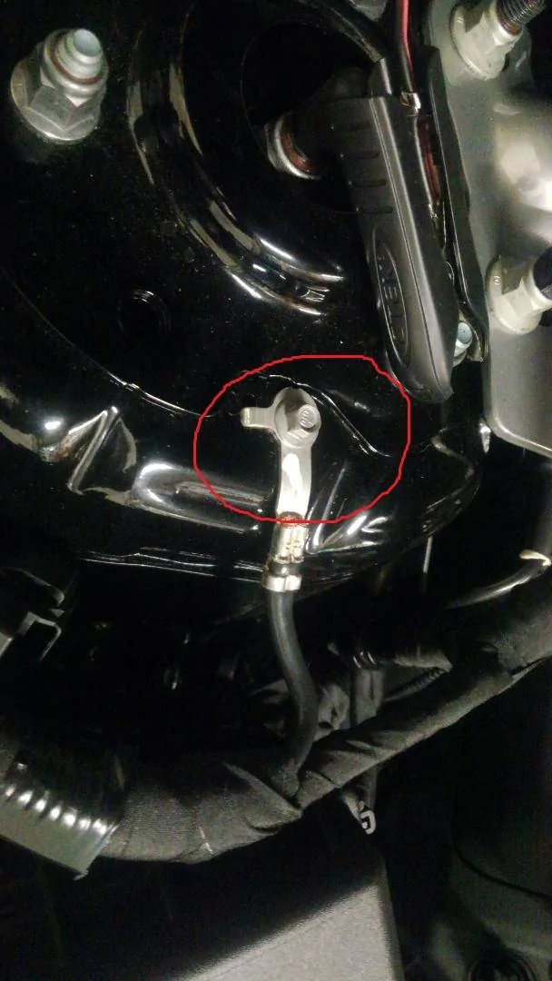

It's because the ground cable heads back to a harness, not directly to the frame like on our old cars. Directly to the negative battery bypasses the harness.
I'm attaching a picture. Notice my charger cable at the bottom of the picture and it's grounded on the shock tower where others have already suggested.

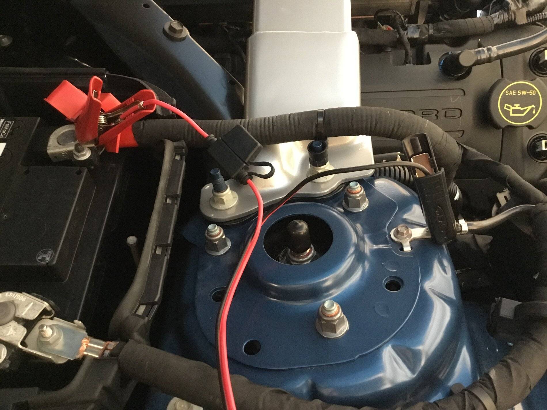

So as we know you cannot use the negative terminal .
On the shock tower there is a ground connection , can that be used or does the fact that the wiring harness is directly connected to it put in the same category as the negative terminal?
I have my CTEK installed this way as well.
