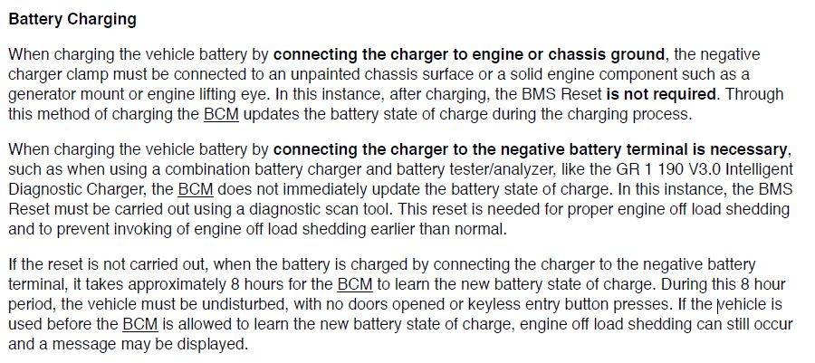

To add, when it comes to Ford's BMS reset, in addition to having the reset done via the scan tool, there is two other alternate ways:
1. @JAJ mentioned the 8 hr option, here is some text (last paragraph)
2. Perform Manual procedure without Scan Tool
