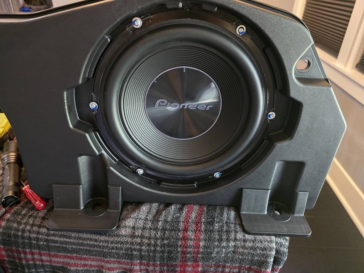

Thanks for the guide and all the input other folks have put in here. Did the mod today and at least for my type of music it make a huge difference when listening at like 20~22 volume. So glad I wont have to get a actual aftermarket sub box in there. I like having my mini cargo space free. Only broke one clip, here hoping that wont cause me issues on the long run? The ring vibrating at that spot? Should I just add some piece of foam to put pressure on it? Would that do anything to the detriment of the sound if I was to add a piece of foam around that plastic ring to keep it from vibrating since one of the clips broke? And I know the picture is wrong. I took it before I noticed that the ring goes on top of the speaker before the screws. Was rushing and skipped a step. Fixed it before I completed the mod.

Great outcome! Just use some 3M auto body trim tape.

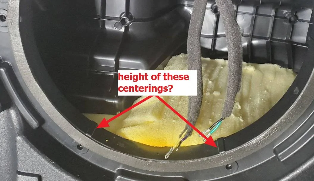

Does anyone know how thick or high these centering or screw reinforcement are?
I have an eye on a sub with 232 mm diameter and guess dremeling away these small protrusions wouldn't be a big deal:

Is there enough meat in there to use T nuts?

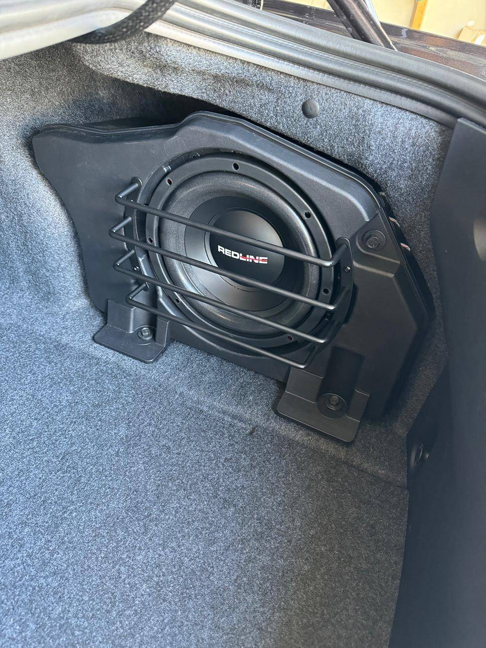

Also on 7g are users who installed the DD Audio Redline SW10 sub, which fitted without any modification except the 12 o'clock lug.
Has a much higher sensitivity and therefore more punch at a price of just $79.

The DD Audio Redline is available as dual 4 Ohms as well for those wanting tighter and stronger punch (don't install dual 2 Ohms).
