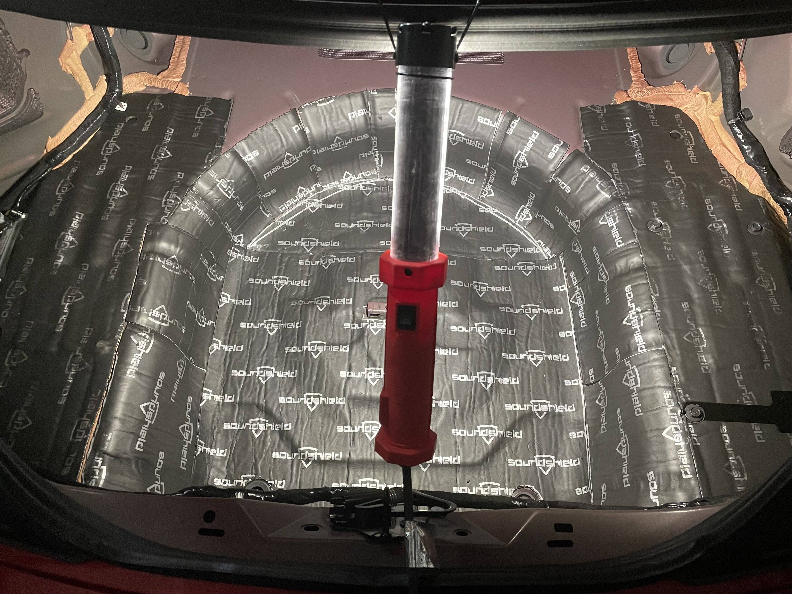

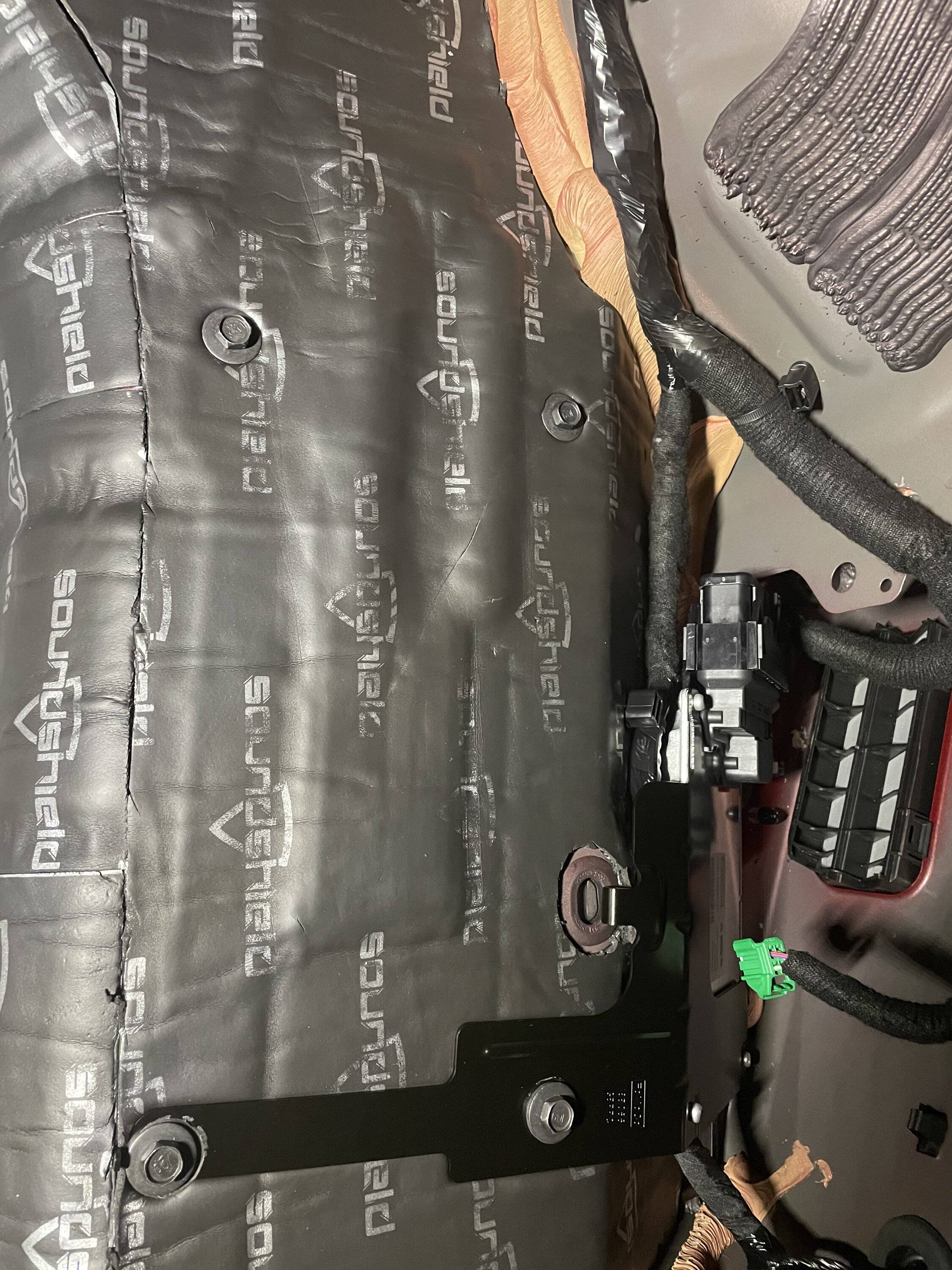

Would there be any value to cover the outside of the stock sub enclosure with sound deadening product? How about coating the inside of the quarter panel wall just outside of sub box. Not much that one can get to as far as access to apply the deadening sheet but...has anyone gone that far and stuck some on the sheet metal?

I’ve deadened the entire trunk. I didn’t get too many pics though.

No deadening on the quarter panel? Yeah, I know, not much to cover anyway.

As I stated I didn’t take pics of everything so what you see is not the final product. I have deadening everywhere there is flat surfaces.
