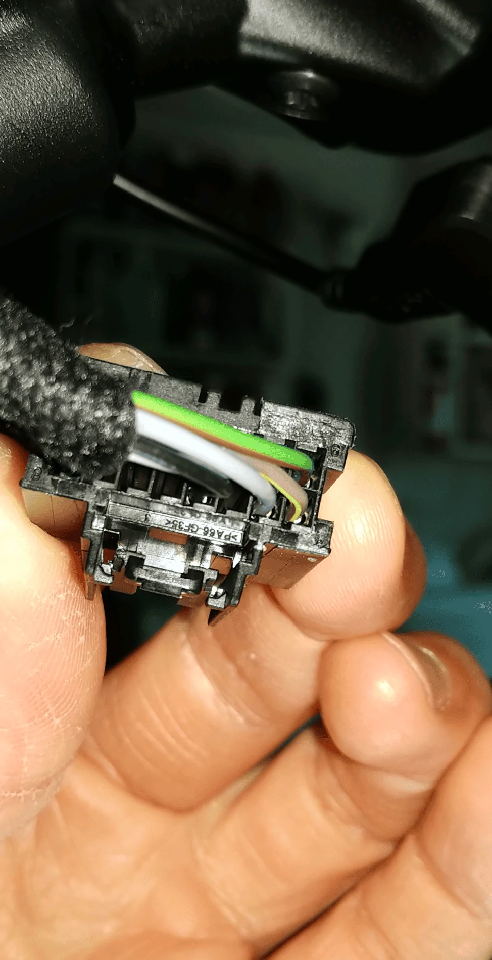

For the MirrorTap, use the second largest taps. They will fit. Others will be too small and the largest too big. Cannot recall the wire colors but positive is bottom right corner and negative the furthest left wire on the bottom. At least that is what it is in a 2018.
The mirror harness wires are brown (positive) and blue (negative)
on my '18 R, i am seeing:
top right: green wire
bottom right: brown wire
2nd from bottom right: baby blue wire
3rd from bottom right: empty
4th from bottom right: black wire
can either/both of you confirm which 2 wires to tap exactly?

18 should be the same. I don't really remmreme what exact color was mine as far as being brown or light brown but I do know it was brown and blue.
Try it and see if it works.
