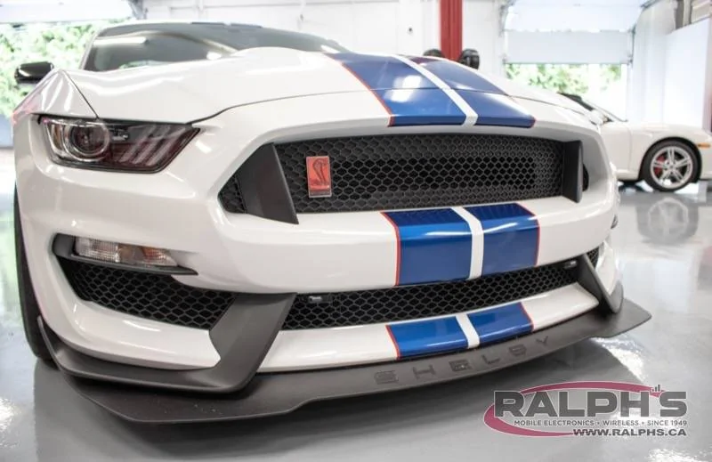

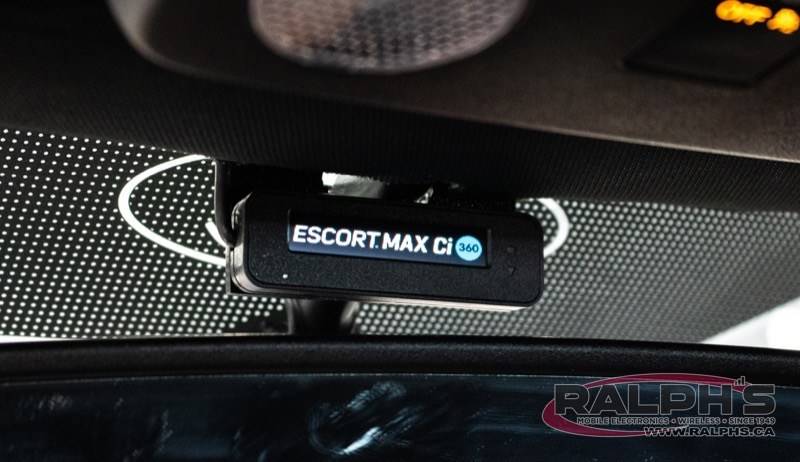

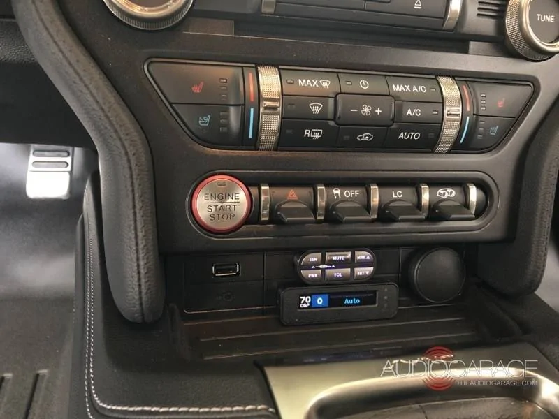

is anyone running a custom installed radar or laser jammer setups? AL Priority, Escort Max CI etc. I've been contemplating installing the jammers but am having a hard time wrapping my head around the ascetics of the jammer unit placement. Some installs look better than others lol.
For reference here's a couple of mediocre (at least on the exterior portion) installs. I question the placement of the optical units on these... they should be in the upper grill and ideally flush with the honey comb. Per the product specs and folks over at RDF, the placement is all wrong on these setups. But you get the general idea and the issue on this particular car... has anyone done this? Do these cars belong to someone here?

RDF will be your better bet for advise on jammer placement.
That being said you do not want the heads recessed and flush with the grille. You want them in the front with a clear view in front, nothing around the sides of them which would block them from an off-axis shot. You will want 3 front heads on our cars as well. Make sure to install the ALP controller somewhere easy to access so you can JTK when hit.

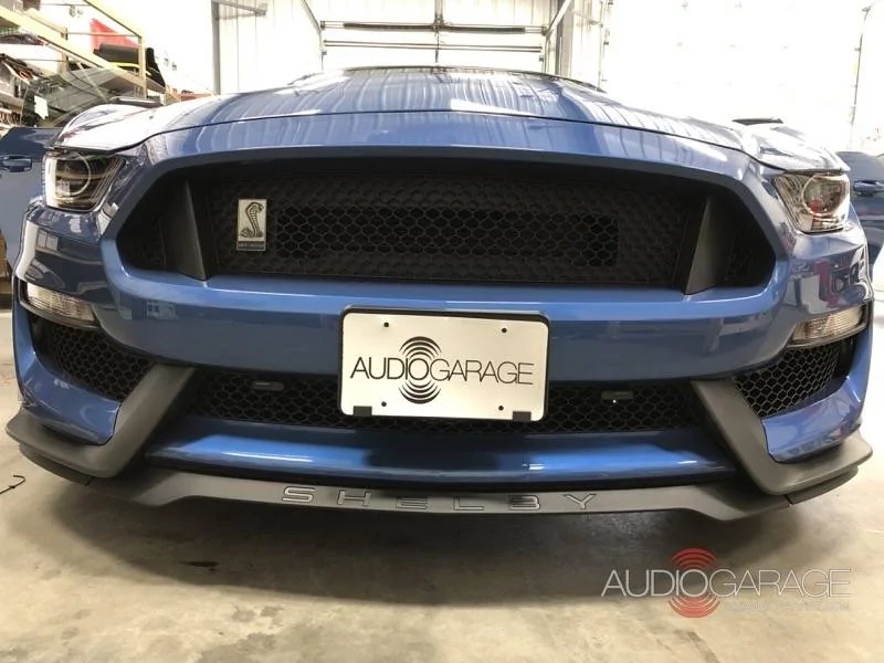

I have a GT so dont shoot me for posting here lol, but the car's arent that different jammer placement wise. Here's some pics of where I located mine which tested extremely well. You can also see my old 9500ci receiver placed below the middle head as well. Let me know if you have any questions I've done several jammer installs and have done testing with my own laser guns.
