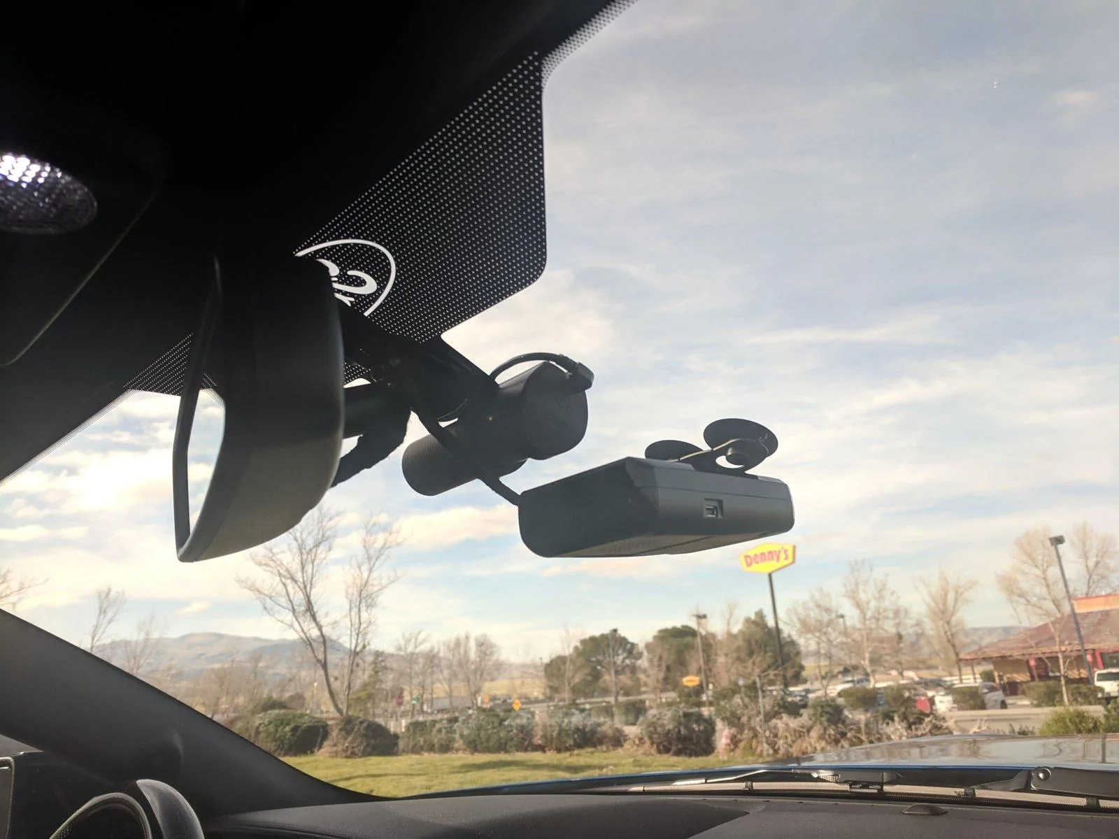

Uniden R3 is absolutely beast of the detectors. This thing will warn you over mile away Ka band. Doesn't go off constantly for K bands and has lots of features for options.
Best detector I have ever had.

Very nice.. Can you provide some insight on the on the installation? Does it literally plug in or is there some wiring involved to install like you have done?
Thanks!

I used the cigarette cable wire it came with. I cut the wires and tapped into my mirror power wires.
The cable has 4 small wires inside. You only need to use red (positive) and black (negative).
The mirror harness wires are brown (positive) and blue (negative).
I also ran s small 3amp fuse and tucked wires and fuse under the headliner.

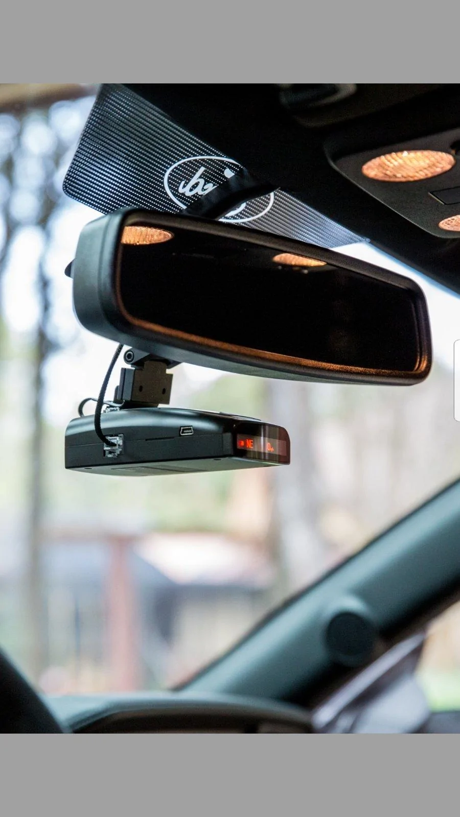

I have been using the radenso pro M. The thing is awesome. I have it mounted to my mirror with a blendmount

I know that mount looks very nice. But I just couldn't justify spending $100 buy is excellent quality and lots of great reviews
