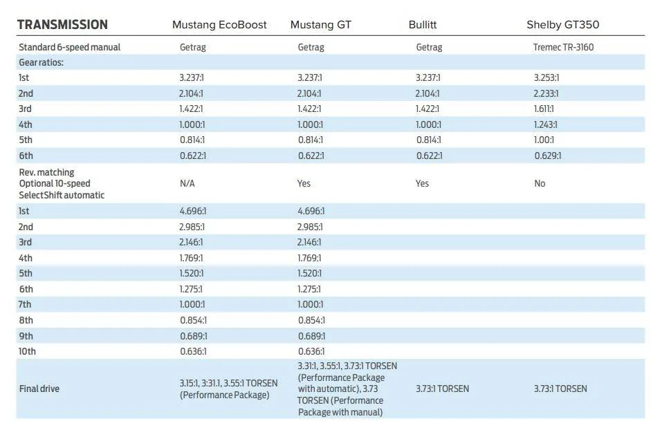

From what I'm seeing here, an automatic Mustang Ecoboost has more MAX wheel torque than a manual GT. Not even considering that the ecoboost is lighter, it has greater peak acceleration.
Max acceleration (aka max wheel torque) for a car happens at peak torque in first gear.
Automatic Ecoboost: 350 x 4.696 x 3.15 = 5177 ft*lbs of torque at the wheels.
That's engine torque times first gear times rear axle.
Manual GT: 420 x 3.237 x 3.73 = 5071 ft*lbs of torque at the wheels.
I didn't even account for torque multiplication from the torque converter in the ecoboost. Or that the ecoboost is lighter. And I gave the ecoboost standard gears while I gave the GT performance pack gears.
Now this begs the question. How come the manual GT has more traction issues in first gear than the automatic ecoboost?

Here's where I got the gear ratios from. Published by ford
