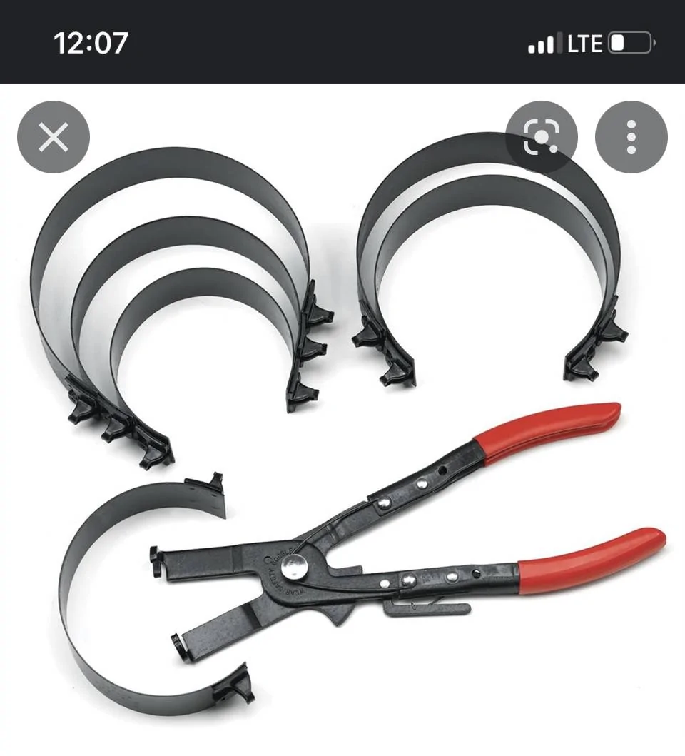

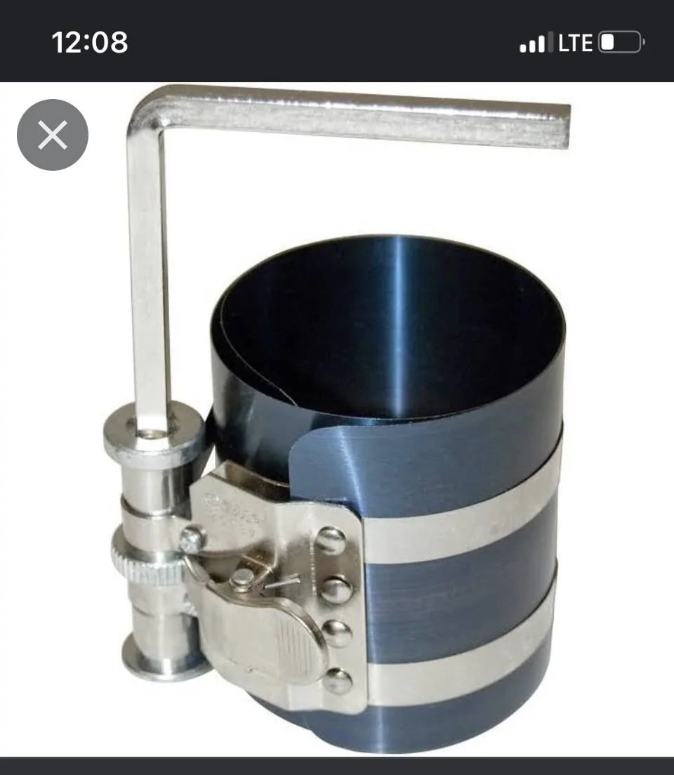

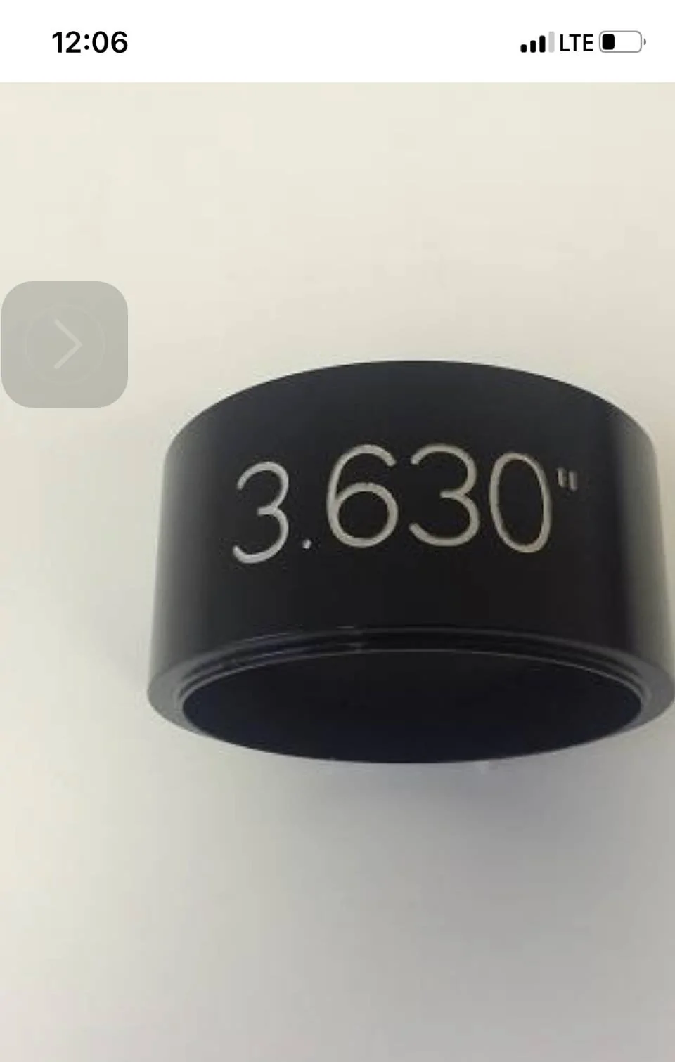

do you have a ring compressor for the bore not a autozone compressor?

you should us the first one maybe the second but as a beginner not the third
Like a ring compressor when putting the piston in?
I didn't know that it mattered if I use a cheap one or not.
