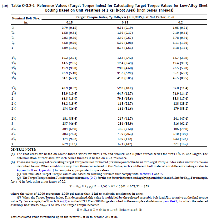

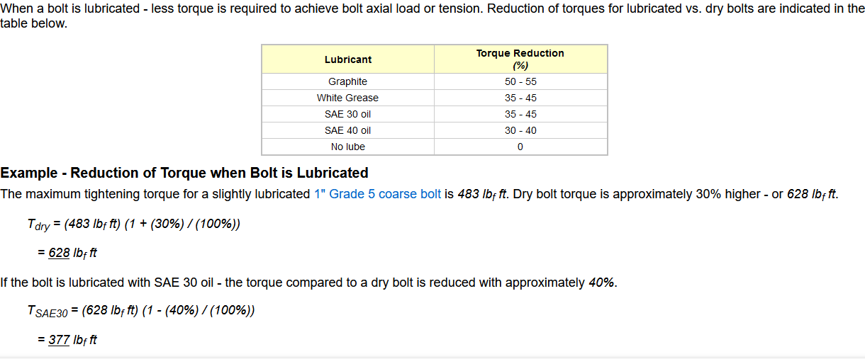

Here is one Chart I found: Dry stud torque to Assembly Lube Stud torque, the actual amount of Over Torque on the studs and wheels is quite excessive to say the least. Yikes!!yikes, that's not just wet, that's lubed. Unless you have a datasheet that says otherwise, take 20% off dry specs.
I have lots of bacon grease. I use it on my lathe and mill when cutting aluminum. I guess there are worse things wafting thru the air when the brakes get warm than the smell of fresh bacon...
Grease like this also calls for reducing from dry settings.
https://www.engineeringtoolbox.com/torque-lubrication-effects-d_1693.html
