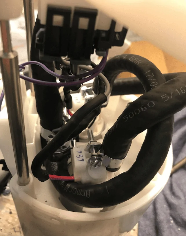

If you run out of fuel on the GT350 kit(Sai or mine) you "could" get dual BAPs which required you to spend another $550 or you can simply upgrade the pumps. I walked a customer of mine through upgrading to dual walbro 450's and now he has all the fuel he needs for only $220 more. upgrading to a 8AN feed will help a ton too, but even on the stock 3/8th line this was enough to supply enough fuel for a 69mm pulley on e85 with 5% overdrive and his wet nitrous shot...

Not gonna lie, having t-bolt clamps or even worm camps on anything going in my fuel tank would scare the $hit out of me. At the point of needing 465’s I would just go fore.
See here I am again debating with myself on going fore or not...shit...
This customer already had a Sai kit and needed a bit more out of his system to feed his nitrous as well. It was much cheaper to upgrade the pumps to walbro 450's than it would of been to buy a whole new fuel system. and I believe the clamps were part of the install kit from Walbro, don't recall...
Do it.....

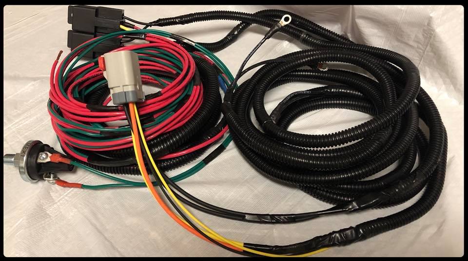

Well so far I can say this the lethal harness is not made to plug into a gt350 pump.It can made to work because they are both 6 pins,Problem I had today was everything was finished pumps ran and primed like they should but not fuel pressure,nada!!!.I think because the lethal harness was made for a gt500 pump the wires are in a different location and may be running the pumps in reverse polarity,if not the new pumps just don't work.Will figure out some more later tomorrow lol.
Glad I went with making my own harnesses on my kits, I almost relied on theirs but making it myself allowed me to make sure it was wired right, add options like a hobbs switch, and also make the over all kit cheaper

Nah it's nothing wrong with their harness,they just have the wires setup for the gt500 pumps and i used the gt350 pumps.My problem is I need to stop listening to all the internet experts saying the 350 and 500 pump setups were exactly the same lol.I think my friend Ken talked to u and if what u told him about the black wires being hot is true we found our problem,polarity is switched.

Nah brother brother give me a few hours today,i.stopped yesterday because I was cold as shit and tired.I looked over the wires and the harness lethal sells was made to.work with the gt500 pumps,same amount of pins and order as the gt350 pump but the 2 power wires and ground wires need to.be switched,all the rest of the harness is perfect.Im going to.switch them today and I bet the pumps work fine.Everything else we used worked perfect.
There is nothing wrong with having the lines clamped. Cars came from the factory this way for years. The fore system is really expensive after you start adding options. The hat alone is 800 with three pumps.

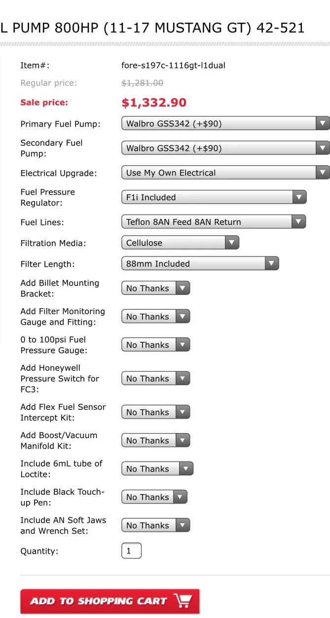

So I understand Fore’s kit is upgradeable, but everything adds up fast. It’s 1100+ without pumps, jumps to almost 1350 with pumps. That’s supposed to be the 800whp setup. Now I wonder from the long list of options what is and what isn’t a necessity to reach the 800-850whp mark? I just want a true dollar cost from the fore setup.
Same here, Want to know what’s needed. Want something for 850-950rwhp
