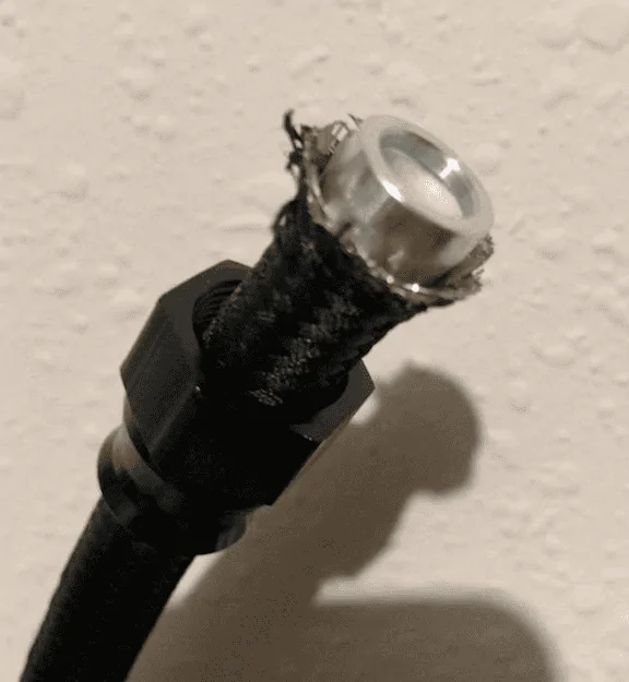

I highly recommend PTFE hoses when building a system for e85, you want actual PTFE hose not PTFE lined or anything like that. When using e85 on CPE/Nitrile/lined hose you will eventually run into the hose cracking and leaking like swiss cheese. This is more likely to happen on the parts located in the engine ebay since the heat cooking them from the outside and the e85 eating them away from the inside will lead to failure much quicker.
PTFE hoses are perfect for e85 and will not be eaten up over time. they have a high tolerance for heat, and are rated for pressures no port injection system is going to reach. All of my kits come standard with PTFE hoses for this reason
