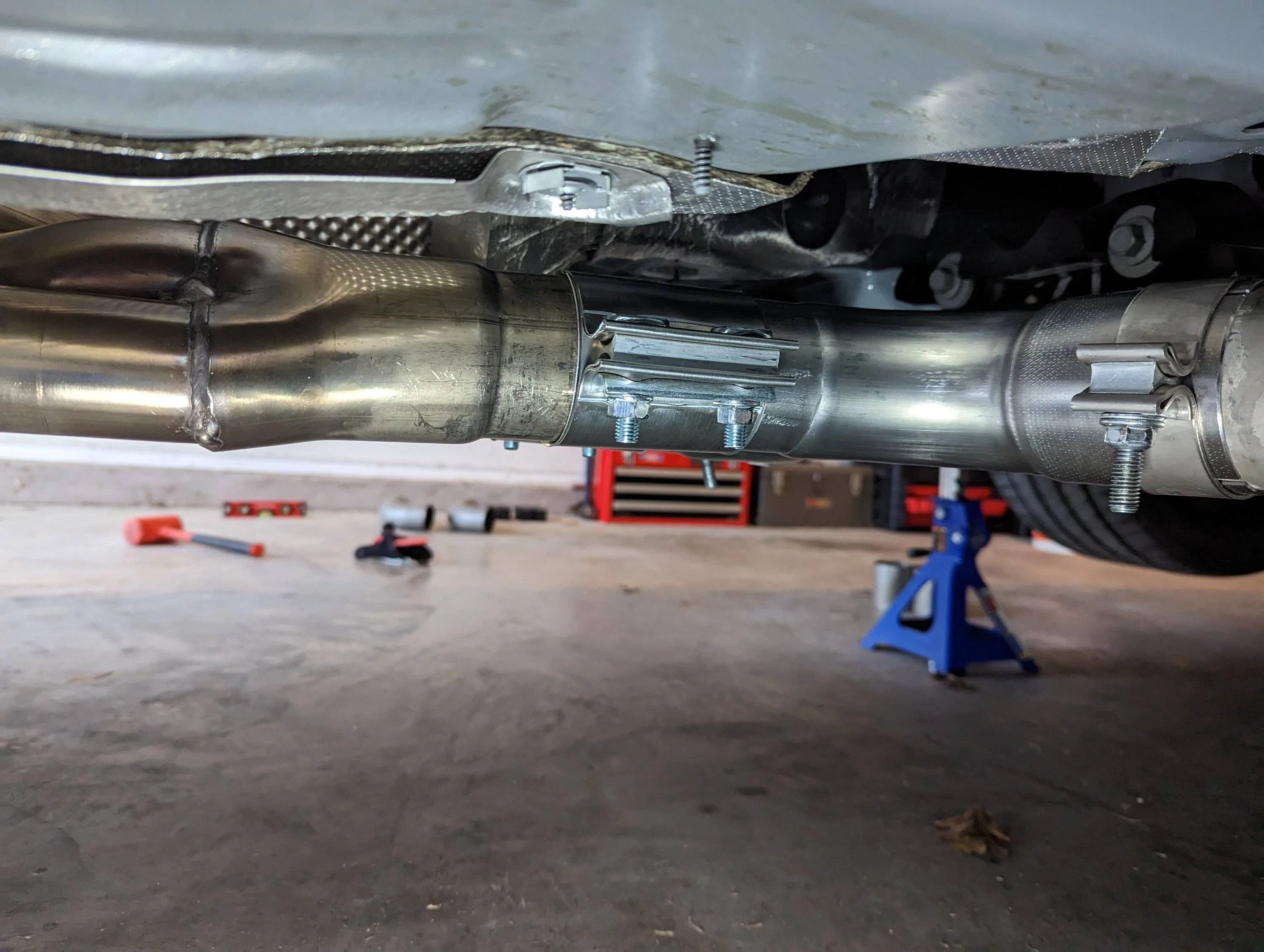

My Kook's 2-3/4" barrel clamps just showed up so I'm fixing this exhaust leak once and for all. I spent way too much damn time on this when I wish I would have just started with the 2-3/4" connect pipes from the GT500 from Kook's and these clamps. I also wish Borla would stop calling the ATAK a 3" system when it's clearly 2.75" on the inlet pipes to the Switchfire. 100% the reason why the stock GT500 clamps are re-used in the installation instructions.

Leak is gone. Perfect fit.
