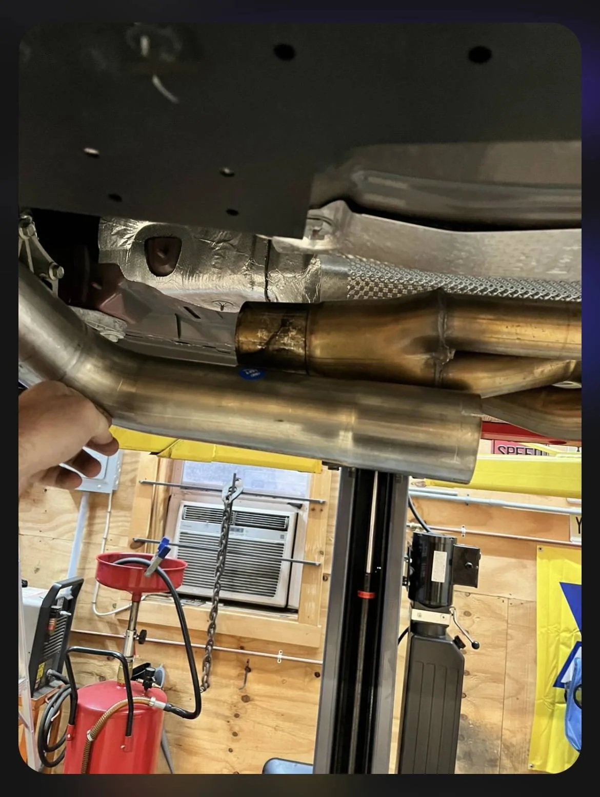

So I will need to cut the 3" Kook's connect pipes back some then I'm going to use some of these to connect the two pipes:
https://www.amazon.com/gp/product/B01HQSWYOS/ref=ppx_yo_dt_b_asin_title_o00_s00?ie=UTF8&psc=1
Do not try to force the Kook's pipes over the Switchfire ends or you will end up with an exhaust leak like me. Do it the right way the first time. There's a reason the GT500 installation instructions re-use the OEM clamps on the front.
The guy installing my headers just told me that the stainless power aftermarket connection pipes aren’t fitting the borla switchfire. He’s not able to do the modifications necessary, so I’ll need to take them to an actual exhaust shop. Hopefully they can expand them and get it be a slip fit connection with some 3” clamps

I'm about to sawzall my connect pipes soon. I have to cut about 2.7 inches off so the couplers will hold the pipes together with no exhaust leak.
I just looked up those pipes. Similar to how mine are but Kook's has a small section that bends.
You have two options: Cut 3" pipes back and use couplers or have a shop cut and weld it to the Switchfire which I wouldn't recommend because talking off the system would be a pain otherwise.

Are those the pipes that came with them or are they different? The ones that usually come with the headers neck down so those OEM clamps work with the stock catback.
He sent me this picture. This is how the lead pipes are lining up with the switchfire. The aftermarket connection style has a longer than normal lead pipe to allow trimming, so that it can fit multiple systems
Yeah, cut and use 3" coupler clamps. Kook's instructions say to trim the pipes as they are long on purpose.
If they can cut the extra, expand the last 4” of the pipe, make it slip over properly, and tighten with the clamps it came with that would be perfect
