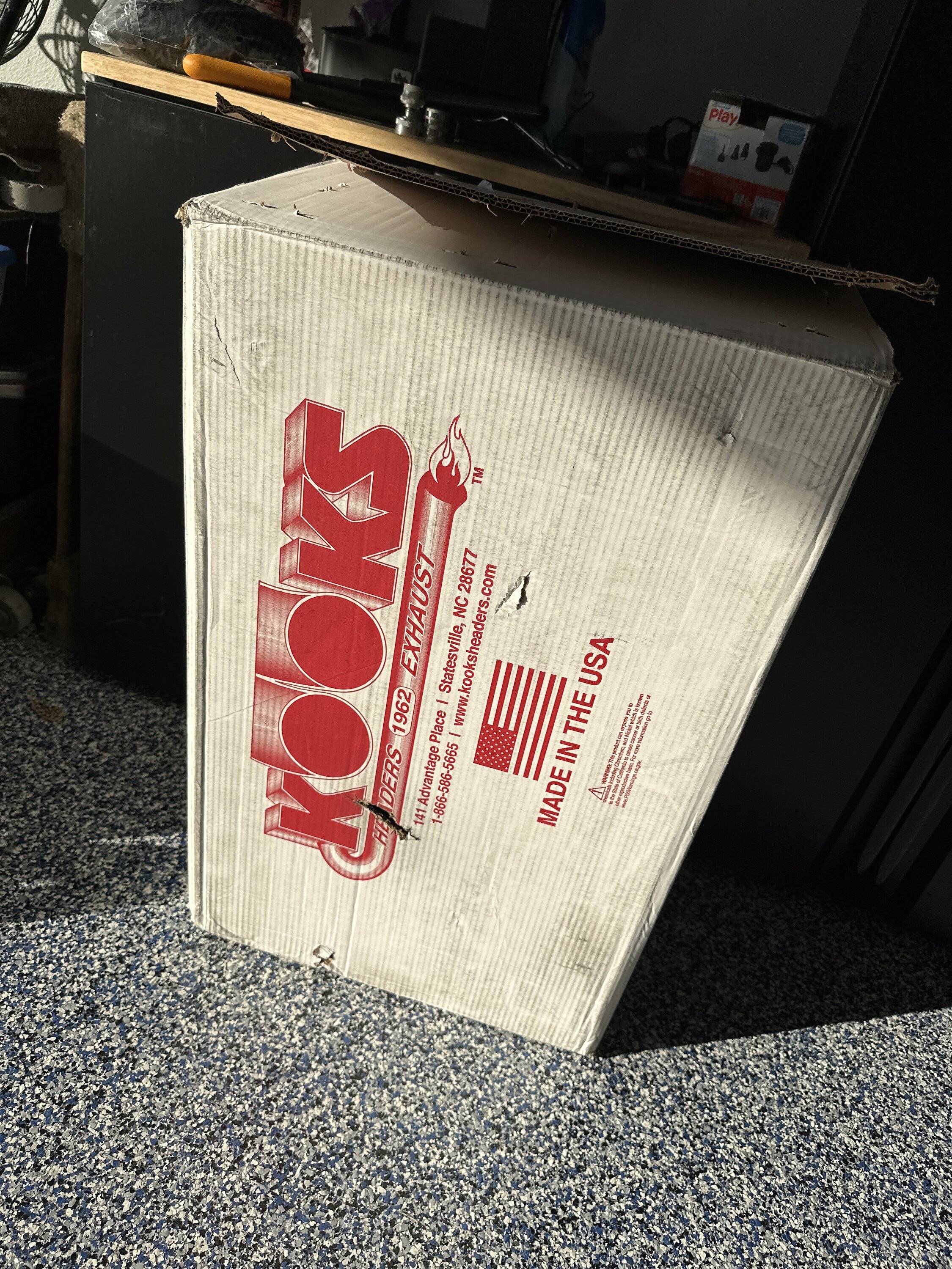

@Zelek should I get my headers coated before I get them installed? @beefcake the headers came in today!! Thanks for everything!

Coating is nice, but beware it’s also delicate. It’s almost a guarantee that you will chip off or scratch the coating in spots during install, unless you thoroughly tape them up with bubble wrap when hanging them. I know it sounds silly, but I had a motorcycle header JetHot coated years ago and these were the issues I encountered. One thing I liked about JetHot was, they did offer a one time re-coat at no charge, if it was done within the first 3 years. They also coated the inside of the header too which I really liked.

Totally up to you if you want to coat them. I always have because it definitely reduces the temps and keeps the heat inside.
