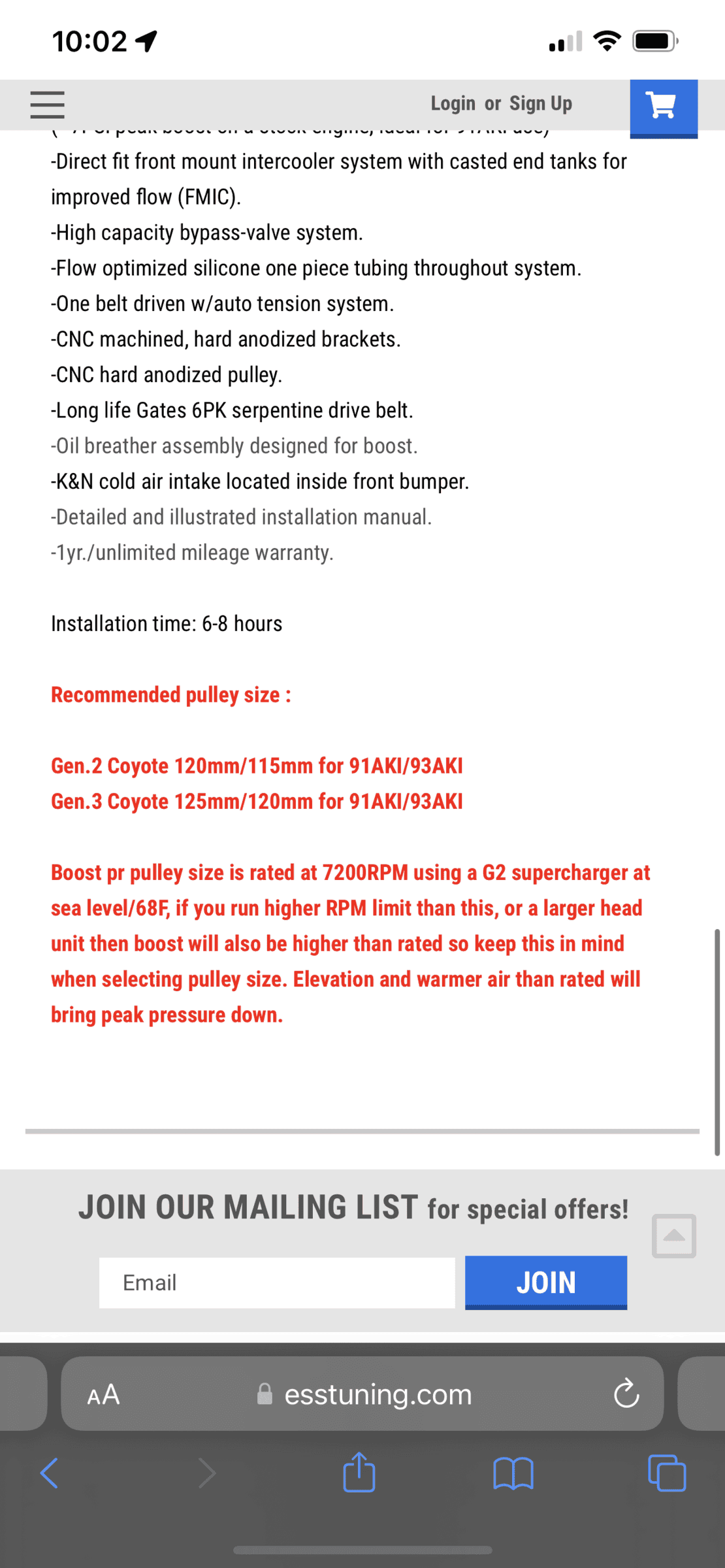

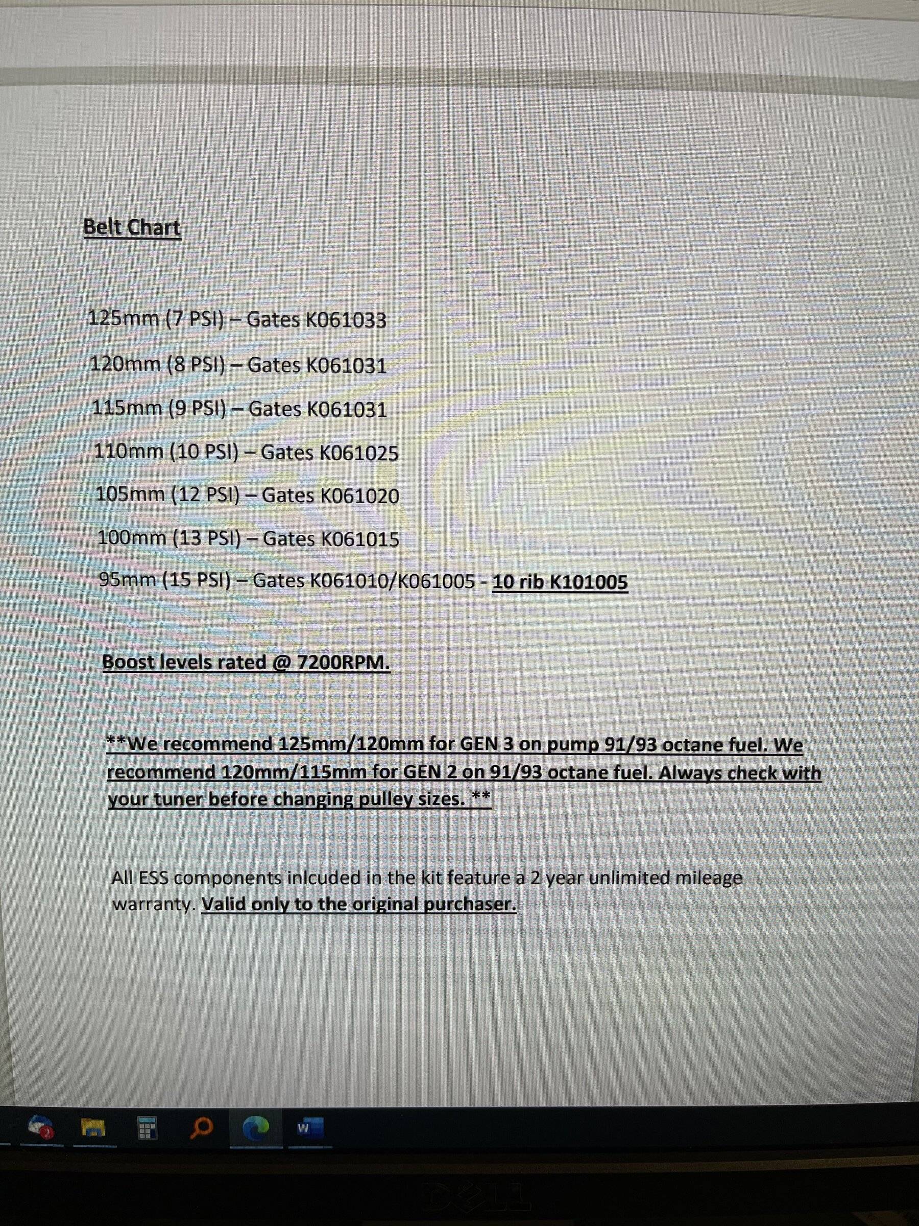

This is mostly incorrect. We rate the pulleys at 7200rpm across the board. That rating applies to Gen 2 and Gen 3 cars because they are the same kit. Also for G2 and G3 kits which utilize a different sized supercharger. There are so many variables at play when measuring boost. Different altitudes, weather, year of car and other modifications all play a huge factor in how much boost you will end up making. For example, a G2 car with headers and GT350 manifold will likely see less boost because of less restriction and a smaller supercharger. There is no one size fits all for measuring boost with each individual pulley. See Kevin’s car above, a G2 with the 105mm pulley making just over 10psi. Another member has this same setup with the G3 and makes over 14 psi. We give a baseline to go off of as well as pulley recommendations for pump gas that are clearly listed in the installation manual and on the website. We have done extensive testing and R&D on our own shop cars and know the limits on pump gas. If the recommendations we supply are followed there will be no issues.
Ok so you got me by 200 rpm. You rate rpm far lower then a stock coyote revs to, which was my point. And a very well known tuner at Lund had mentioned this is a cause for concern being that nobody revs the coyote to 7200 rpm. What happens when you spin to 7800 or 8k? That 9 psi becomes 12
Revving past the stock redline on a 2018+ is a drivers choice and a tuners choice. If they rated their pulleys at 8k everyone would complain about low boost.
I have completely stock exhaust on the G3 with a 110 (9.5psi) pulley. I spun the car to 7849 in the log and the air load showed 10.43 psi of boost at peak. I think there are a lot of variables and if you cant make a good safe choice based on some research and tuner suggestions then buy the largest pulley and work your way down. They are $150 for a pulley.
The factory redline on a gen 2 auto car is 7,000 and 7500 on a gen 3 (auto). 7200 is splitting the difference between the two. Remember this kit is for both generations of mustang? What happens then if we rate the pulleys to 7800 and someone with a mild Gen 2 setup installs a kit with a 7psi pulley and a 7200 redline? He will see 2-3 psi less than what he believes the kit is advertised for. He will then start looking for a boost leak and believing that the kit is not making the advertised power. There must be a baseline set. We chose 7200 and clearly advertise this on the website and the install manual. If the end user does not follow these recommendations it is on them. There are too many variables and different combinations to have a one size fits all pulley chart. Also If you listen to that video carefully he clarifies that the end user is responsible for following the manufactures pulley ratings. See the website and manual below.
It should be rated at redline. Anything different doesn't make sense.
Read my above posts. We rate it between the redline of the Gen 2 and Gen 3 cars. So that means it’s actually rated above redline on the Gen 2. Remember these kits are designed for BOTH generations. There has to be a middle ground baseline. It’s a fairly simple concept. Redline will vary depending on setup. So will boost as has been discussed.
The way you've rated the kit is fine in my opinion. Honestly, this seems like a straw man you're arguing against.
This thread below is talking about the Procharger HO kit making 5.28 instead of 6.5 and there are no pitchforks from the crowd. The consensus is put a smaller pulley on and hold on.
https://www.mustang6g.com/forums/th...procharger-ho-stage-1-low-boost-issue.127093/
You've given a reasonable reference boost pressure to RPM and recommended pulley size which has been demonstrated to be safe in the ESS thread.
