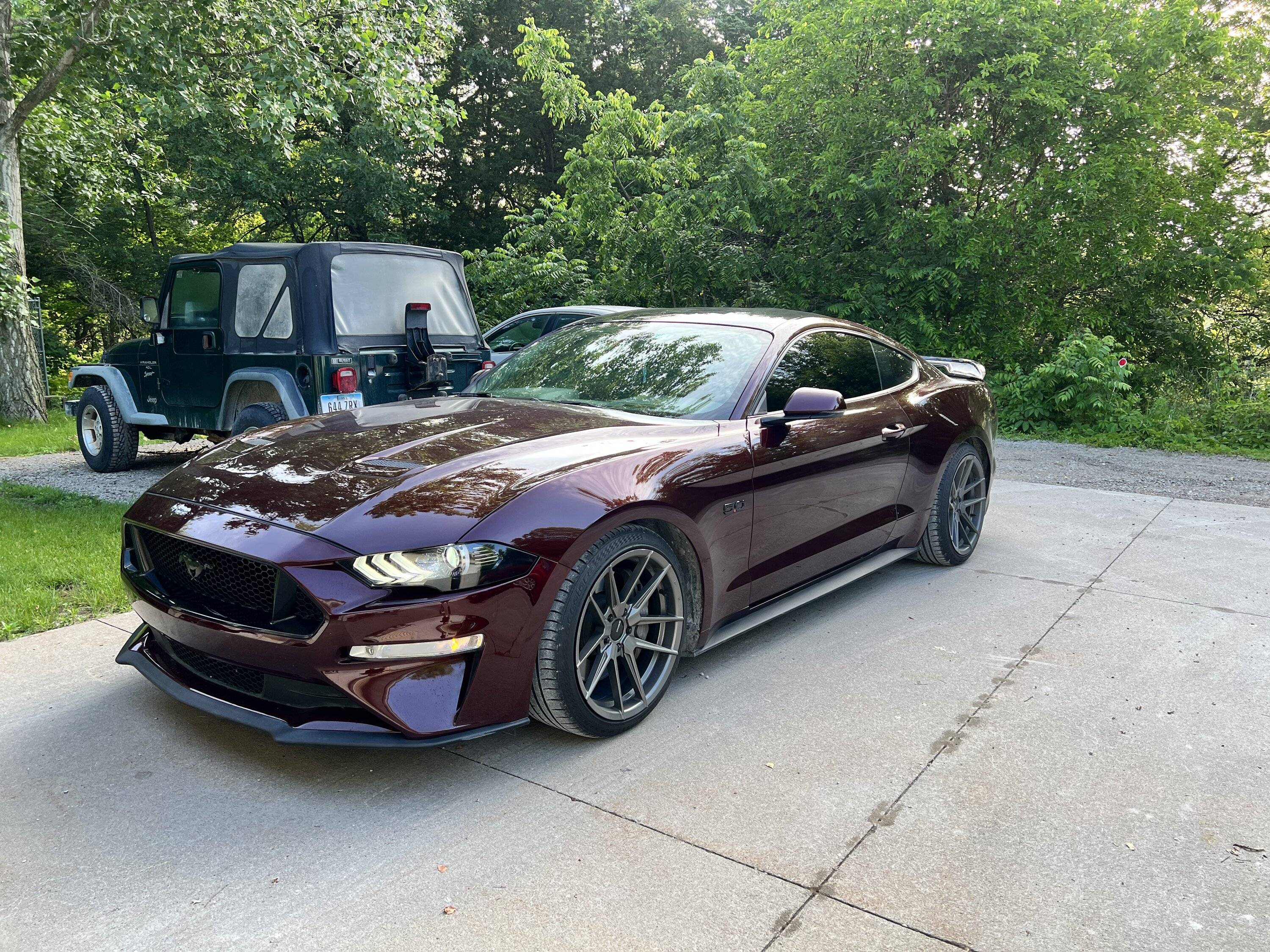

My car was built and dynoed at HPJ yesterday. Mods are G3X head unit, Fic 1440 injectors, fore triple pump fuel system, and a free flowing exhaust. The car is tuned by Lund.
On the 120mm pulley the cat made 680 on 93 octane and 760 on e85. On the smaller 100mm pulley the car made 858 hp 621 tq on e85. I do not know boost pressures but I suspect 10 psi and 14 psi respectively. I’m happy with these numbers through a a10 and I’m excited to take it to the track.
