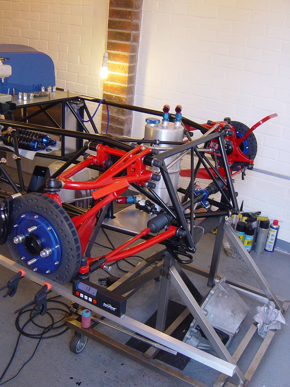

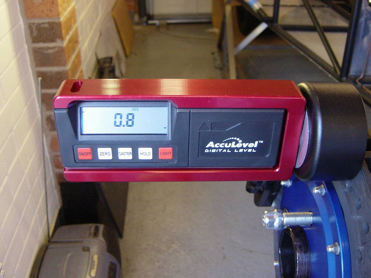

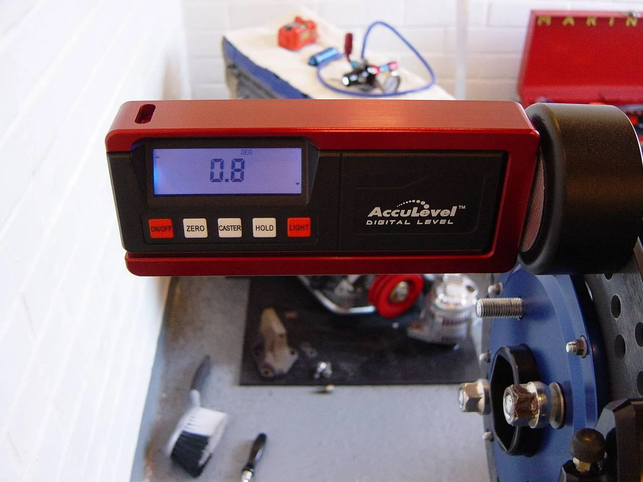

I set up toe and camber with some basic tools in my garage and I am confident enough not to feel the need to get it rechecked when the car is (finally) finished.
I appreciate its not practical / suitable for normal cars, but I did the following :
Fixed the ride height.
Set toe to zero allowing for my garage floor slope and ideal rake (ally box section, tape measure, camber gauge).
Set the the wheels straight ahead relative to the back axle (laser).
Set the camber on each side - the suspension uses shims which I later replaced with a stainless spacers (camber gauge).
Set the toe.
I have since made a tool to hold the camber gauge so I can recheck camber quickly on the car (wheels on).
I'm pretty sure for my requirement with that particular car, I would struggle to find anyone who could offer an improvement over the settings that I have made.
(For me) I'm not sure if it's a practical proposition on the mustang, but given the time / space / tools it would certainly be a fun experience trying ... :like:
