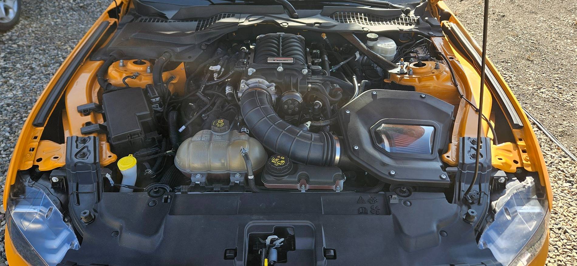

I own a 2018 Mustang GT Premium, PP1, Magne-Ride, 10 speed automatic, Active exhaust with Borla S-Type cat-back exhaust with Roush TVS R-2650 Phase 1 supercharger dealer installed kit with 18, 500 miles. I don't track the car, it is strictly a street machine. What fun it is to do a rolling 40-120 mph blast.
I have replaced the passenger side catalytic convertor (caused by boost and WOT pulls). This is the price to be paid to own a super hot street machine. I am 69 years old and the thrill of acceleration this Mustang offers is ageless! I have not been sorry one bit for purchasing this performance automobile!
Nice color! Is it still on Roush tune? Their tunes tend to take all 9 lives from cats.

The Mustang GT still retains the Roush upgraded kit tune. My son has data-logged the drive data with HP Tuners. No changes made. The current tune runs rich at WOT, so we have added approximately a 20% blend of ethanol to 91 octane gas (highest octane available at the pump in North Dakota). The WOT long term trims now sit around 11.0-11.4 with that 20% ethanol mixture. Runs great! We will see if it extends catalytic convertor life?
