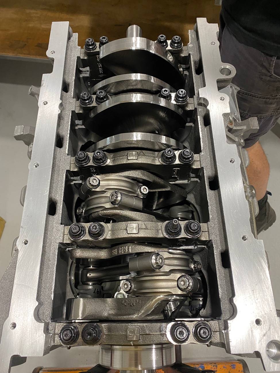

i had a similar thought process to you. I’ve never build a coyote , but the best option for me was to re-build me gen2. (as I’m in Australia). Import duty and shipping makes it crazy $$$
I just got the bottom end sleeved and built and I did everything else.
after a million hrs of research. Contacting piston companies etc. I ended up with M142p pistons , Callie’s rods , darton sleeves. stock bore and stroke sizes so I have the ability to re-build again in the future if needed. ( hope not for a while haha).
also this rod and piston combo allowed me to still keep factory oil squirters. Yes there is debate to have them or not. But the way I look at it is nascar , Ferrari , lambo , heaps of races cars and the list goes on all use squirters. So I liked the idea of keeping them.
As it is street car I liked the idea of a piston that heated up quickly , didn’t expand much , and has tight OEM type tolerances and gives similar strength and resistance to knock as a 2618 or 4032.
kind Of gives you the best of both worlds.

Thanks for your perspective Tim, the M142P pistons do seem like a great option. I just wish they were available in the Gen 3 bore size off the shelf, I'd rather avoid going custom.
I can't see reusing my Gen 2 block making much sense in my case, the new blocks here are just too cheap to fool with machine work, and I don't plan to make enough power where the sleeves are necessary.
The piston oil squirters are one of those things that opinions seem to be pretty mixed on. I can see pros and cons, but overall I think Ford put them there (sometimes) for a reason.
How many miles do you have on your build? Any indication how it's holding up? I'd love to put together something could handle 50k+ miles before needing refreshing, I figure your setup should do that and then some.

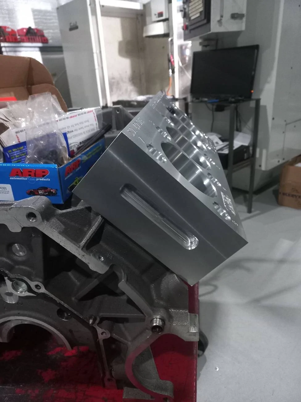

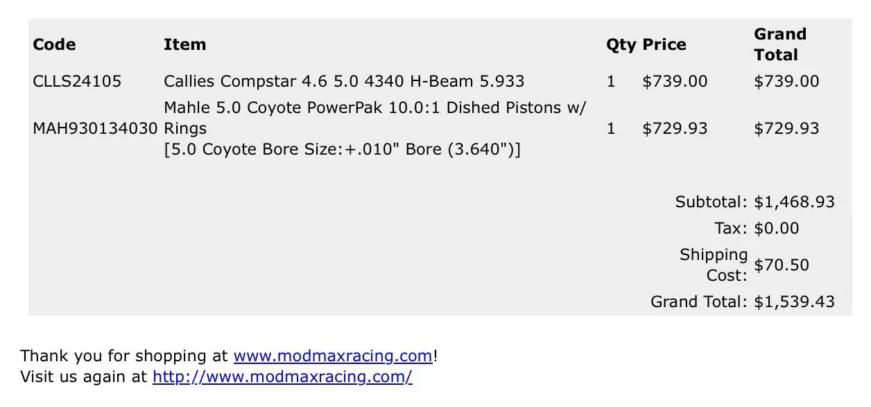

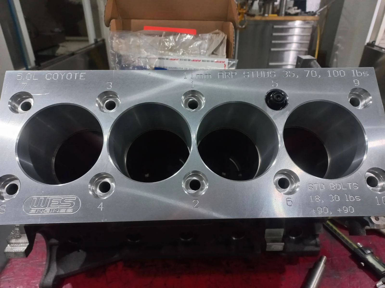

What piston size did you go with? Do you have a part number for those?
As I was sleeving the engine. I went 10 over ,so we had some wiggle room for the machinist to get everything perfect and true. also I got him to make a custom torque plate to bolt up with ARP studs just to make sure the block was held true while honing.
