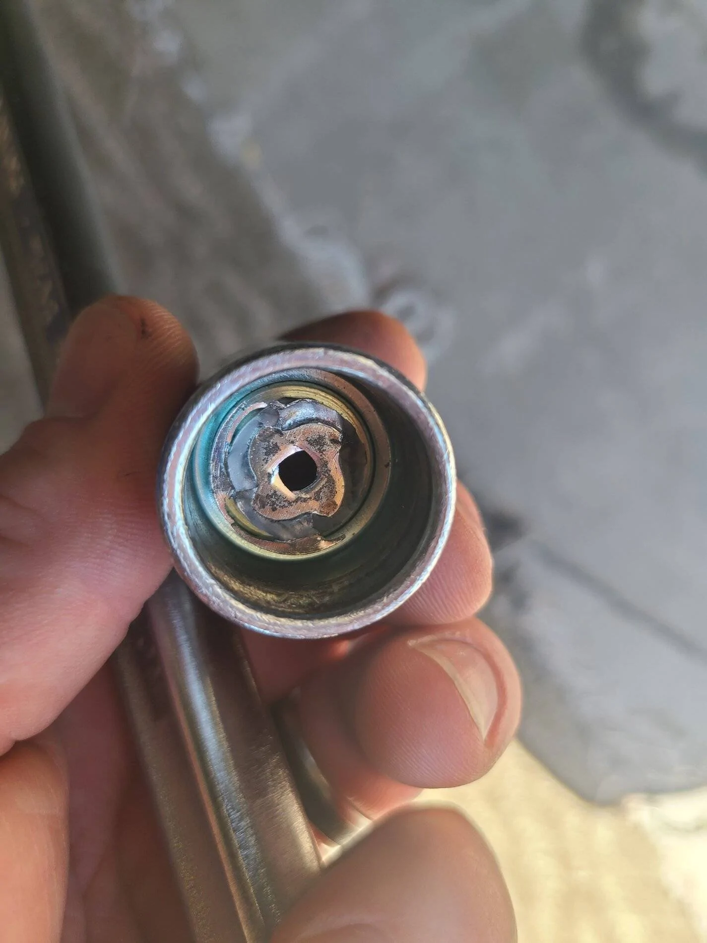

Went to rotate my tires yesterday and my mcgard key broke off on the first wheel. Waiting on a replacement before I can rotate. I went ahead and ordered all new lug nuts. My stock ones are definitely bulging. Can't fit a 21mm on them anymore. I have to use a 22mm. I thought I was crazy when the 21 didn't fit. I was sure I used a 21mm in the past. Then I saw a few of these threads pop up and realized I have a problem.
Don't use an impact tool on the locking lug nuts and tool, and this should not happen.
Also make sure the socket and tool is straight on the nut, not angled from leverage of a long breaker bar.
I never use impact guns on my lugs. I use a standard size 1/2" socket to break them free.

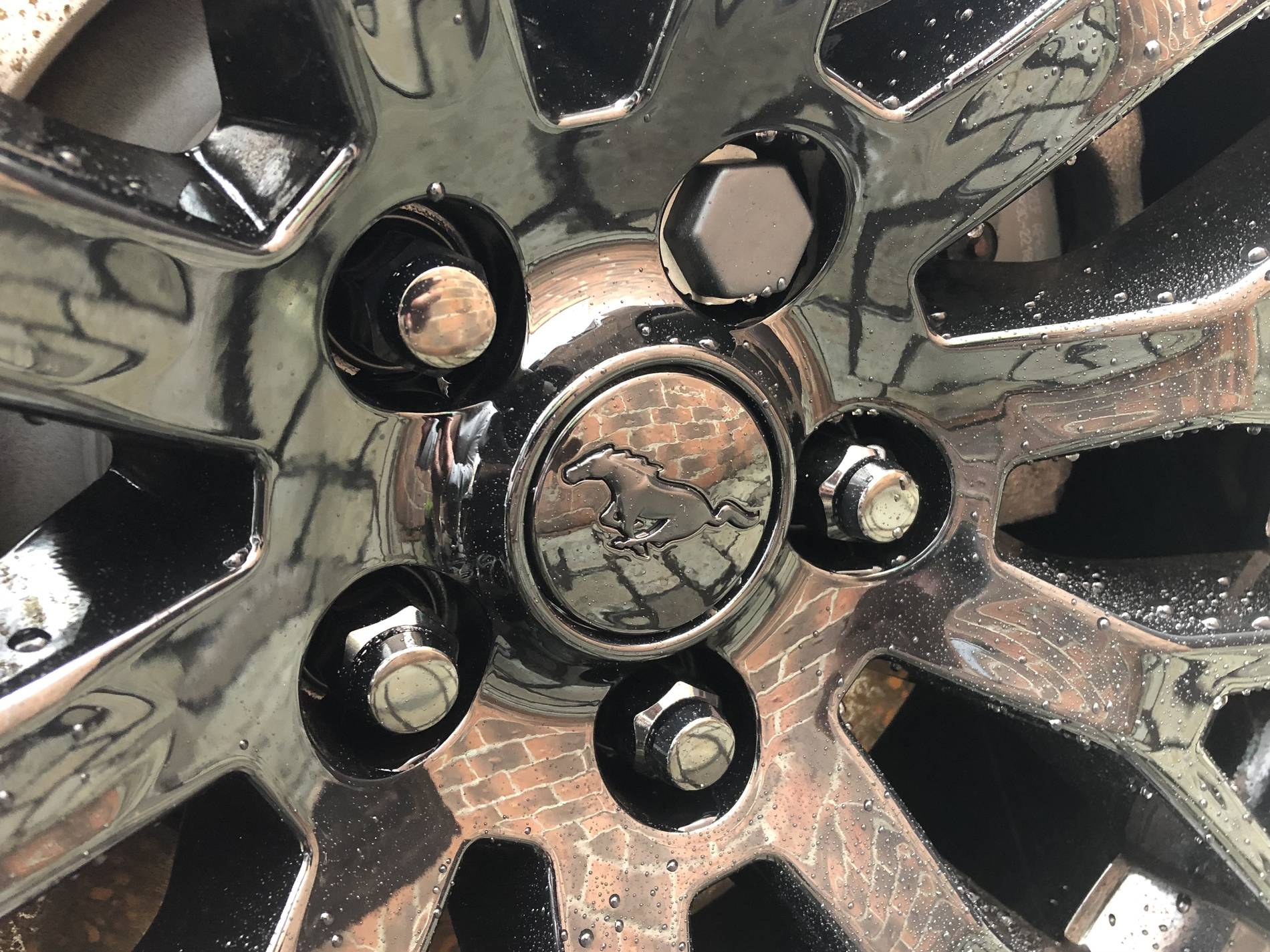

Didn't wait for disaster here, replaced the chrome-ish 2-piece parts with Gorilla lugnuts:
https://www.cjponyparts.com/gorilla...style-bulge-black-chrome-2015-2021/p/WHLLN20/
I really like the black chrome look over the regular stainless steel ones anyway. I haven't received my car yet, but I learned from this forum about those lugs nuts, or I would have never known. That is going to be one of the first things I do when I get my car. Dealer told me within 2 weeks! Yeah! Thanks for the info and pic.
That's the trouble with this forum... imagine my surprise when I looked at my otherwise blacked-out car and all of a sudden after reading one of those "what did you do to your Mustang today" threads I realized I had chrome lugnuts. No longer!
