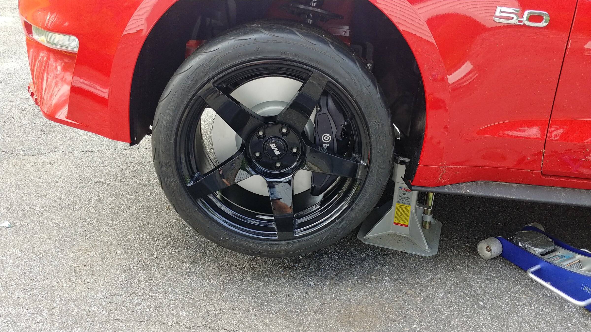

They don't, but a few companies make a bracket kit which is ALOT cheaper than buying the overpriced kit from FP. Here is my cost breakdown:
Calipers: $500 (from a dealer)
Pads: $70 (Powerstop Z26)
Rotors: $125 (15" steel)
Adapters: $200 (from LMR)
Studs: $150 (optional from Caliperfexion)
