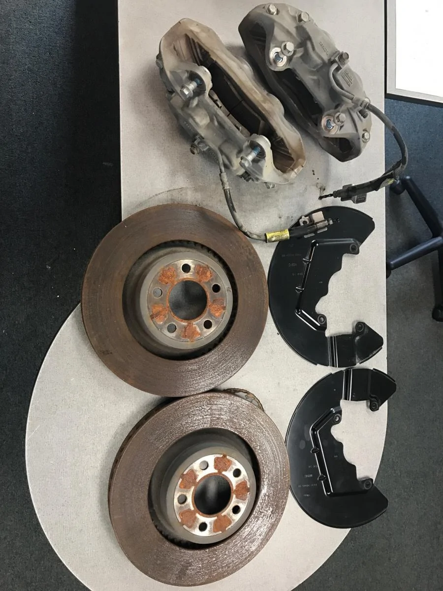

I bought a set of front GT brakes from another member here and installed them on my Ecoboost no problem. The brake lines were included with the calipers and it was a direct bolt-on swap.
I'm also interested in swapping the backs with GT brakes but haven't found a rear set for sale yet.

Ebay has them from Shelby, I got mine there. Usually they auction two per week.
I paid just under 300 plus shipping came out to 320 ish I think. I also put in Steeda Stainless brake lines as it was suggested by our track instructor. Maybe the same strength but less likely to get cut.
PS Shelby auctions go for the first set because whoever loses, on the second set will bid them up...I paid about 60 bucks less than the second person.
