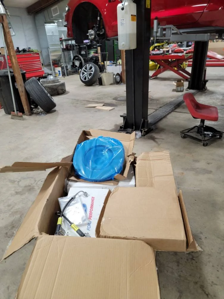

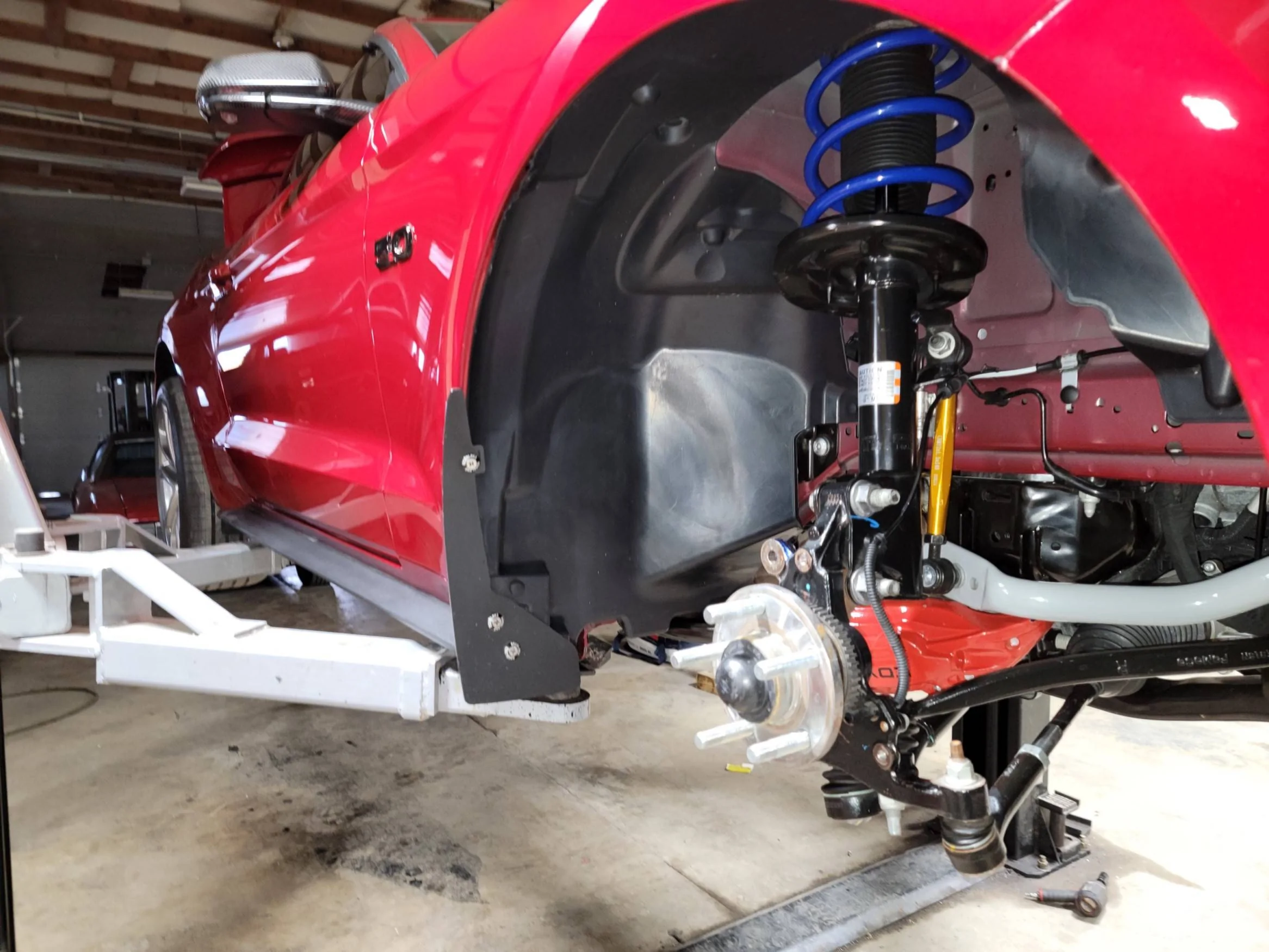

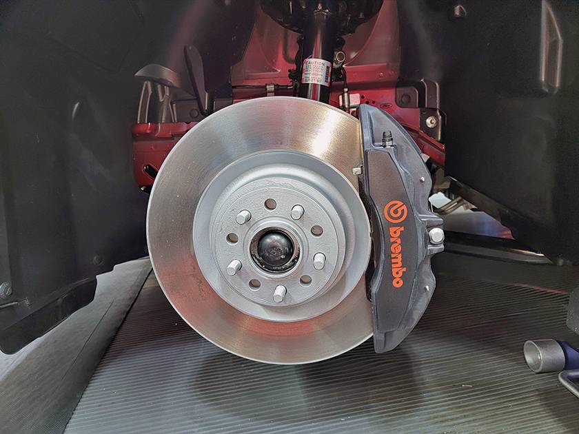

I started this on Monday and will post the final photos tomorrow. I had help with the brake bleed and that was a massive time saver. My advice is carefully pay attention to the instructions. The kit came with everything except brake fluid, but I had plenty DOT 4 on-hand for this project. Here are a few pics as I prepared for the upgrade:
