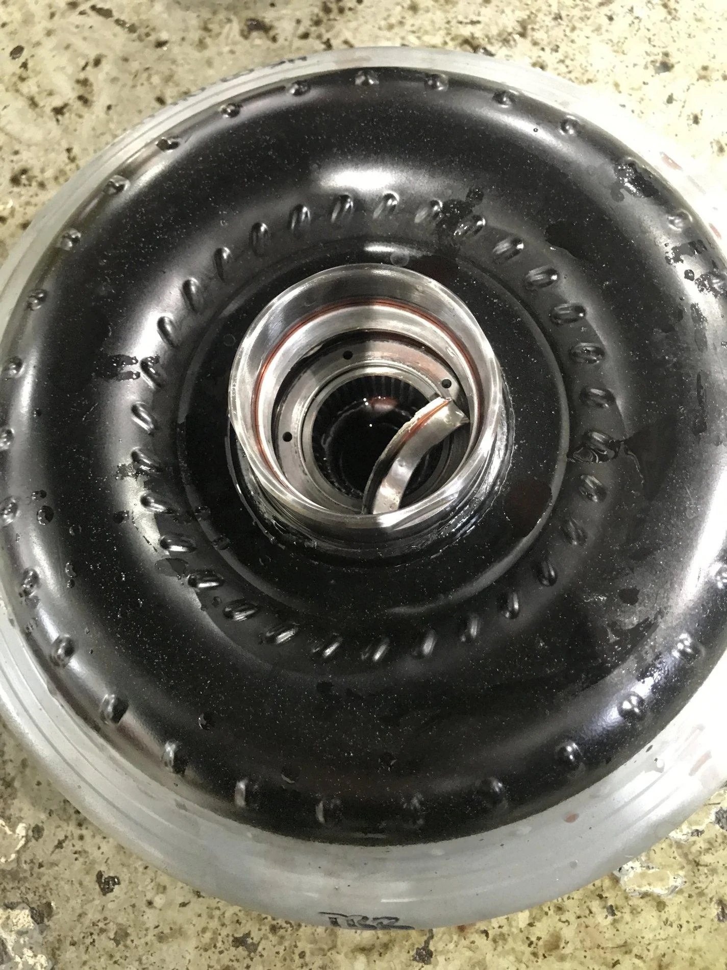

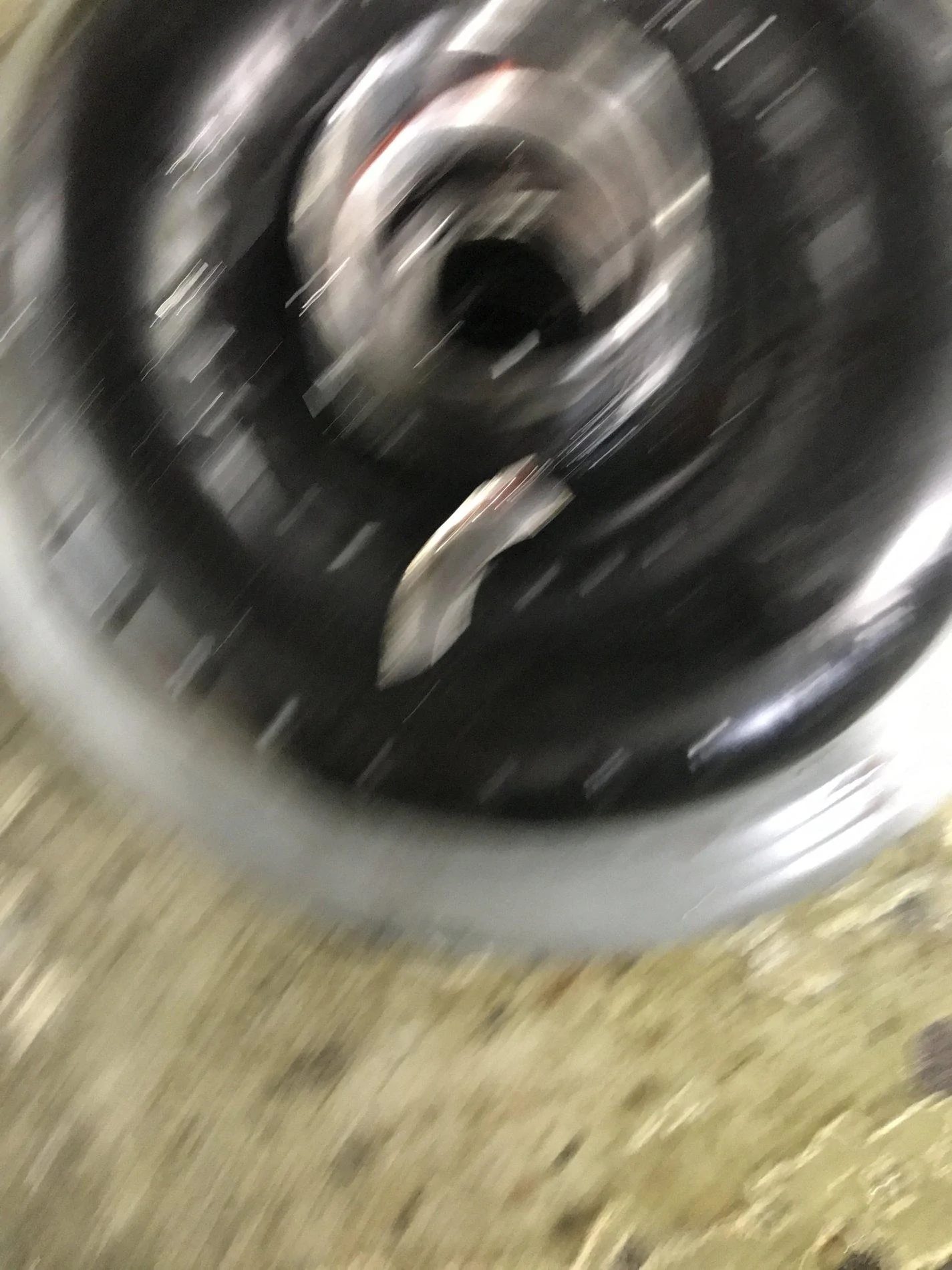

Well, Circle D converter is out and it’s definitely broken.

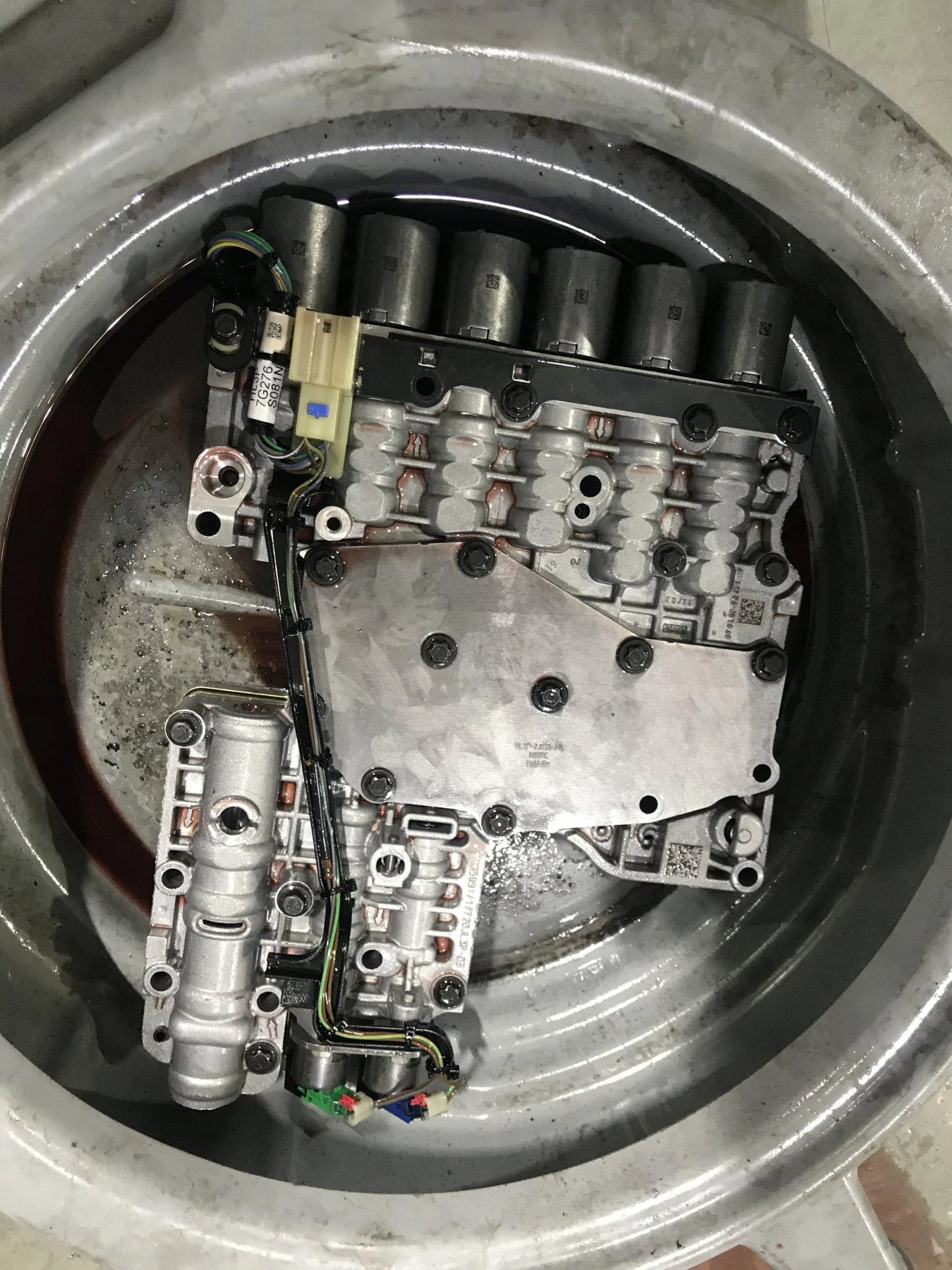

Shop recommend a new valve body rather than risk the old one even with flushing out all the lines.
Old one is going back to Ford as a core . I never imagined it was that big and heavy .
It’s all back together but they want to make sure all lines are properly flushed out so I won’t be picking it up till Monday .
I am thinking of getting rid of the “first gear delete “ tune with the stock converter. . Not sure if that contributed to the failed converter.
Circle D have been cool so far(even apologetic) and said I should send the converter back for them to look at and repair .
Not sure I will be putting it back on when they fix it and may try and sell it to recoup some coin .

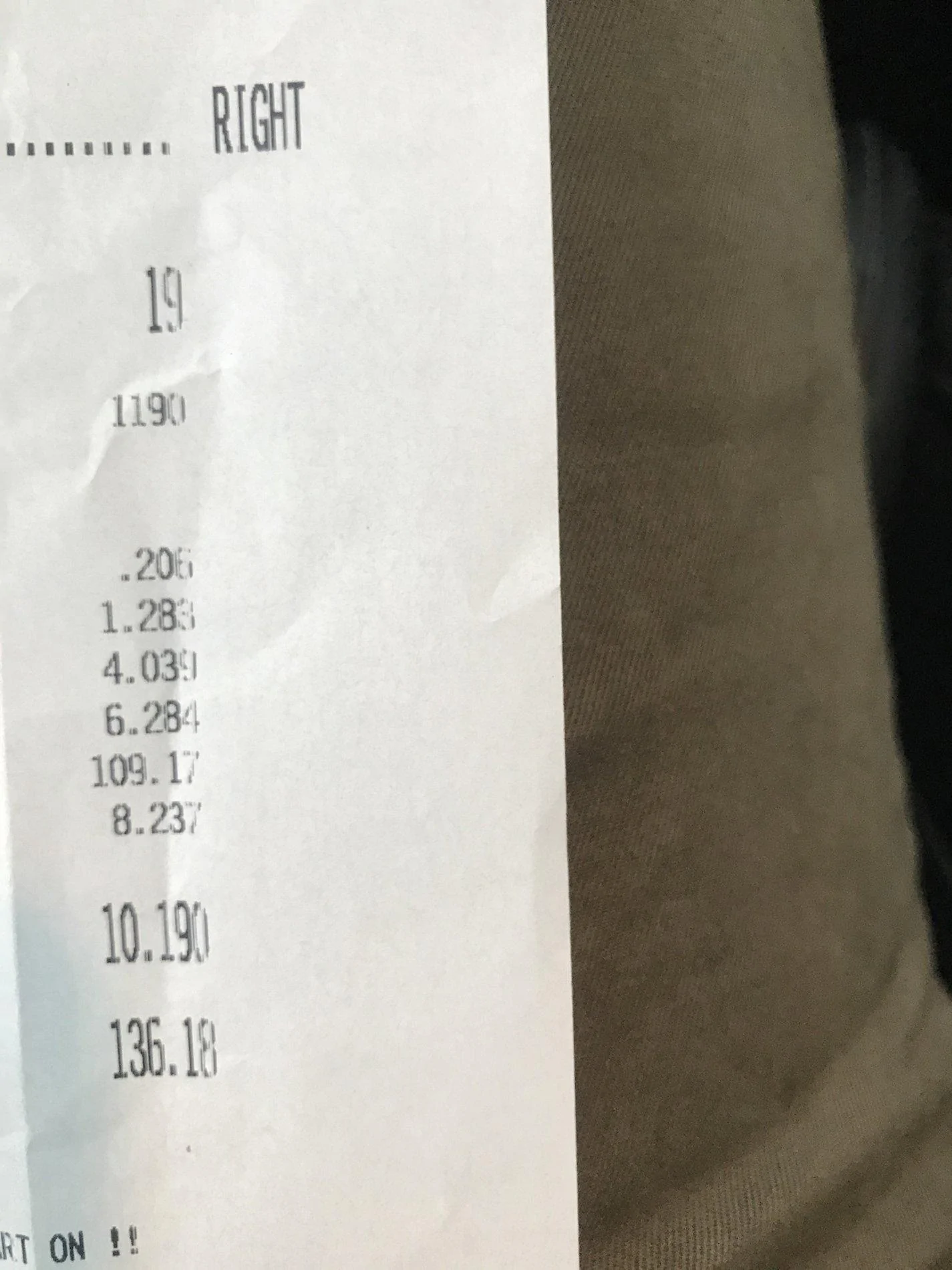

I was able to cut 1.4 60 foot times with the stock one and while not great it’s still pretty good .

It worked(ignore the ET/MPH lol) ..... for a while .. till it broke .
