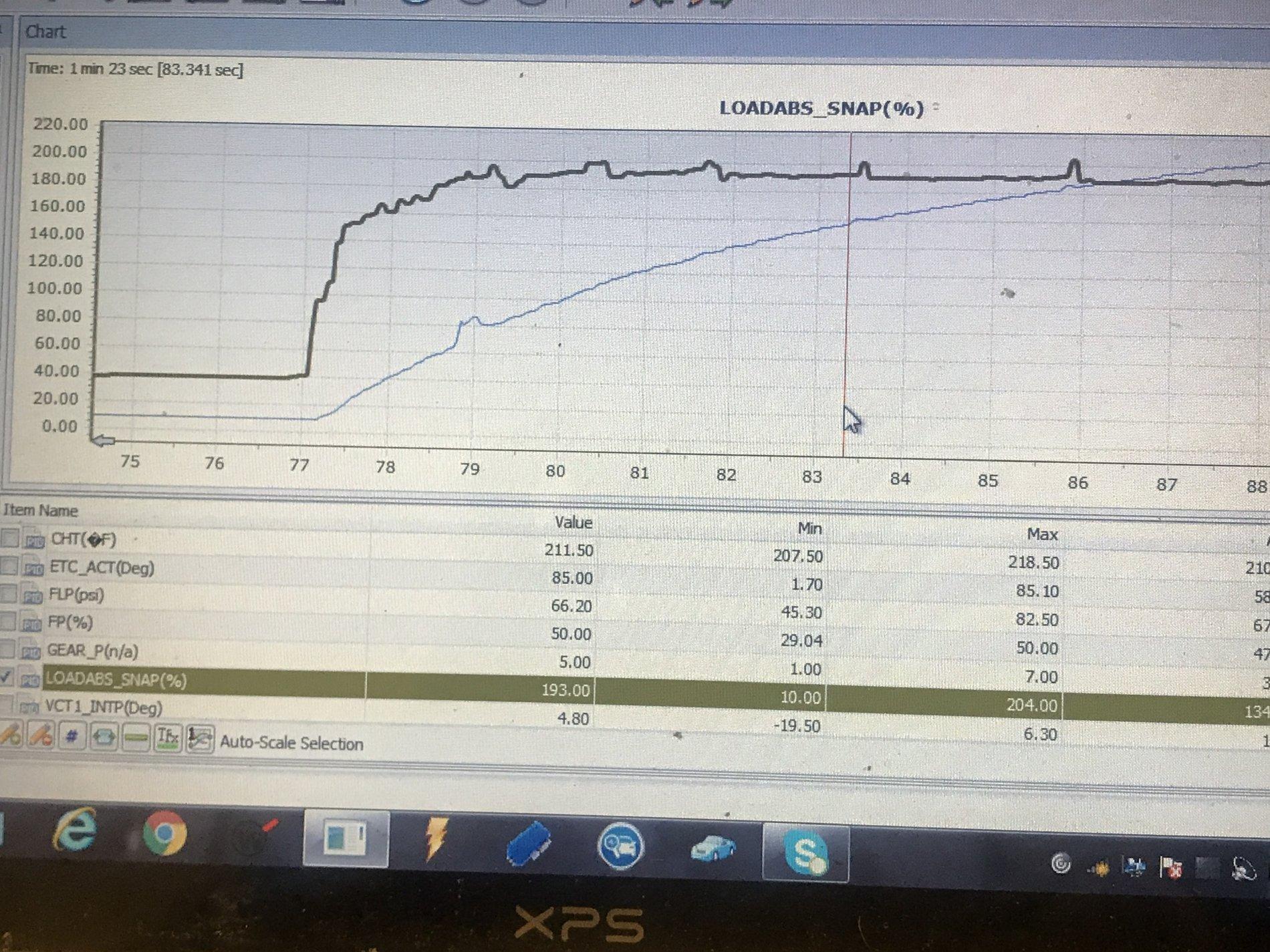

Are you logging boost ?

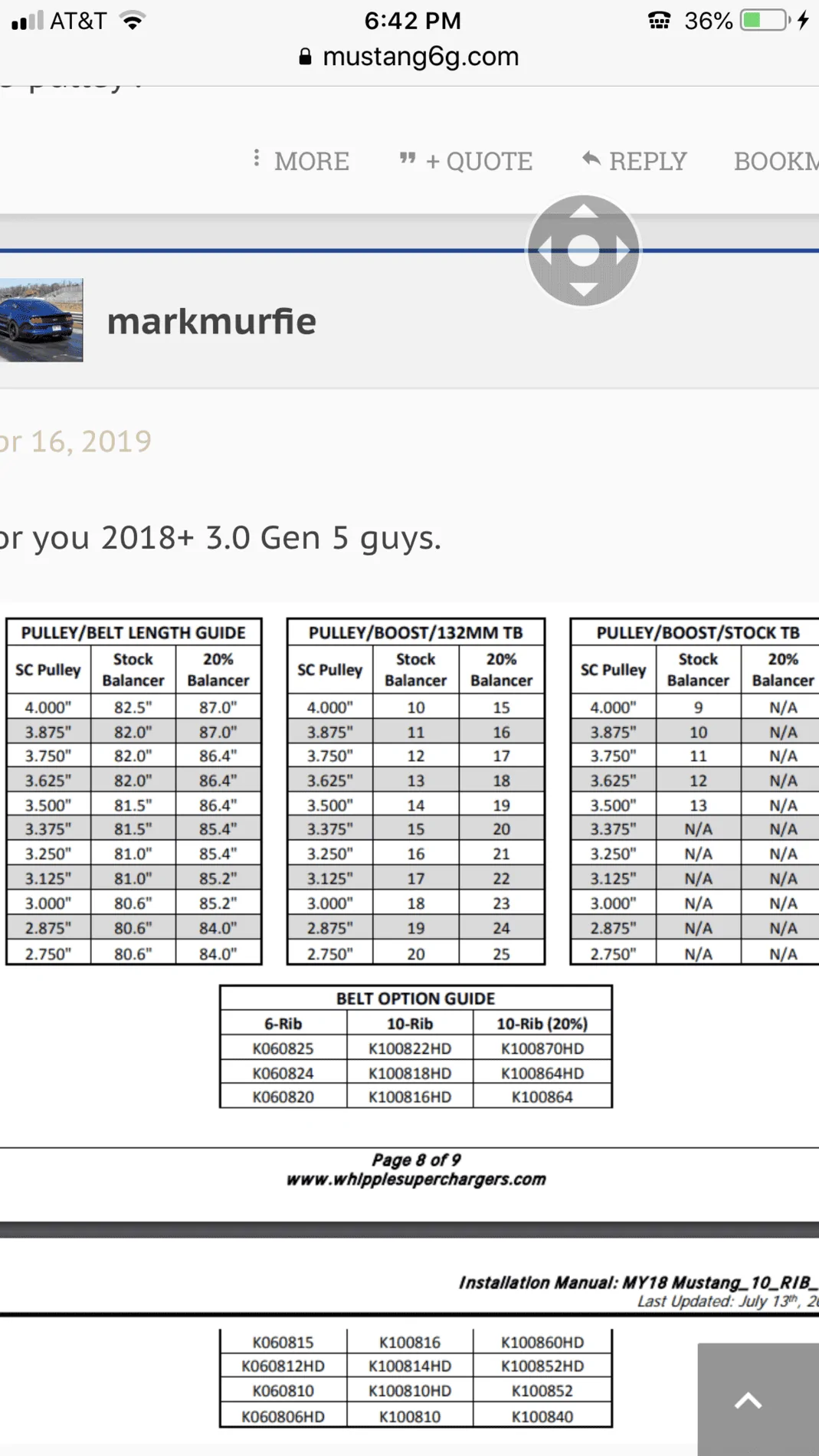

What belt size are you running with the 3.5 pulley?
May be move adjustable idler to take up some the belt slack .
I can tell you based on my experience that you ARE definitely spinning in that 1-2 shift .
Pretty sure if I can (being a mechanical ignoramus) read basic PIDS on the log , you can too .
Just down load SCT live link on your computer and plug in the Ngauge.
Take a look at your mph and you will see how it “bumps “ on the 1-2 shift .
I will take a screen shot of my MPH logs for you to see .

3.5 pulley. The makes on the Tensioner are lined up. But I can try and make it tighter.

Per whipple chart it’s the same 81.5 belt for the 3.625 and 3.5 pulley .
@PC 2015 Here is a screen shot my mph log (in blue ) before the converter .
You can see it pin when it shifts from 1-2 .

No same belt.
Hey man . Sorry I misspoke before .
You need a shorter belt (81.5) for the 3.5 pulley (coming from 3.625/3.75)

What was the part number you used?
I used the belt that comes with the kit. The spring Tensioner arrows are lined up but it is got to be to long. I dont think a 3.5 pulley should get belt slip.
