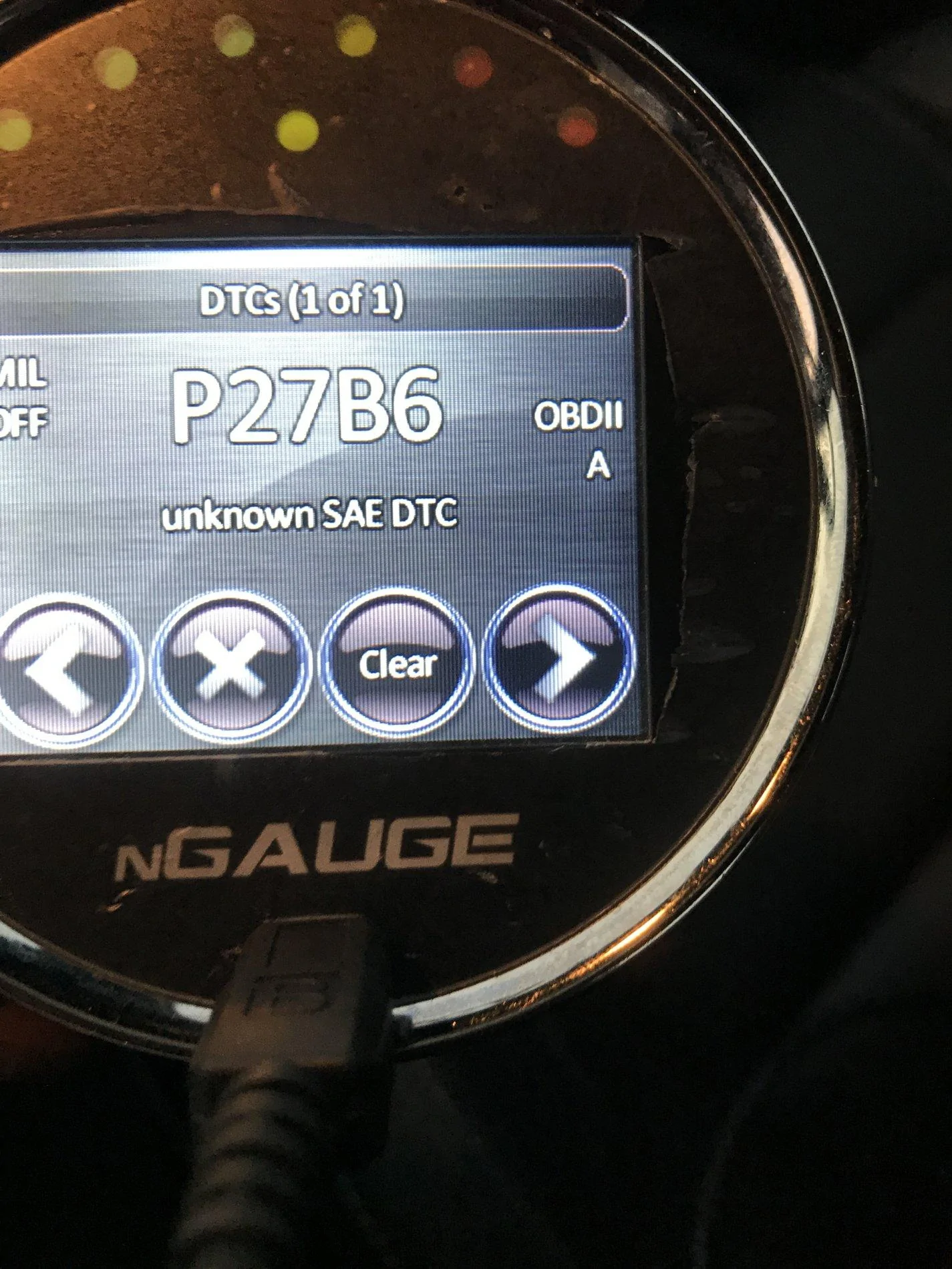

What do the logs say?
Thanks, Dont know yet. My friend is gonna look them over today.
Sounds like TB is closing ?
That's what I'm thinking at least that what it felt like. I'm thinking hoping it the throttle body wiring harness. But it drives perfect. This is a new problem. I'm gonna be honest. I'm done building cars lol. Cant stand this shit. When is that new zo6 coming out lmao.

It just never ends with the BS. Went to last night couldn't get a break. First pass car felt great till 4th gear then just stopped accelerating like limp mode but no code. I just rolled to the end floored because I was pissed everything was normal car ran fine. Second pass ran perfect went 10.5 at 134. Best 60 I had so far 1.60. Third pass car went in to limp mode Po124 throttle body code. Reloaded tune fourth pass same as first. Dont know why or what would cause the car to stop acceleration like that but the car runs great. Man this shit just never ends.
I.p.o

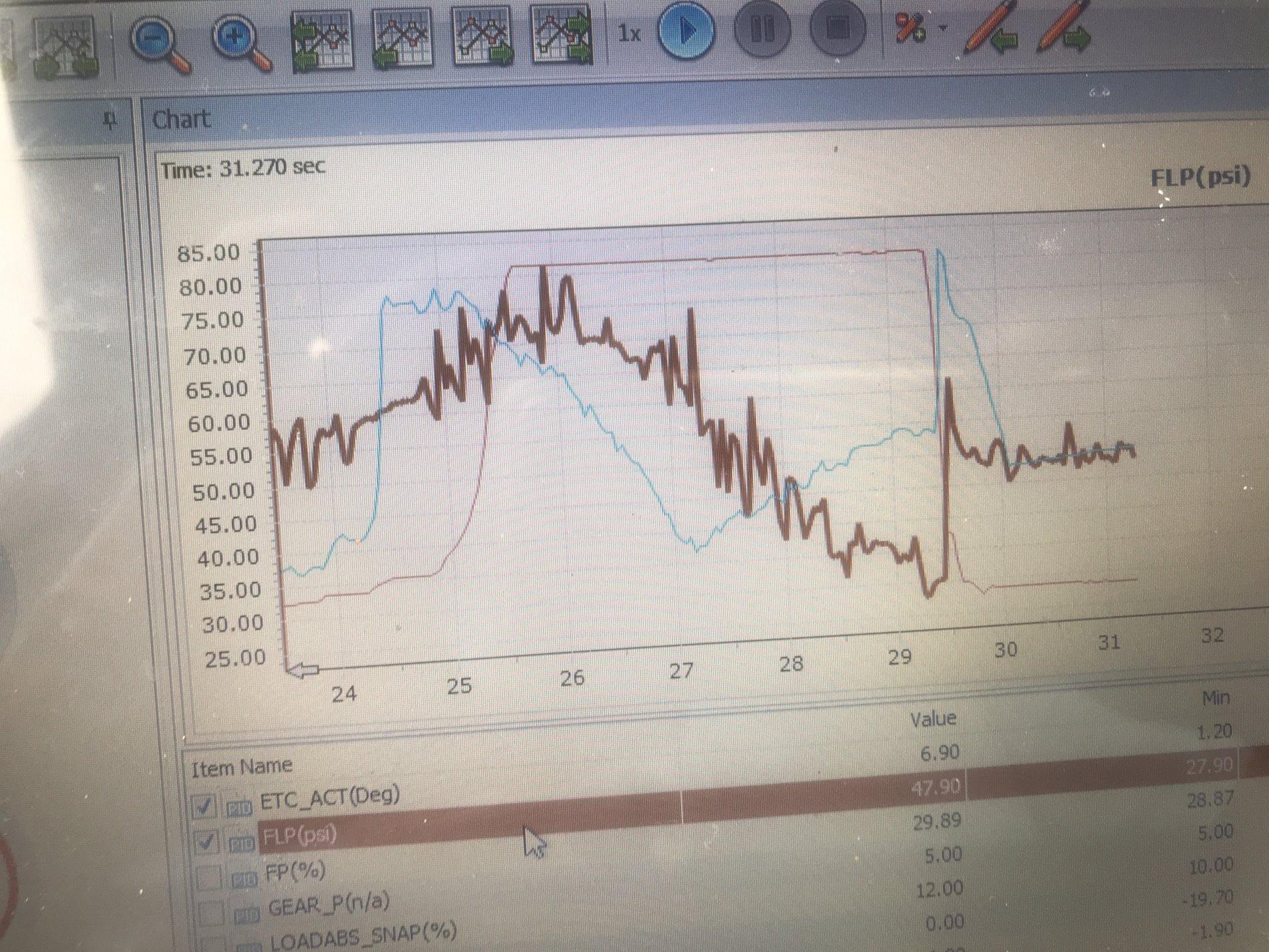

My friend look over the log and it looks like could likely be the fuel system, wiring issue. I'm mean the whole car was built so problems can and will most likely pop up. But after I get this taking care of going back to the track with the 3.5 on. Should go 9's

The logs dont lie. one pump die and shut the car down. Checked all 3 pumps and they all work fine. Fixed the wire the loose wire All good now. So I've come to the conclusion that the 3rd pump never came on with I have to look in to. I need to see if the hob switch is bad. I'm pretty sure the wiring is right. I also need to check my boost reference is good and not just vacum only. Where are you guys getting your boost reference from.

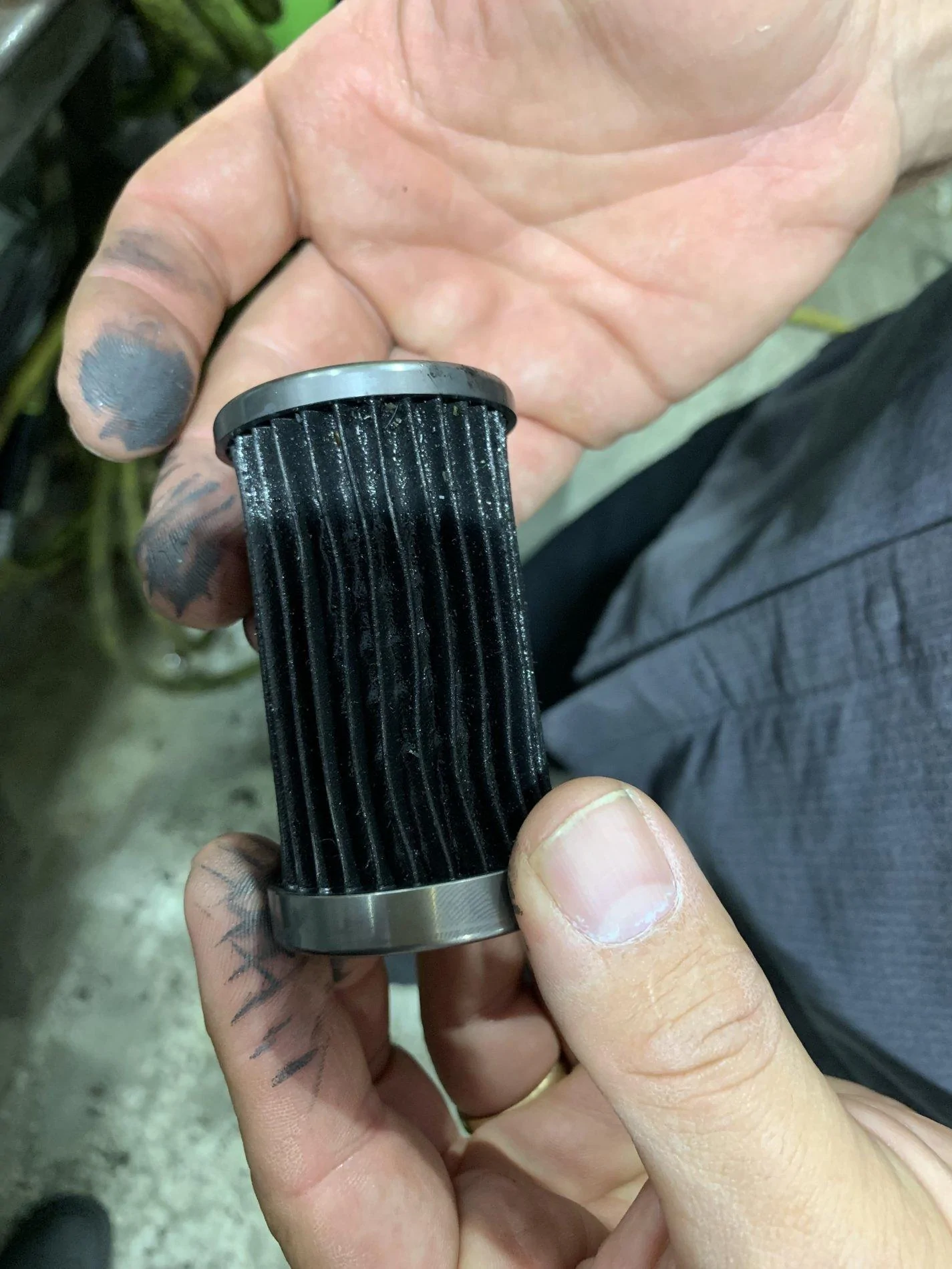

So after fighting fuel pressure issues that turned out to be a clogged filter(I checked after I kept losing FLP despite swapping new pumps ) finally got to make a pass with the new converter .

That's crazy how much stuff is in your filter, I am curious to see mine over winter here...

Its crazy how much junk was in the filter . You could not blow through it .
I have had the system installed for less than 2000 miles so we were all surprised. May be I got a bad batch but I wonder if it could be from sediments I the tank from all the boostane I had been running.
I did pump out the tank to empty before my first fill up with E85
Here is what my FLP looked like before and after swapping new pumps .
It good now with the clean filter but the high side is still not a flat /table top like before when I had the BAP.
