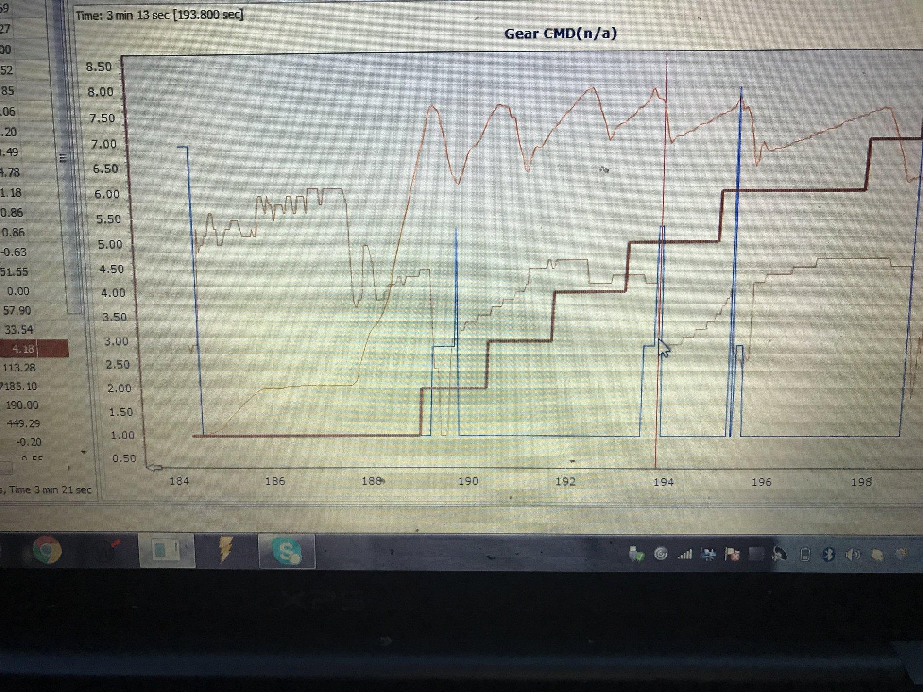

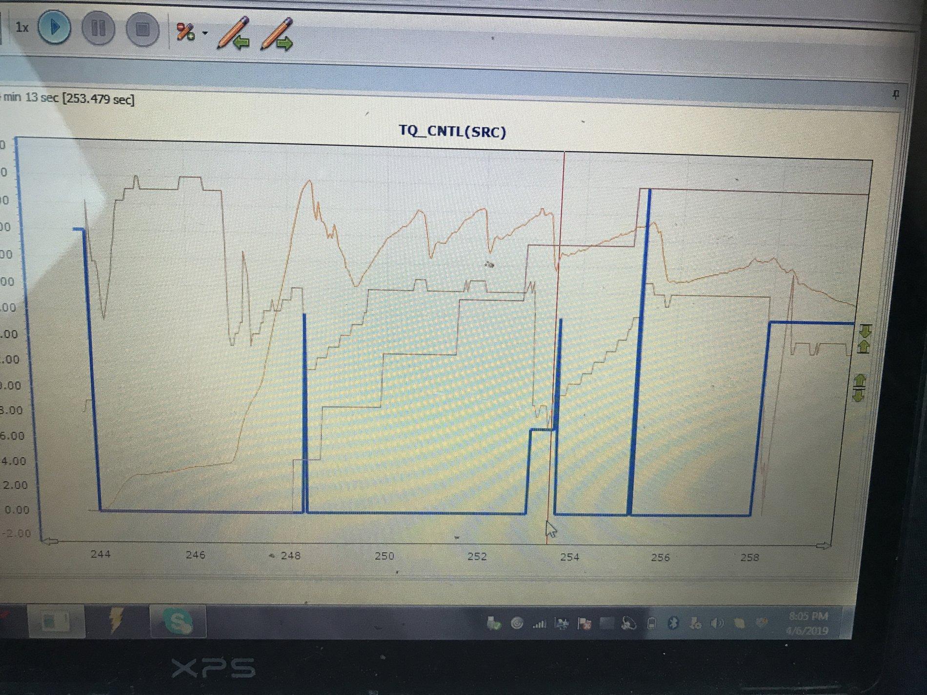

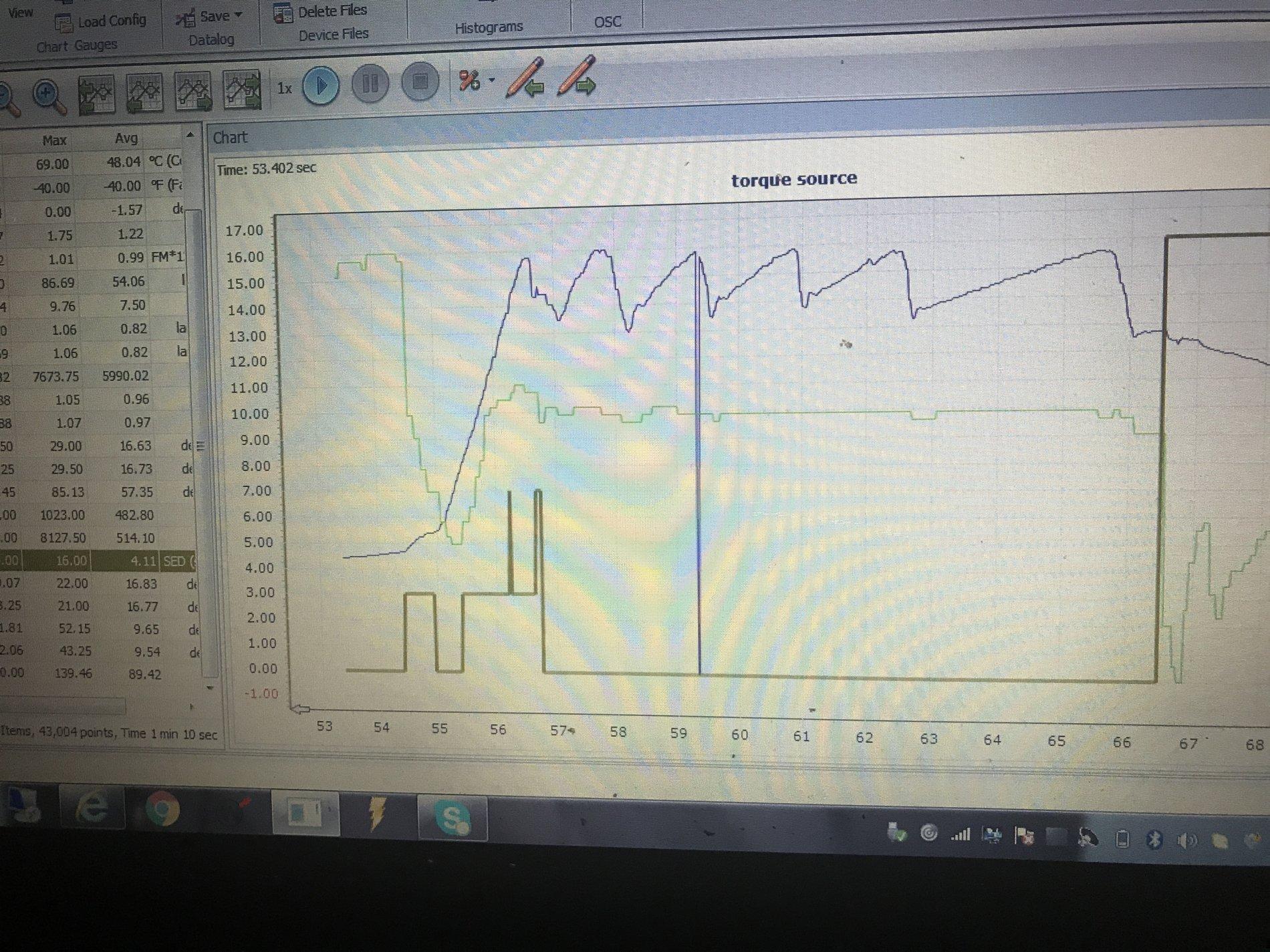

So is this a transmission issue ?
Here is a pic of the log of 10.0 pass with rpm/spark in orange and torque control in blue .
Knocks spark down on 1-2 , 3-4 and 5-6 shifts .
First time value is 26 (don’t know what that is) ,second time is 7-16 and third time 16 .

The first 10.17 pass it only did it on 1-2 and 5-6

On a pass today it did on 1-2 ,4-5 and 5-6.

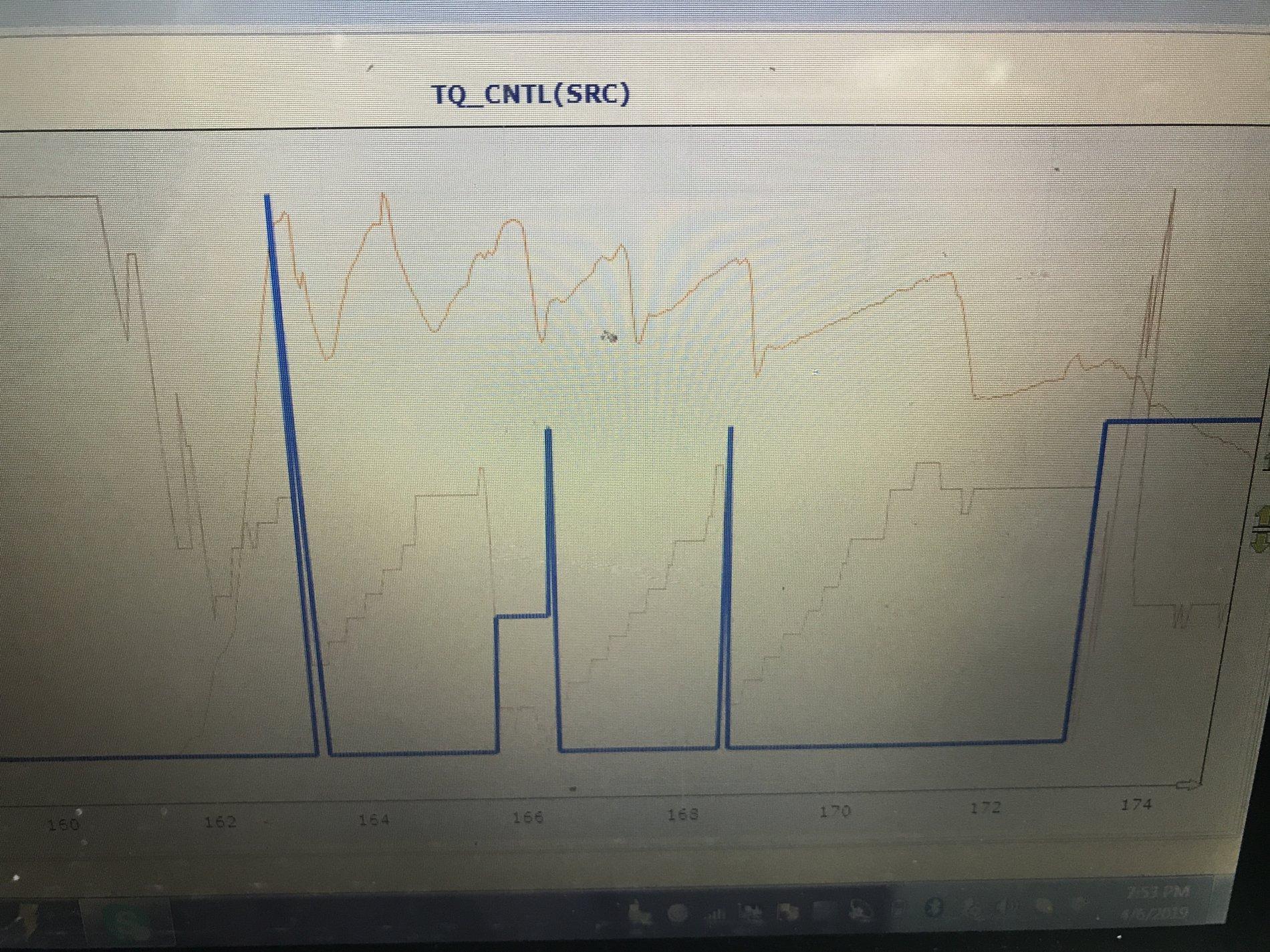

Here is a log of a pass with the old whipple tune .
It cut spark(green) only on 1-2 and 2-3 but looks much better down the track
