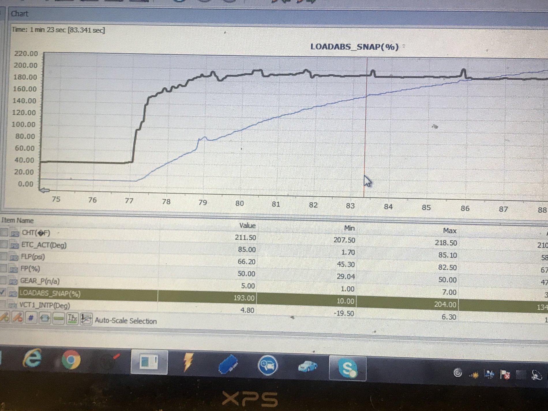

I don’t think I can with the N gauge .
What are your “Load SNAP(%) “ values ?
Here is where I am at consistently with the 3.25 pulley .
Max load is 193 (190-193) but flat except first gear.

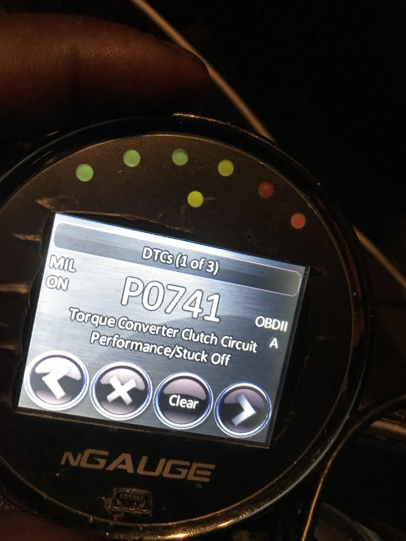

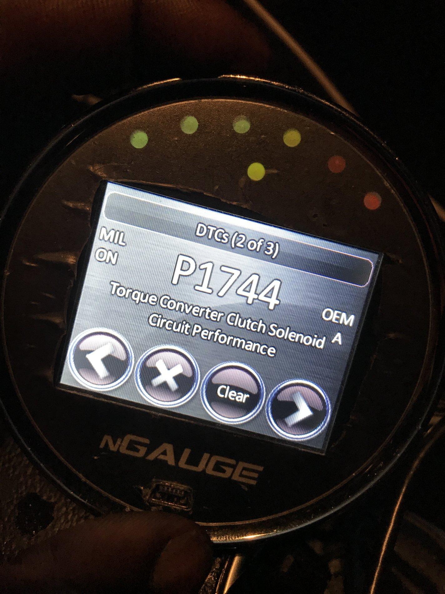

Just limped car home 70 miles and
I think I broke the something in converter.
Codes are TCC codes .
I got there late and then waited a couple of hours to make a pass hoping for decent air .
Normal burn out and car uncharacteristically spun real bad trying to leave at 3500 rpm, so I aborted the pass and just drove to turn around .
On return to the pits it threw wrench . Backing up to pit I noticed left back tire was leaking air and almost flat .
Thankfully I got some help and was able to plug the hole tire .
Car jerks in every gear but was able to limp it home leaving it 6th (drove best in that gear and wanted to avoid any shifting
-drove about 50 mph ).
Hoping I did not damage the transmission anymore by driving it but could not get a tow when I tried(at least for 3 hours ).
Not sure when tire went flat or if it hard anything to do with the TCC but I checked my pressures (18 psi ) on both sides just before pulling in to the lanes .
I guess it’s plausible it had gone down before I did the burnout or during and then trying to launch on an almost flat tire did the damage ?

I am hoping that’s “all” it is .
I did have them swap the valve body(at my cost ) when I did the clutches early in the summer. It did not have a code then but I thought it was good idea to do it at the same time .
I am going to see if I can have it replaced under warranty since their is a TSB , but I doubt it with the rebuilt
transmission/aftermarket converter .... unless my SA can work some magic .
Maybe the stock valve body did not play well with the new converter /first gear delete tune ?
Maybe launching on an almost flat tire (not sure if was down then ) ?
