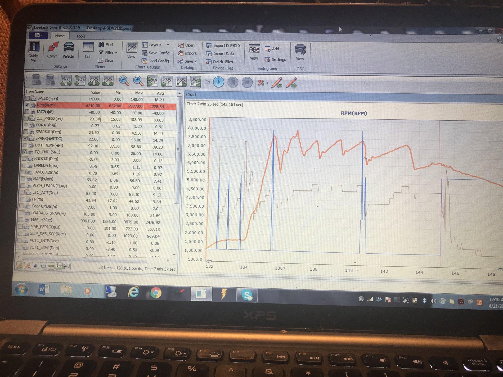

So is this a transmission issue ?
Here is a pic of the log of 10.0 pass with rpm/spark in orange and torque control in blue .
Knocks spark down on 1-2 , 3-4 and 5-6 shifts .
First time value is 26 (don’t know what that is) ,second time is 7-16 and third time 16 .

Thanks for the above information . I already knew about 7 and 16 (I had the GT 350 table ) but looks like 26 is also transmission related.
I got an updated tune and was able try it out today
Only made one pass as my bumper/splitter keeps falling/hanging down (I think it’s the crevini lower grill that has stretched the tabs ?)
Another 10.0. It seemed to leave harder and I could tell it was faster up to the 1/8 then seems to falls on its face especially after it shifts to 7th gear.
I thought I had it but ..... no .
The torque control is less intrusive and only on 1-2 and 5-6 shifts but does not knock timing down past 19(from 22-23 peak ).
I also noticed lower rpm shift points ans crossing the traps@6100 in 7th is not helping .

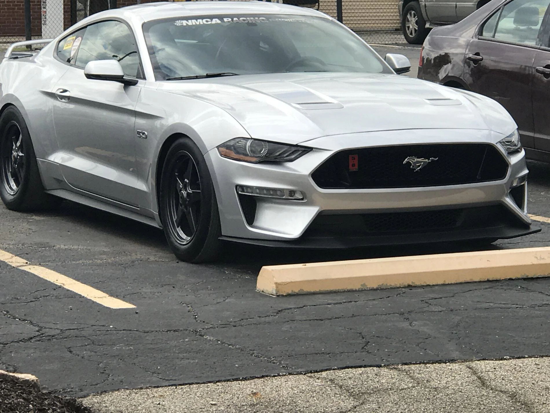

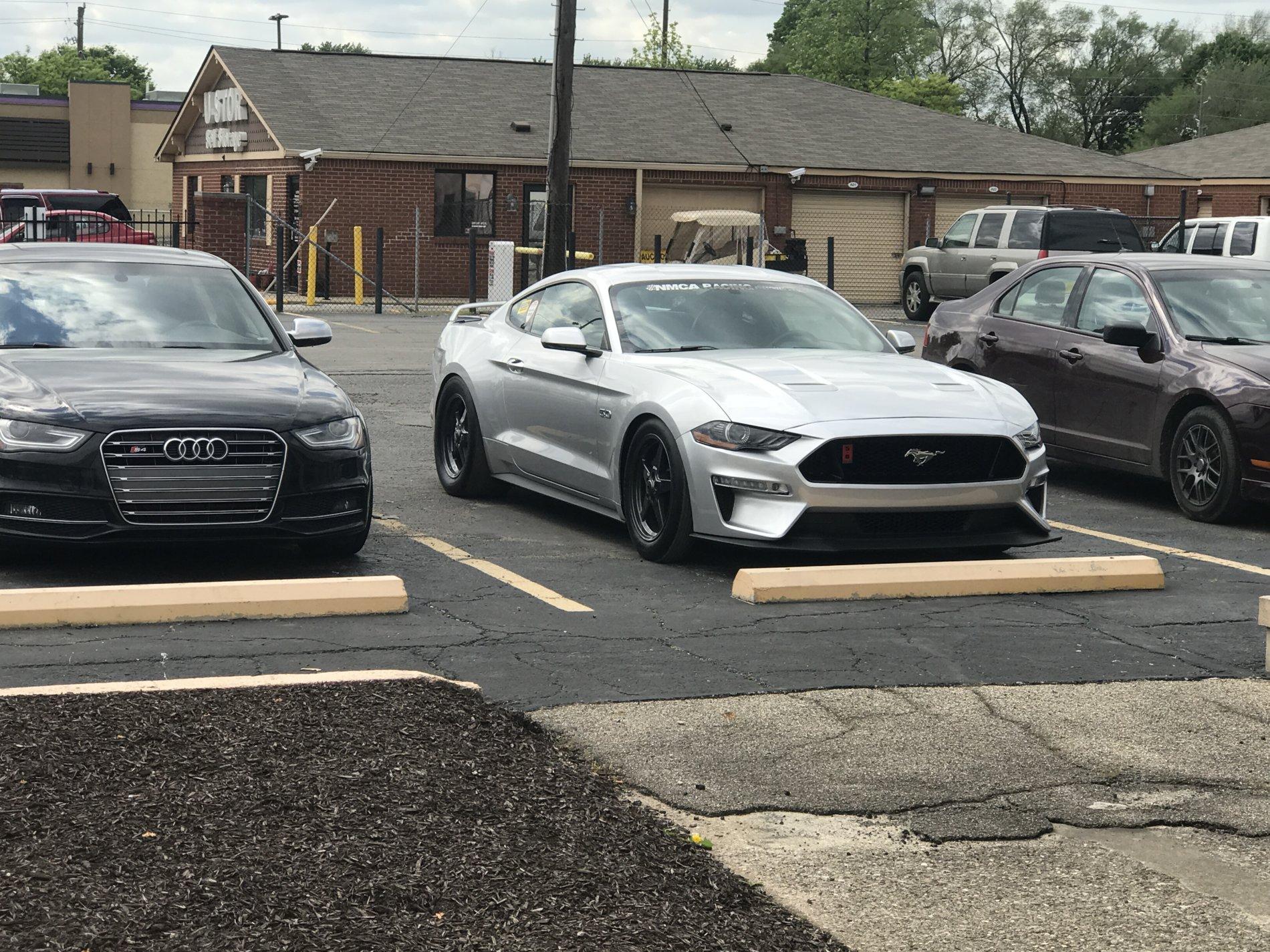

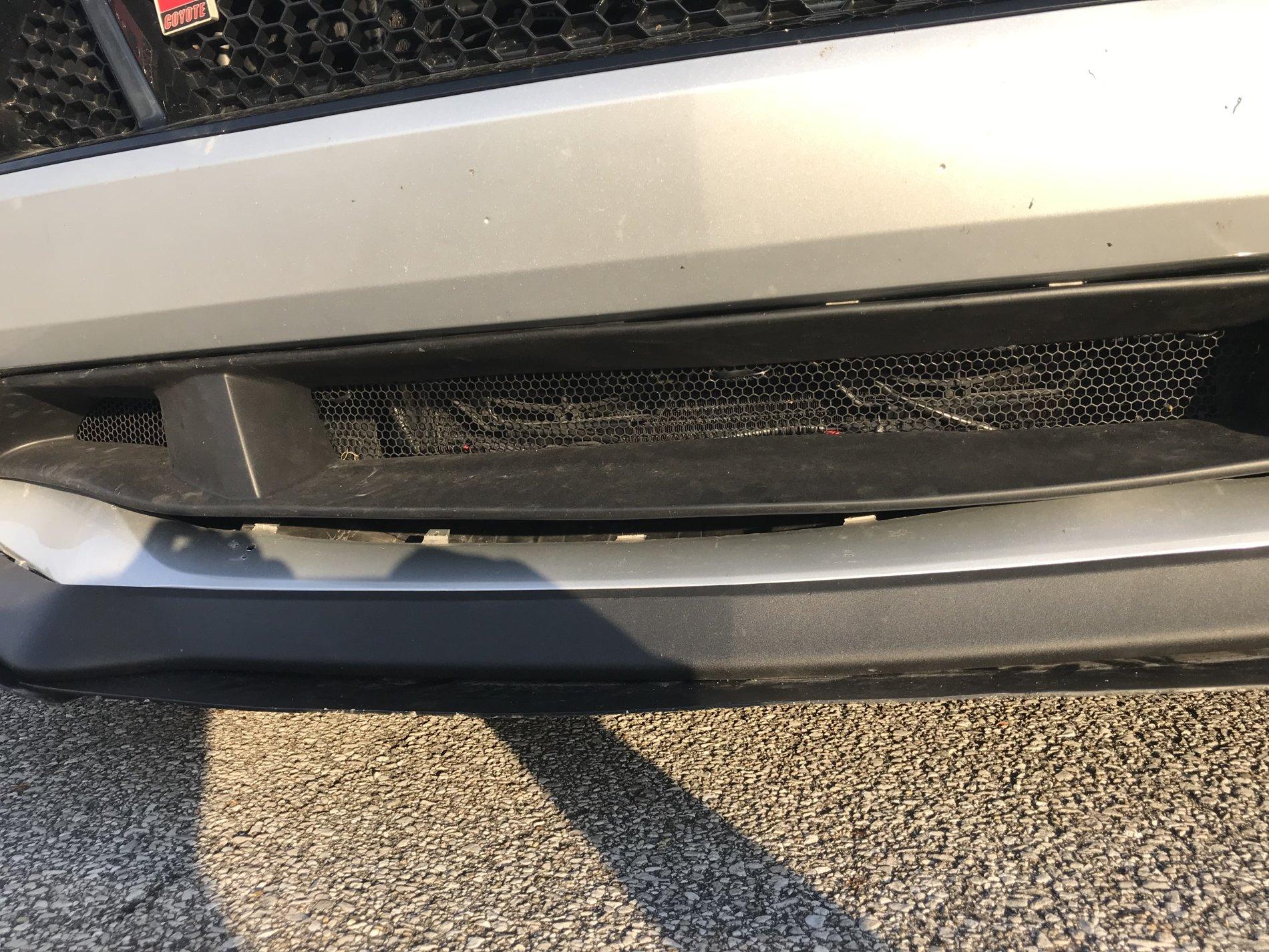

Pics of my saggy lower grill /splitter

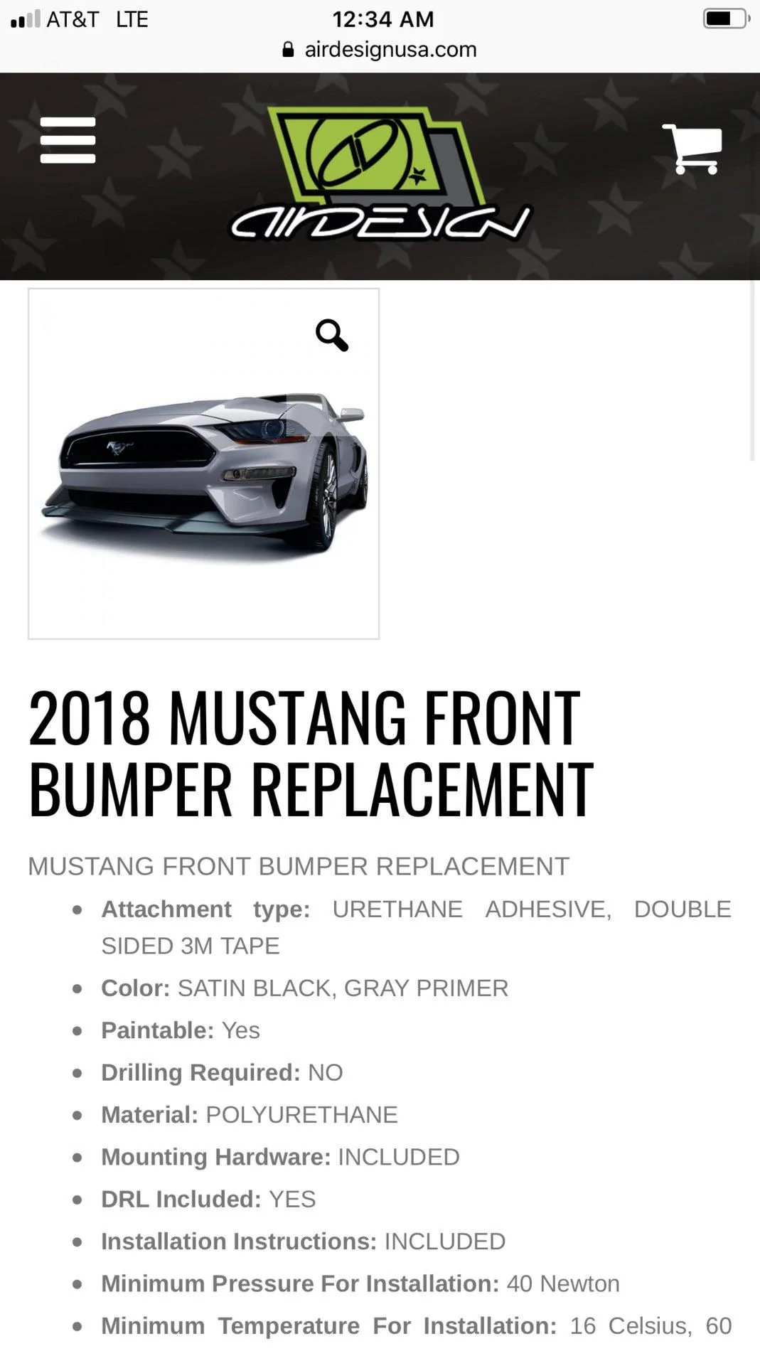

I ordered a new bumper from air design .
Looks like they make the “steeda” bumper but you can order from them for almost half the price !

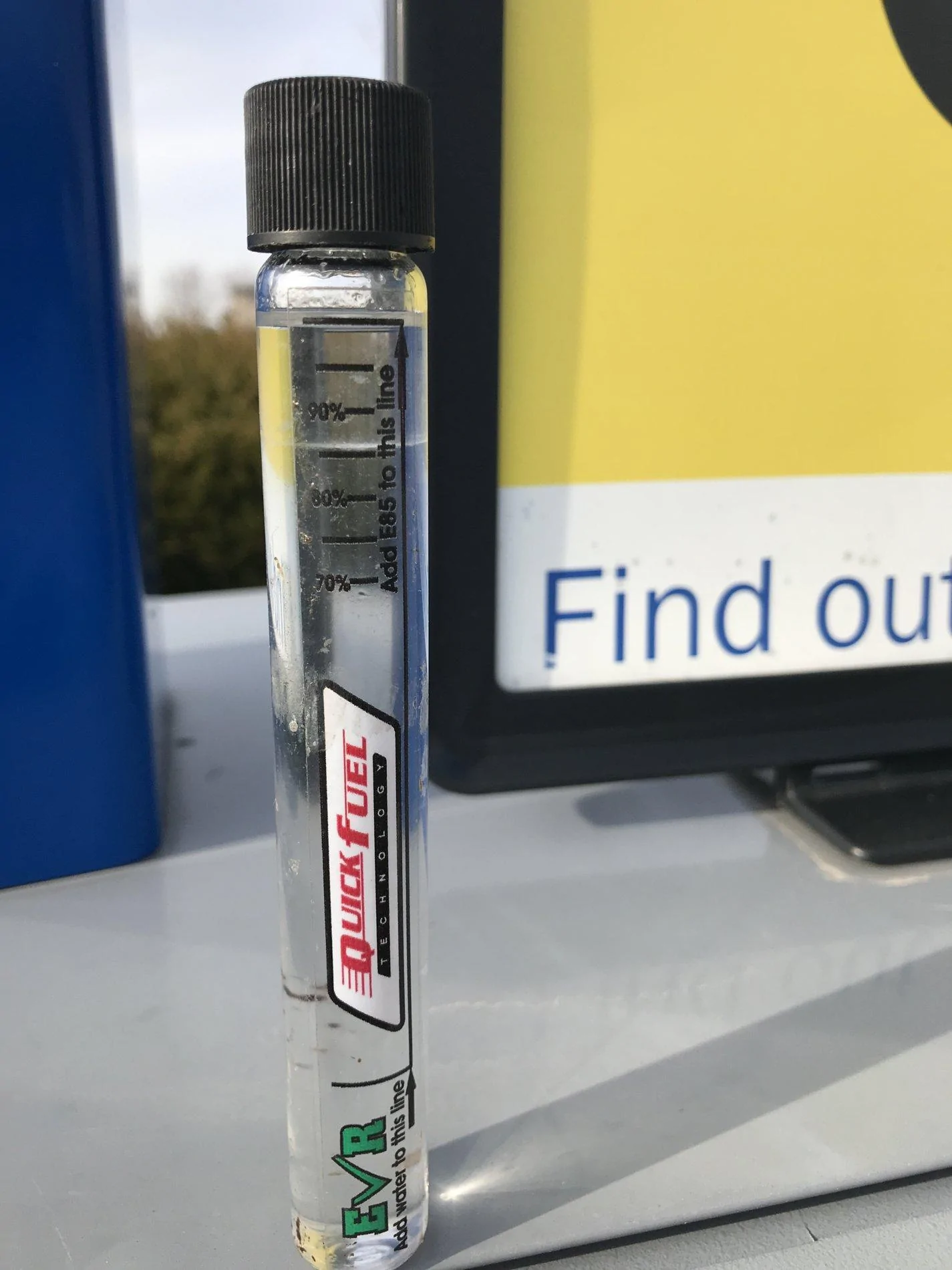

Pump E85 but tested at 85 .
Tuner thinks it’s the cats .
I will delete them eventually . I just want that 9 first without the noise .
Next time out I will pulley down to 3.5 pulley and run race gas .
If I don’t get that 9 then the cats come off .

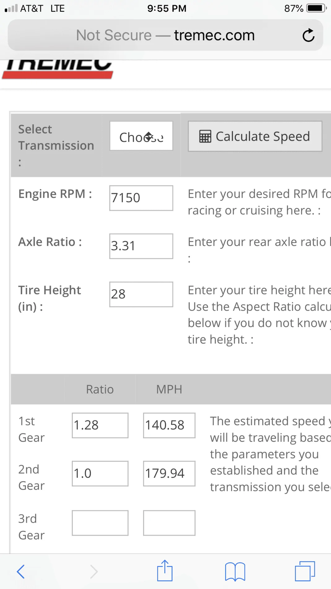

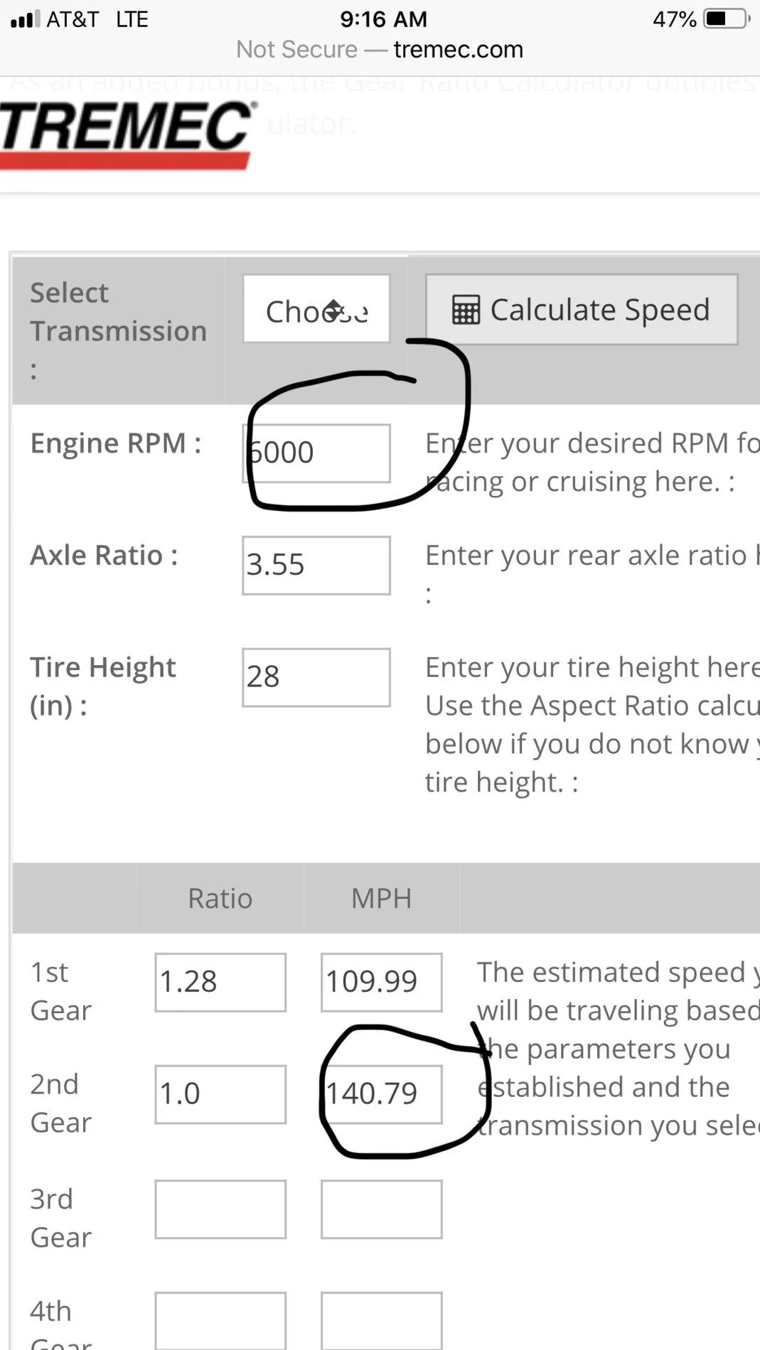

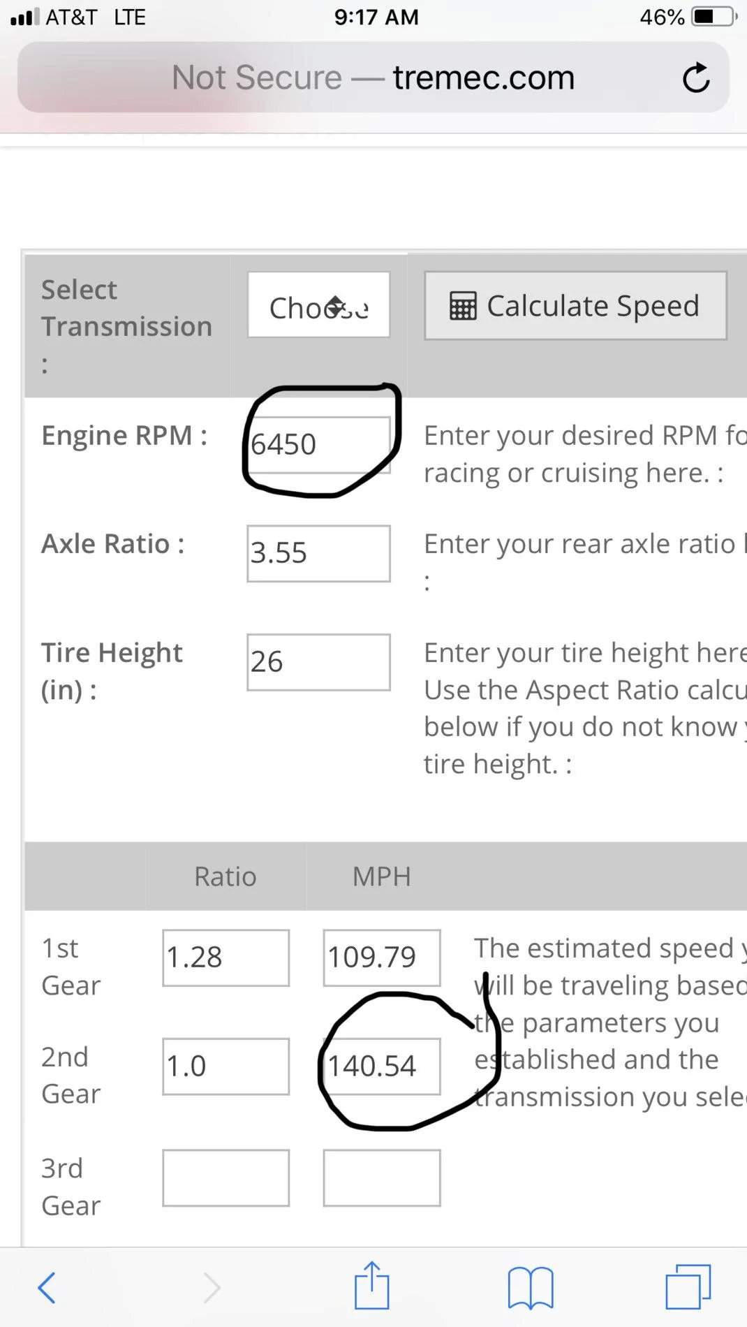

Since I am crossing the traps with my 3.55 rear end at about 6000 rpm(7th gear )@140 I figured the 6-7 shift is also killing ET.
I have heard of others swapping the rear end to a 3.15 and using a 29 inch tire to stay in 6th but my car is lowered so that tire would not work .
I did some calculations using the Tremec gear calculator using the 1.28 6th gear ration (7th is 1:1)
I have a couple of options available to me
The easiest would be trying my 26 inch slicks which would mean a little more acceleration and I would cross the traps at about 400 more rpm but again after 6-7 shift .
I have a 3.31 iron rear end assembly that came out of my KB car after I swapped them for 4.10’a
Looks like the best option as It would stay in 6th crossing the traps@7150 rpm/140 mph .
If I pick up power it would still let me cross @7500/147mph

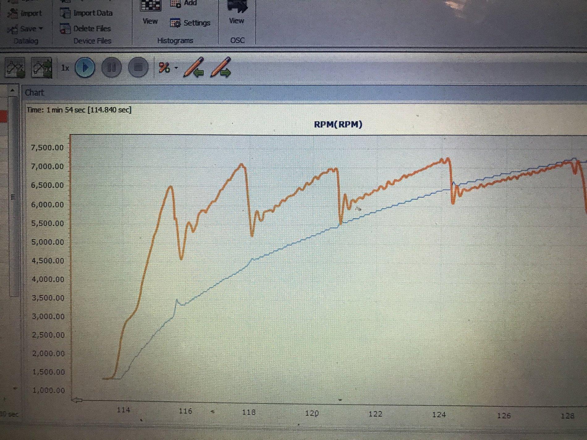

Torque management is probably saving your transmission..
I think you were 100% right about this .
I ended up swapping in a 3.31 rear end and got new tune with reduced “improved “ torque management .
First pass 2 weeks ago with new tune(Ms109) it went 128 mph ! (Down 10 mph ) . It was about 2500 DA but hard to imagine that would slow car down that much .
It looked like it was still short shifting 6th and going into 7th gear so making things even worse since I now had 3.31
I went back to an earlier tune version and it picked up 4 mph .
I then ran the C16 tune(with reduced torque management) with increased timing and it picked up some to 136 mph .
I tried going to a 3.375(from 3.5) but found the pulley was the wrong offset .
I broke out my 3.25 grip tech and it picked up another 2 mph to 138 mph... still short shifting 6-7 so still crossing the traps in 7th
I was convinced a new tune with increase shift RPM especially to allow to me to stay in 6th thought the traps would be the ticket .
So I got new tune(went back to 3.5 as belt was too long for the 3.25...and scared ) and ran it again last week ... big fail !
Car short shifted every gear and does not looks like it put any power down .-trapped 110 !!!
Logs otherwise looked perfect with usual load /timing /negative knock /fuel .
No noises from motor or smoke/oil or coolant loss
No codes .It will rev to 6500 then short shift .
I had been getting a lot of the rpm flares in almost all gears . When I used the paddle shifts it’s worse in second (it skips this in auto )
I assumed my clutches are toast or something else in the transmission.
I had dropped off the car at body shop to fix saggy bumper after last weeks fail.
I picked it up went back today and decided to test an earlier tune version in case it was the reduced torque management but did the same thing .
Looks like I need new clutches . (Already have them as I ordered last week ) . My dealer wants $1700 to install !
I am thinking the clutches may have been slipping from the get go hence the lower than expected traps but the reduced torque management and the 3.25 pulley may have been the final straw!
