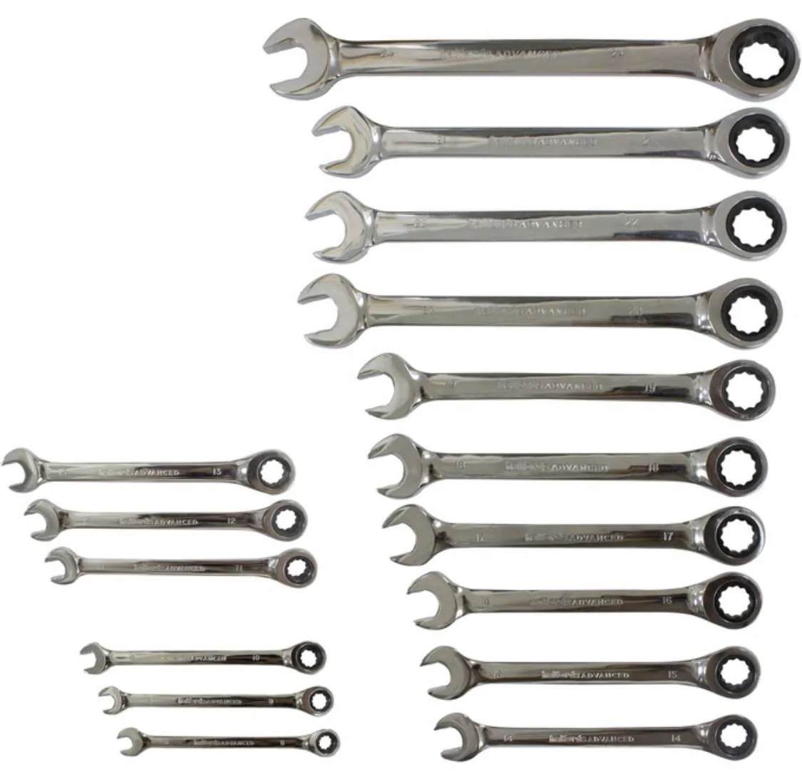

Does anyone have a list of the correct tools and / or any photos of how to access the rear camber adjustment bolt ?
I’m looking at getting this done soon so any hep would be really appreciated :like:
Cheers,
WD :like:

An alignment rack, long wrenches and a 4 foot prybar.
Can you get box end wrench’s onto the camber slot bolt ?
I have the ratchet type that normally prove quite useful :
I’m hoping I won’t need a pry bar, I have the J&M camber brackets in there :like:
Any tips or special kit for torquing that bolt up after adjustment ?

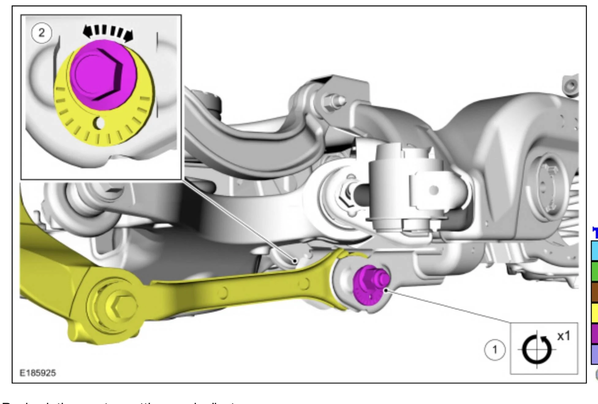

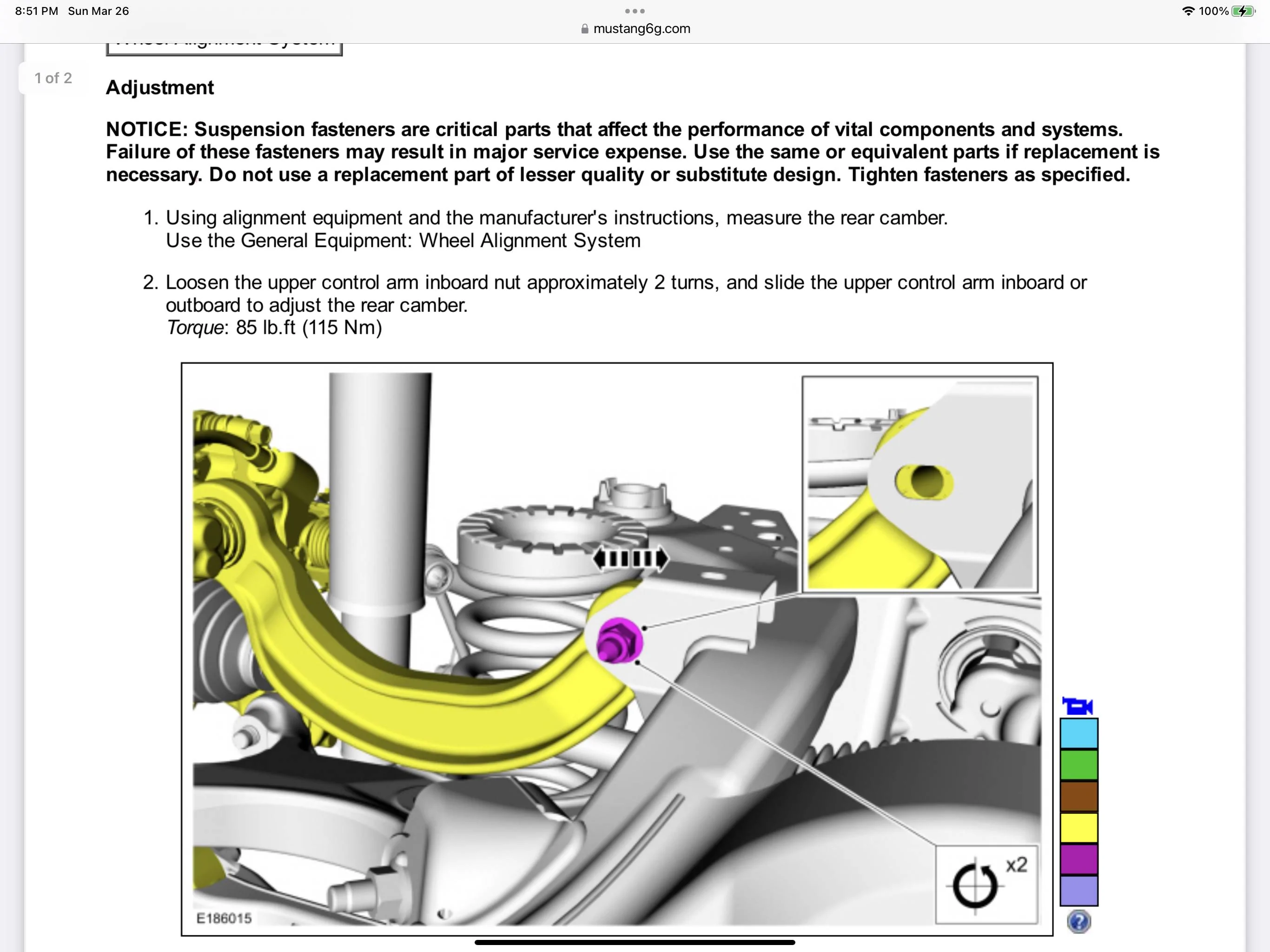

Sorry for hijacking your thread OP, but I was going to post a new topic about a rear alignment problem I'm facing as well... But first how do you adjust toe and camber in the rear?
Anyone fancy posting a picture with arrows so I can show the shop how to adjust the rear please?

Thanks mate! I will open a new thread with my alignment problems so I can gather input from you guys
