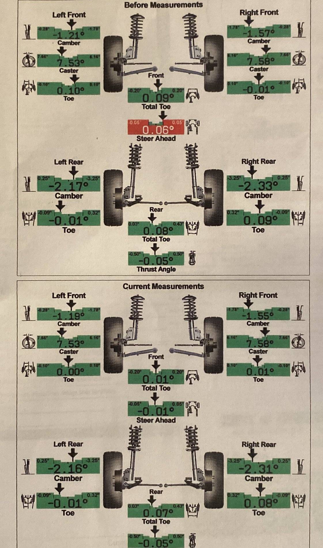

Hi all....can you review this alignment and my situation and offer advice?
Mostly stock 2015 GT, lowered years ago with Ford performance springs. Wears the inside edge on the tires...also did this before lowering when new....it’s also a bit darty and unstable in straight line driving. I don’t track other than 1/4 mile, and want a stable daily driver that wears tires evenly. Ford 20 inch rims, OEM sized tires.
I paid the local ford dealer to align, told them I had tire wear issues on inside. It looks like they made almost no adjustments. What’s causing inside tire wear? Is it the Camber? Thanks!

Inside front tire wear is a common issue on the S550 platform. Is that where you're having issues or is it in the rear?

For the front caster is out as expected. Toe was adjusted, and it made a tiny positive impact on your front camber, but you'll need some camber plates to really make a difference there.
What's interesting to me is the camber in the rear. They should have adjusted that back to something a little better. It seems like it's about a half degree farther out.
I had a similar issue lowered on factory 20s. The OE tires wore awfully. I’m not noticing uneven wear on my current 275-35 Indy 500 tires.

Yes that rear camber is a bit high for a DD alignment. And the rear should have a bit more toe in.
Did they charge you for a 4 wheel alignment? Because it looks like they didn't touch the back.

Rear toe is bad... should be .11-.12 on each side. Rear camber is also bad... it is adjustable from the factory (inboard camber link bolt mount is slotted) and should be closer to -1.3 to -1.5. Front looks ok.

I had mostly rear inner wear, and told them that was the target for alignment adjustment. I did pay for a 4 wheel alignment and it appears they did not adjust much of anything....I think I am done with dealers for anything other than free warranty work. The paperwork for the oil change states they added 6 quarts, and I was 99% certain the 2015 5.0 was 8 quarts so I pulled up the Ford website specs and it said 8. I had them pull the car in a bay and check, it was about 3/4 quart low, and they had to add. WTF? It’s a FORD car that you are trained in servicing!? I could maybe understand if I had brought them. 1947 Bentley that requires 7.85 quarts or something but what a crap show that was......

That's why they call it the stealership. I wouldn't trust a Ford dealer with much on my car particularly alignment. You need to find another shop that can do better. The rear toe and camber are kinda bad. You also have a little too much cross camber up front imo.
