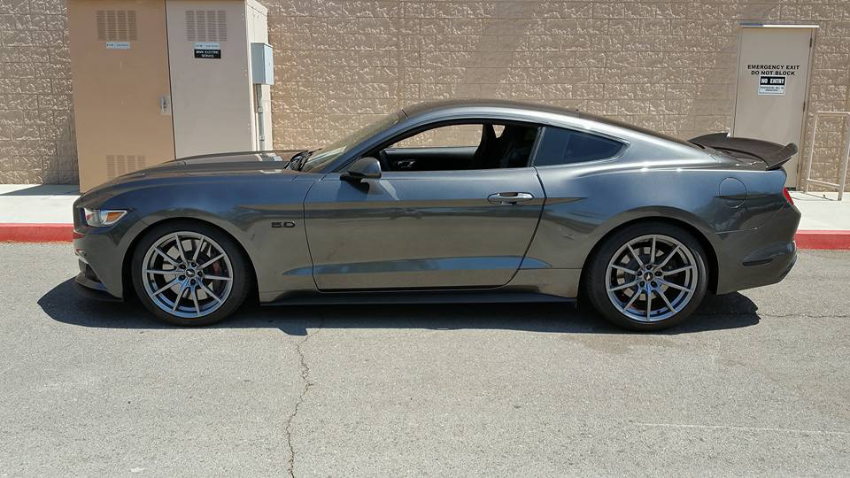

I have a 2015 GT PP that I am ready to lower.
I don't want to give up ride quality but I want to close up the wheel gap.
I currently have the stock PP 19" wheel but I am planning to put 20x10 up front and 20x10.5 in the rear.
I would love to hear your thoughts and see what do you guys recommend.
BMR's SP080 spring kit is what you're looking for. Also works very well with your stock PP dampeners.
