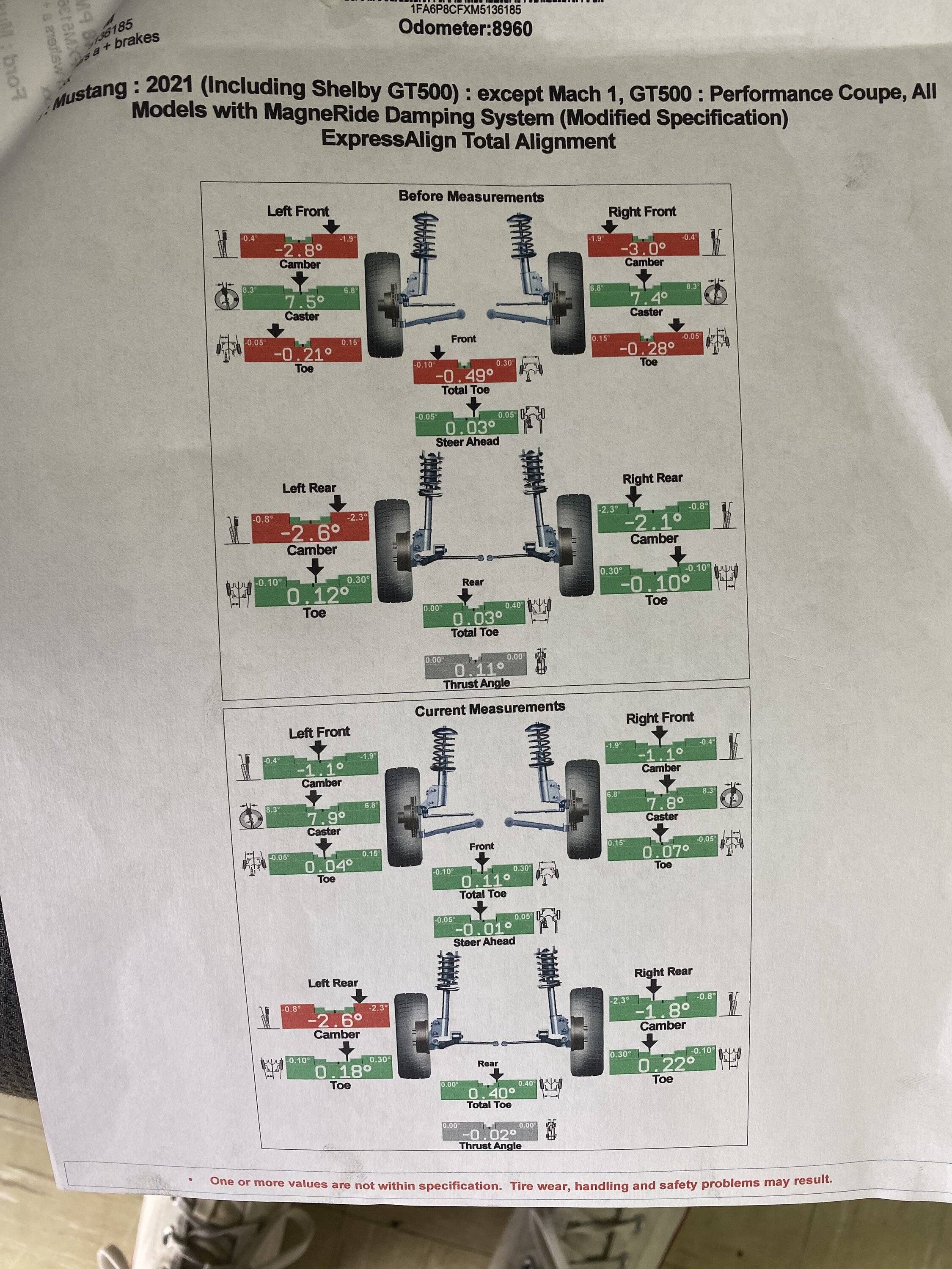

I'm lowered on Steeda Ultralite Extreme springs, with MM CC plates.
Took my car into a local shop who was very highly regarded in my area. Gave them my requested specs, slipped the tech $40 and left.
Came back to these numbers on the bottom.
They said they couldn't adjust the rear camber. No problem, I showed them where to adjust and let them try again. Got this back.
It was closing time for them by then, so I let it go. Still wasn't too stoked about some of the numbers, but it was better.

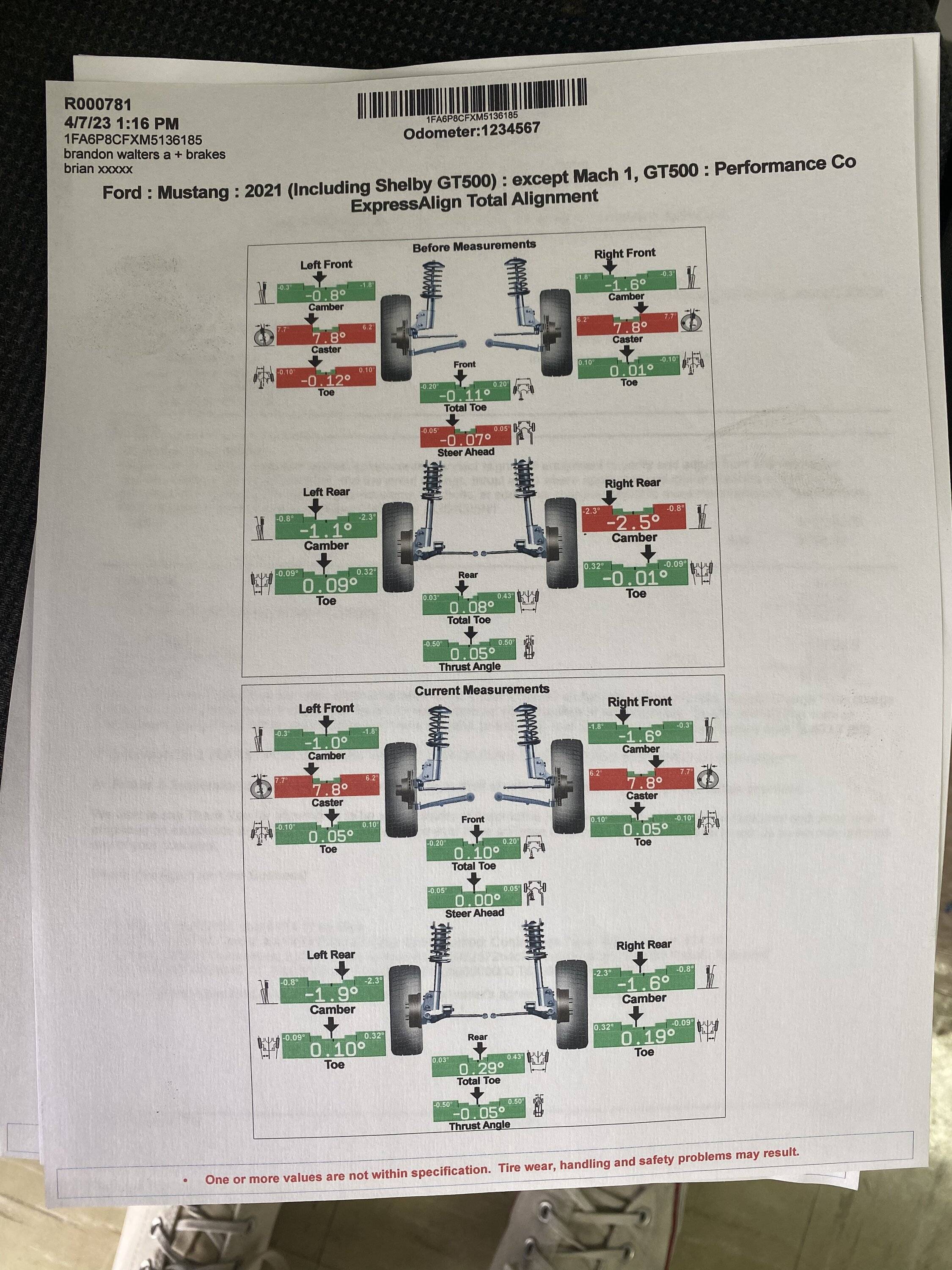

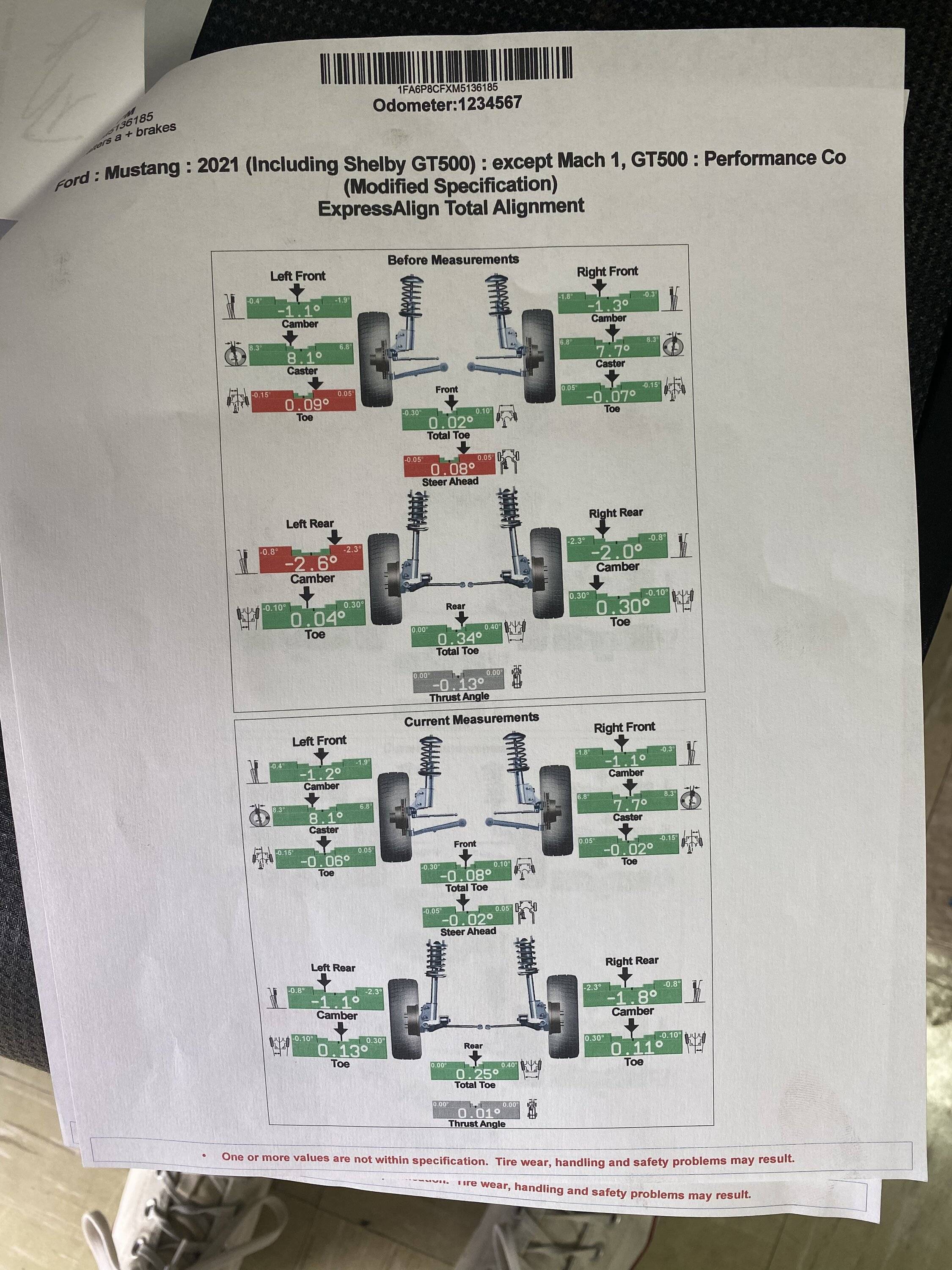

Came back today and had the shop owner check it all out. Got this back. "This is the best I am gonna get this thing."
My first question is, am I being dramatic for being unhappy with this?

What specs did you ask for?
The rear is only 0.3 different, which isn't too terrible (the rear is a PITA to adjust - camber and toe cross talk, so if you move one the other moves too. He probably had it closer but when he fixed the toe trying to wrap it up, the camber shifted again for the worse, and he ran out of patience....)
but yeah, its kind of all over the place. I wouldn't be happy with the front being 0.6 different.
If you paid for a $100 alignment, you might have gotten what you asked for. If you paid $200, well, I'd expect better and would be looking for a new shop for next time.

I asked for:
-1.2 F Camber
0.05 F Toe
7.5 Caster
-1.5 R Camber
0.10 R Toe
0 Thrust Angle
Paid 175.

Giant red flag with this shop. On your top 2 sheets it has (Modified Specifications). This means the tech went in and modified the maximum and minimum limits to make something show up as green that should have been red. There are very few legitimate reasons to do this. In your case, the front camber adjustments pushed caster out of spec. Instead of explaining that, he took the low road and changed the specs hoping nobody would notice and ask questions. His boss either has more integrity, or didn't no how to manipulate the machine.
Which is weird that they'd do that, I told them I didn't care about "getting in the green" as long as the numbers were right. I'm 99% sure my requested specs are within factory anyway.. oh well. $200 down the drain, i'll take it somewhere else.
