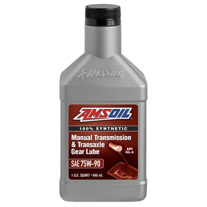

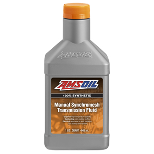

Holy crap. I was wrong guys. I looked up my invoice and this is what I purchased. I SAID "diff" by mistake...
Manual Synchromesh Transmission Fluid 5W-30
Quart Bottles (MTFQT-EA)
Qty:2
$18.29
ADDED TO CART
Manual Transmission & Transaxle Gear Lube 75W-90
Quart Bottles (MTGQT-EA)
Qty:1
$20.19
RE-ORDER
RE-ORDER ALL

So based above, should I try straight MTF?
