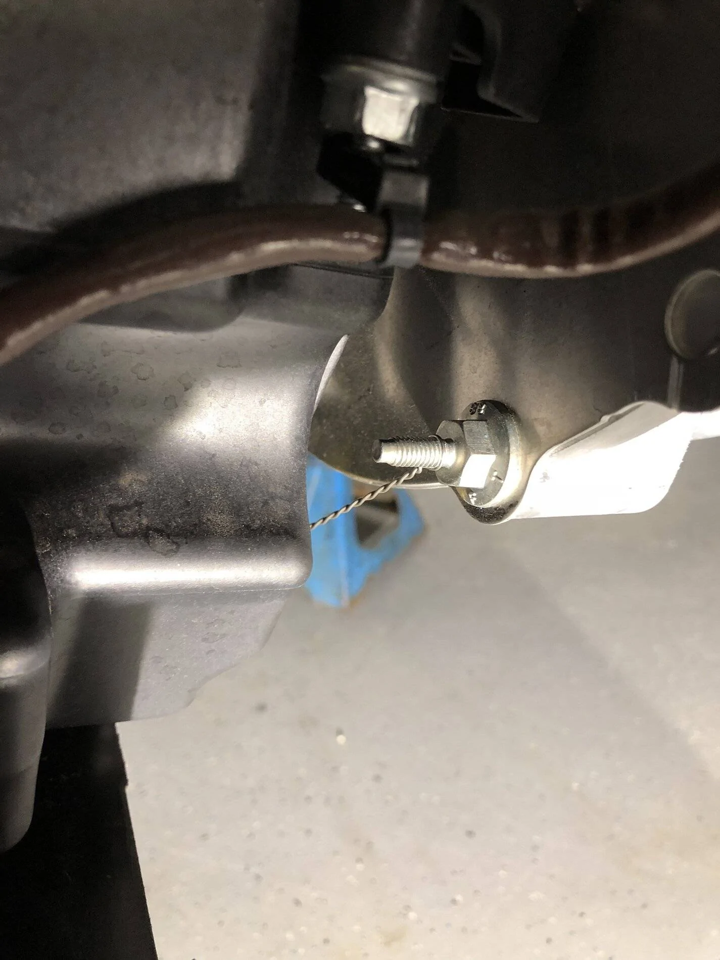

Do a complete nut and bolt check before track days. I have a neurotic process for oil changes and track day prep. Was super busy and skipped the last minute nut and bolt check that I do right before putting it in the trailer (I did the post-day one, but obviously that doesn't help with an oil change).
Ya boi got REAL lucky on this. I have a couple safeties in the car (oil pressure lights + accusump) that would've hopefully come on, but DAMN. I'll give myself the idiot award for the month of May :)

yikes! i often worry about the oem style plug... i assume thats a totally diff pan?

You've got to remember that it doesn't simply twist in and lock like the O.E. pan....... Glad you didn't cause serious damage.
Yeah, This is the GT500 pan. Love the pan. This was just a huge idiot moment
I'm guessing I just hand tightened it and forgot to check it with a torque wrench. Argh

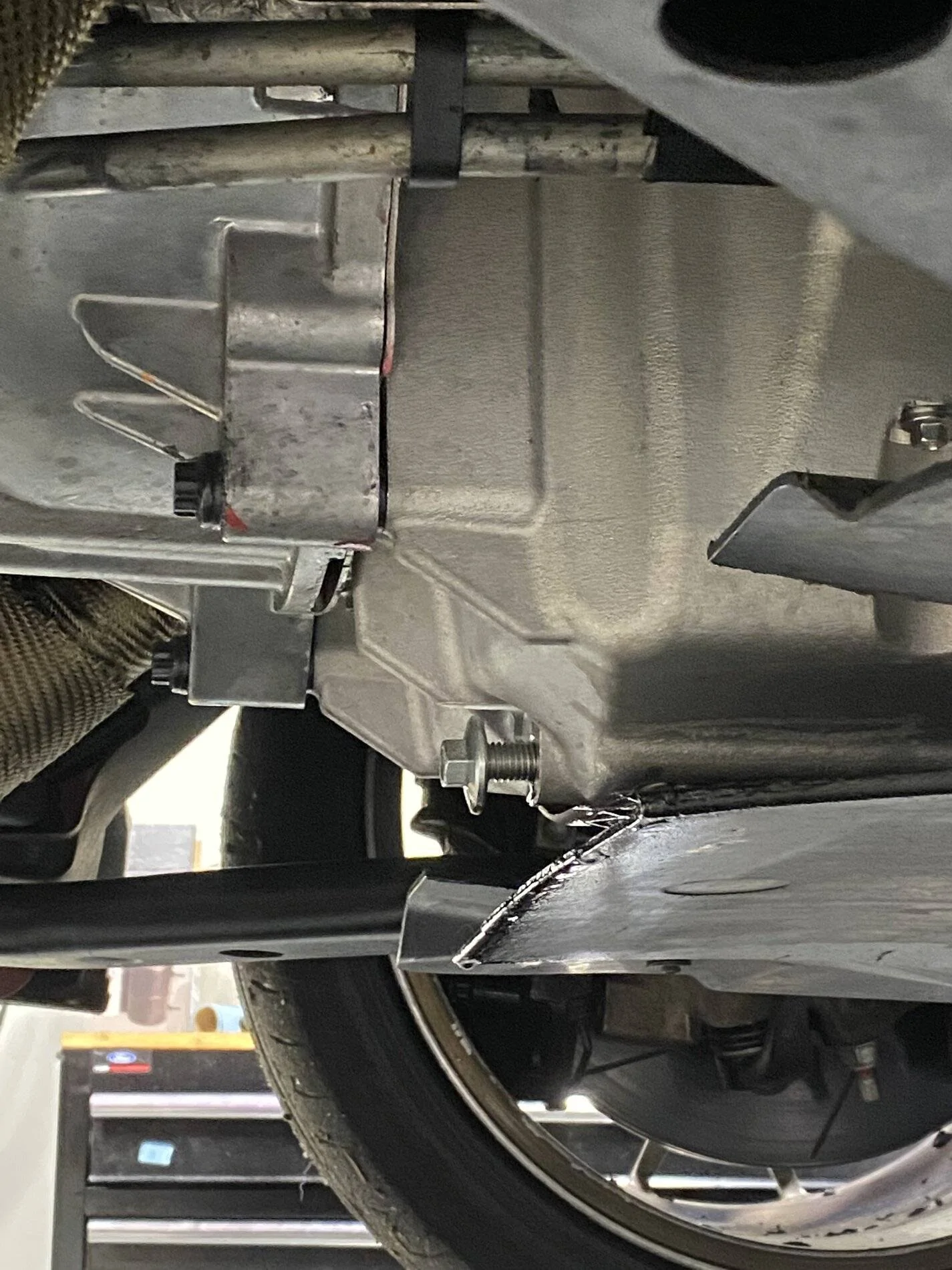

What's the red on the bell housing bolt, side of bell housing and on spacer plate in the image? Is that trans fluid or Red Loctite?
Pink bolt marker :)

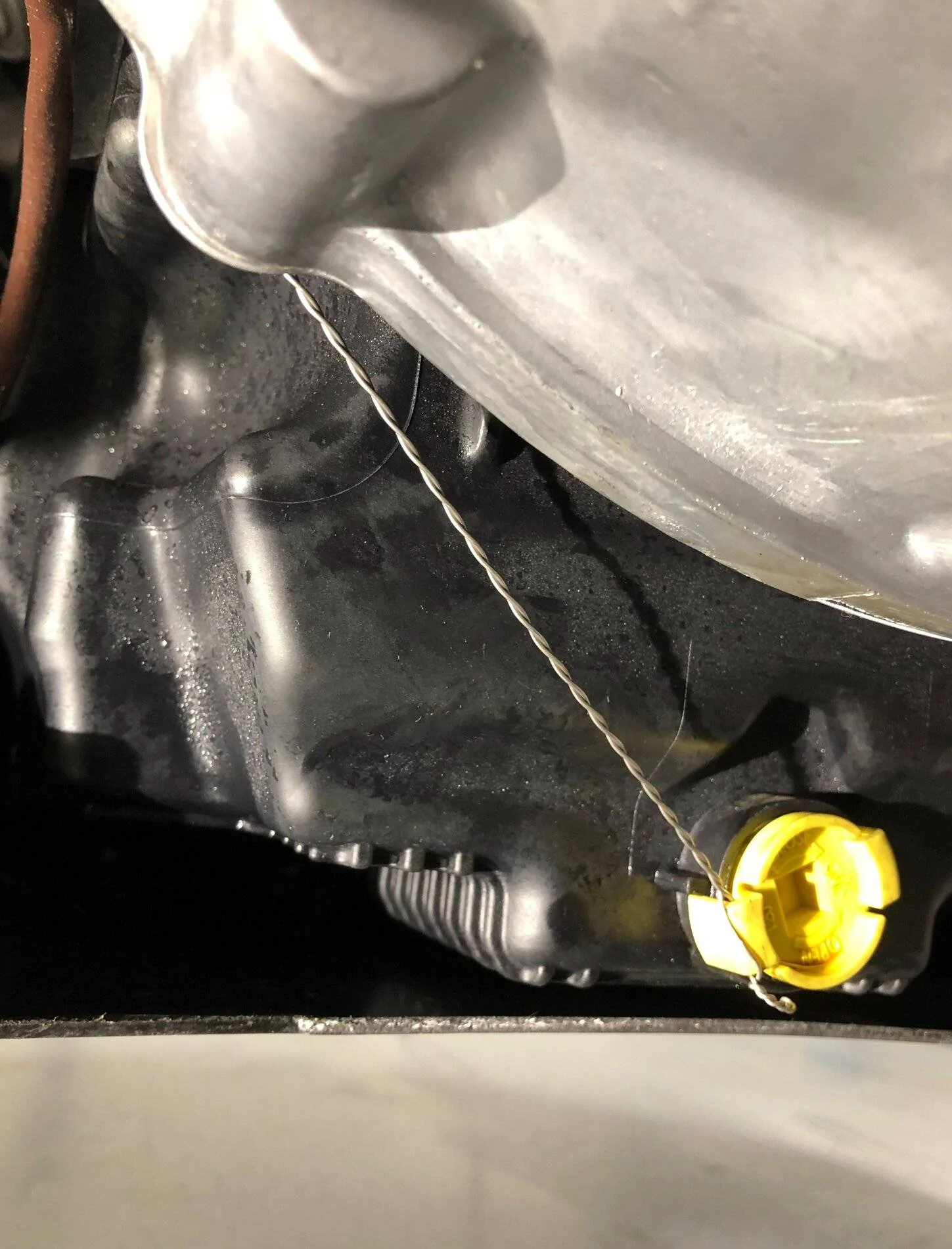

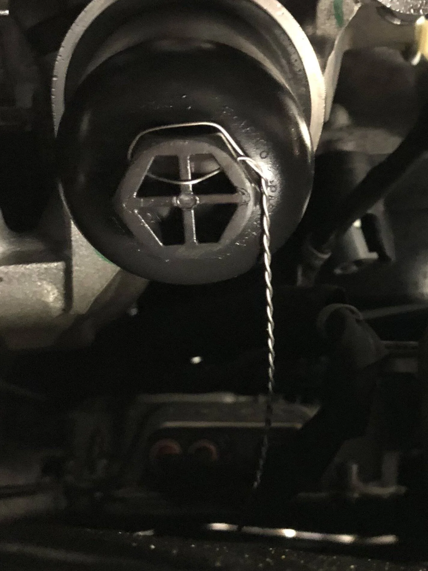

She not comin out. I do this track or no track. I do it because I’m a big nerd and not because I’m worried about it coming out, but hey, if we can kill two birds with one stone....(yes...i safety wire a cartridge oil filter...sue me ;)
No crush washer on that bad boy?
Congrats on avoiding a disaster. Looks like you had maybe 7-8 threads left in there??
Appreciate you ā€˜fessing up and posting the pic here:like:
