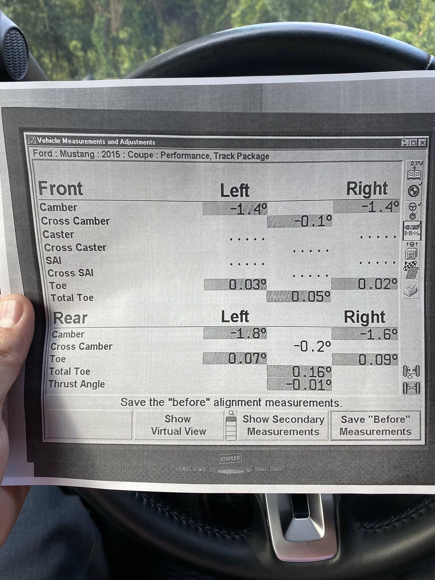

Rather than start a new thread, I figured I’d post my alignment specs here for some feedback. I’ve got a 2019 GT PP1, lowered on Steeda Sport Progressives, have front camber plates, and 20” wheels with 305/35 rear 285/30 front. I told the shop I wanted alignment for street only as I don’t expect to do any type of racing. Here’s where they set it. Thoughts?
BranoSK
Sep 1, 2020
new jersey
brian
2015 mustang gt
Hi guys
i got car with Eibach Sportline Lowering Springs and i ill install
- Whiteline Rear Subframe to Body Bushing Insert Kit
- Steeda IRS Subframe Alignment Kit
There is 275/35/20 rear and 255/35/20 front tires
Planning to use car mostly on street but i use to race with bikes so Im planning to go and have some time at race track as well (prox 85% street 15% race track)
Next week i ill go for aligment Its there some specific recommendation of aligment for this set up ?
What is you suggestions guys?
THX for any advice
bnightstar
Mar 15, 2019
2,441
1,348
Bulgaria
Hristofor
I'm not lowered however the alignment spec I use is as fallow:
-1.4 Camber all around.
F: -0.2 Total Toe
R: +0.2 Total Toe
This alignment changed how the car behave and helped with the rear end sliding. The car is super predictable and corners like on rails. I love it and had a lot of fun 2 weeks ago on the Most famous Bulgaria Mountain pass chasing some Evo X's.
