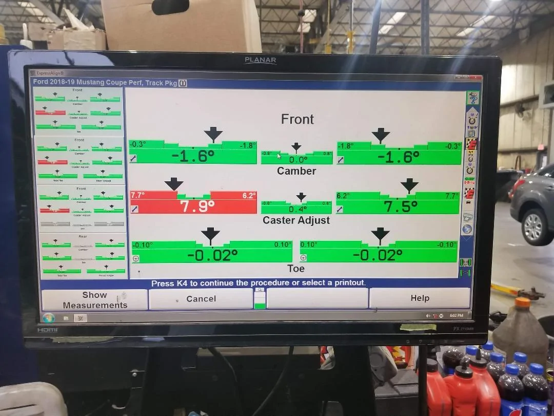

Has anyone had the issue with the front end not meeting specs for alignment after lowering the car? Just installed steeda progressive springs, steeda pro action struts and camber plates

Yep. Mine didnt fall into spec afterwards. No big deal you will need to install camber plates or the lower cost and less labor intensive method, camber bolts.

I already have camber plates installed.

Did you install them the right way and did you tell the shop that did the alignment you had them? What sort of shop was it? Depending on where you took it, the techs may not have done much.

Really,check to make sure they are installed correctly, and if they still cant move it into alignment. Then camber bolts are the thing you need.

I bought the struts,springs, and camber plates assembled from steeda themselves. Yes the shop was aware of the camber plates and the tech is very well known in the area.

That's why I opted to get caster/camber plates to adjust caster. With just the camber plates there's nothing you can do to change that caster.
