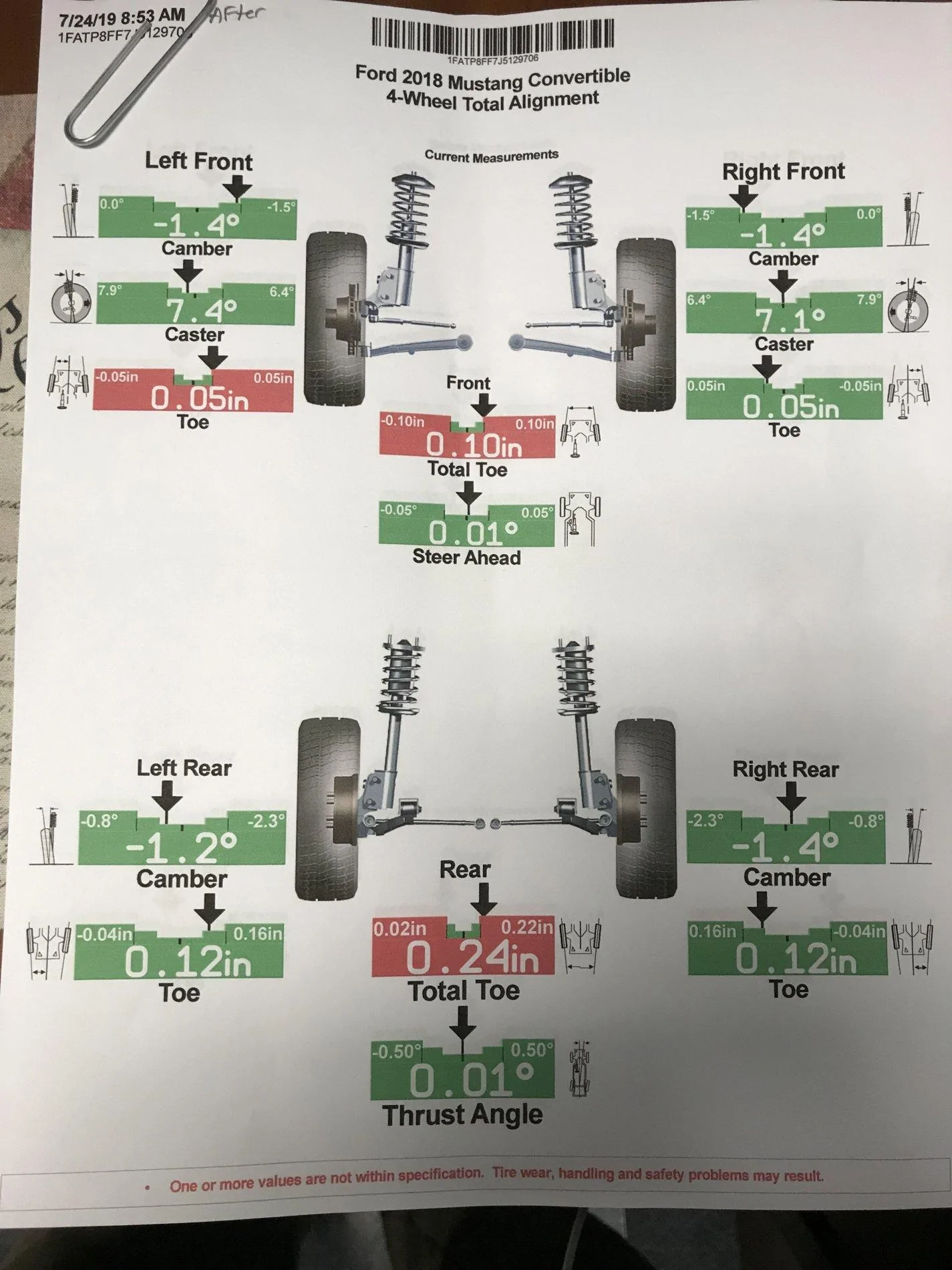

barron64
Jul 25, 2018
27
541
657
Auburn, AL
2018 Mustang GT convertible PP1, 6sp, 2006 Toyota Tundra Dbl Cab 4x4, 2009 Acura MDX, 2007 Toyota FJ Cruiser
I have the same issue...16K miles and cord showing on inside shoulder of RF tire. LF is maybe 90% as bad. Car has been aligned twice since January when the dealer installed new strut bearings. I have had one play day at the track and a couple of fun mountain weekends but if I had even wear, I could have gotten maybe 20-25K out of these. Lot of tread left on remainder of tires. Rears are wearing normally. Toe has to be off to get this much wear on the inside shoulder, this quickly considering car is aligned to factory specs.
barron64
Jul 25, 2018
27
541
657
Auburn, AL
I installed a set of Steeda camber plates, new set Michelin’s 4’s and aligned to BMR specs. Toe was off some on the front which probably caused the inside shoulder wear. Hopefully I will get better wear across the width of the front tires. Looking forward to some curvy road fun... and maybe another track day!

Still learning about aslignment settings...Kind of puzzled why you would have rear "toe in" on an irs car? I get the front having "toe in" as the car is moving forward, with braking applied, it tends to pull the "toe out" towards 0 as these forces are applied. On the rear however, seems that rear "toe out" would be the norm...When the car accelerates it would pull the rear wheels forwards or "in" towards 0 toe. What am I missing?
