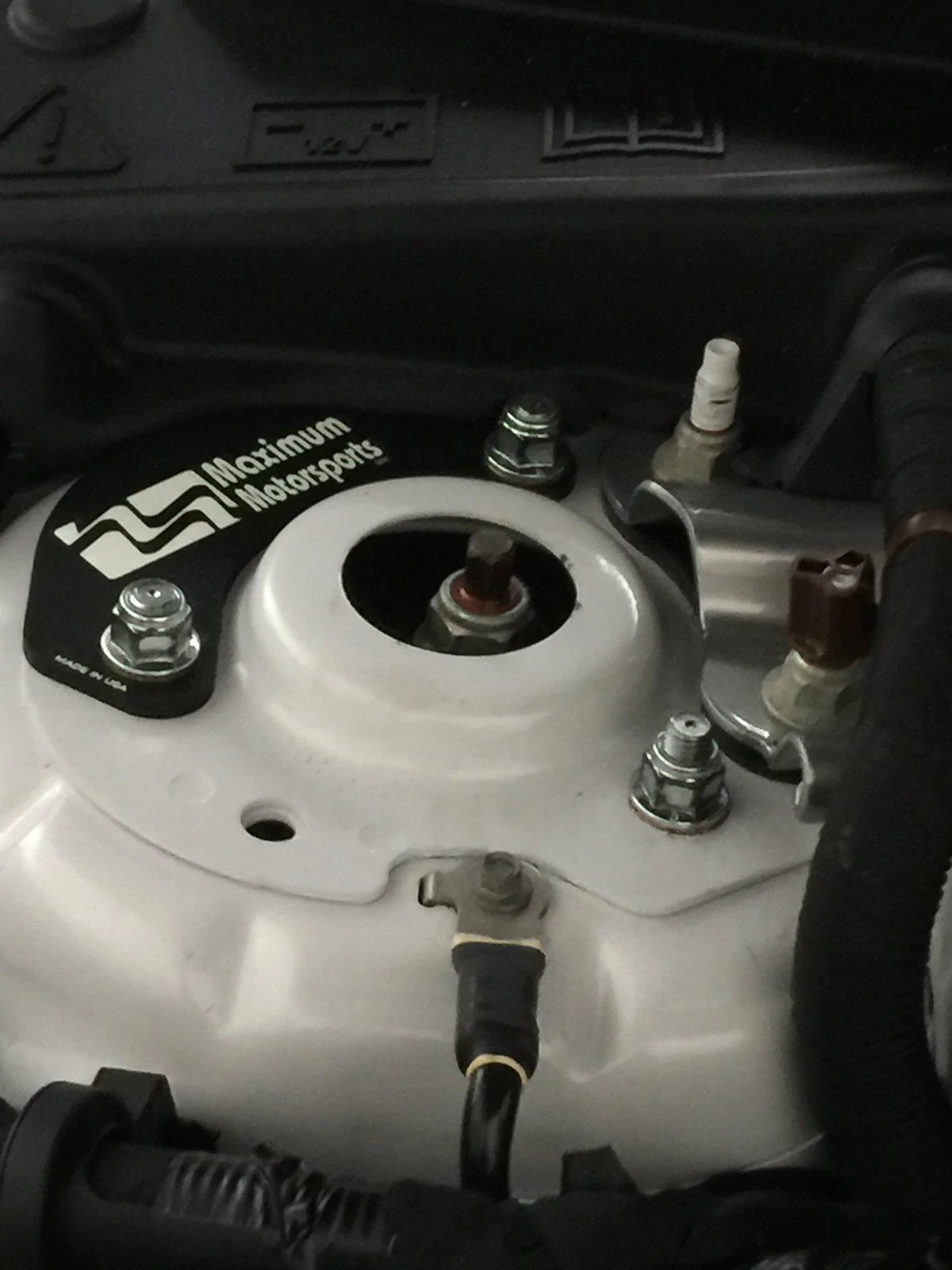

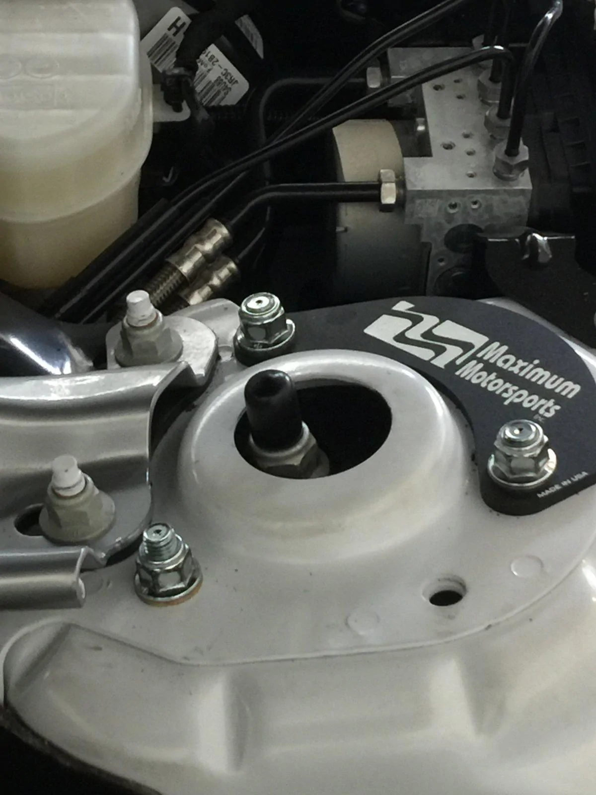

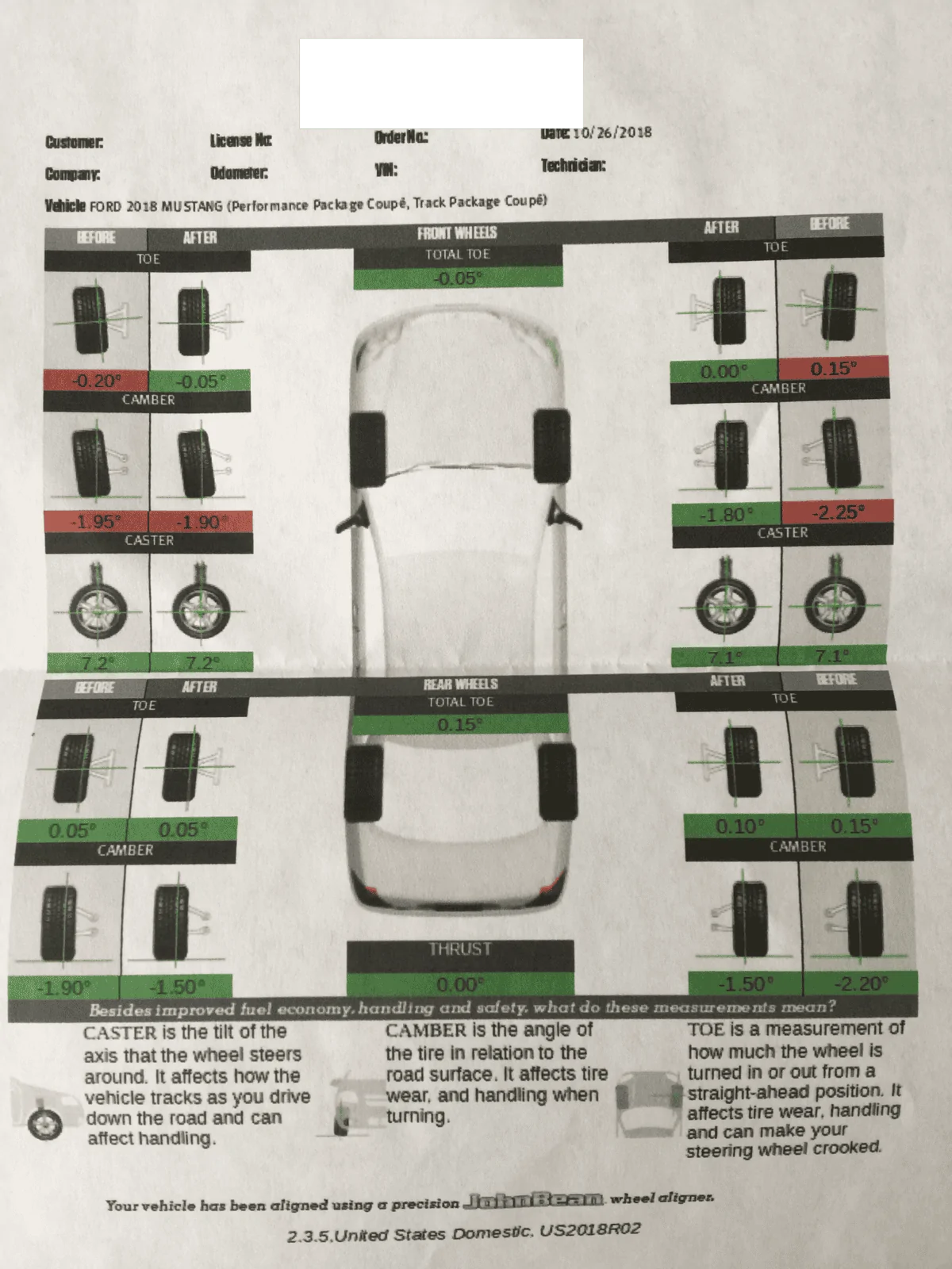

I had camber plates installed and an alignment done(second time). I wanted -2.2 camber in the front and 1.5 camber in the rear. He wasn't able to get the front dialed in as you can see from the pic. I included pics of the top side plates(first is the left and second is the right) to see where the position is at. Why is it you think that we can only get 1.9 out of these plates?
I will say that the strut original positions, before we aligned it today, were practically the same as the right side but look after today. It looks like the right side is maxed out and the left if just over half of its adjustment. What could be the problem?

I wonder if something moved on the rack? The right side was at -2.25 when they started based on the before measurement so I don't understand why they didn't leave it and adjust left side to match. I think I would go back and have them re-check the alignment
