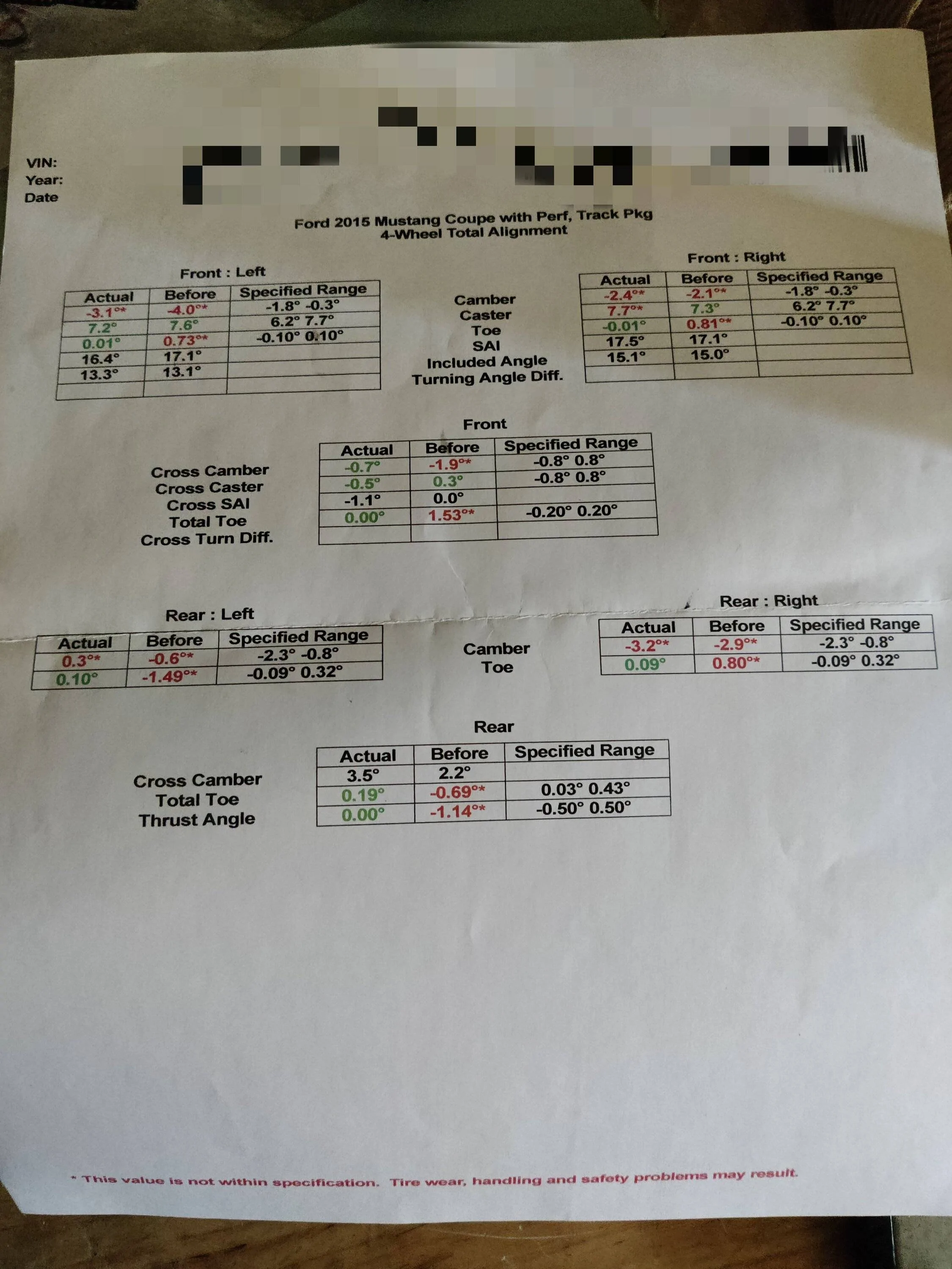

Front camber is -2.4 (passenger - can't adjust to anything more), -3.1 (driver - can't adjust to anything less).
Rear camber is -3.2 (passenger) and 0.3 (driver)
Toe is zeroed in front and 0.19 rear (which is about what I was wanting).

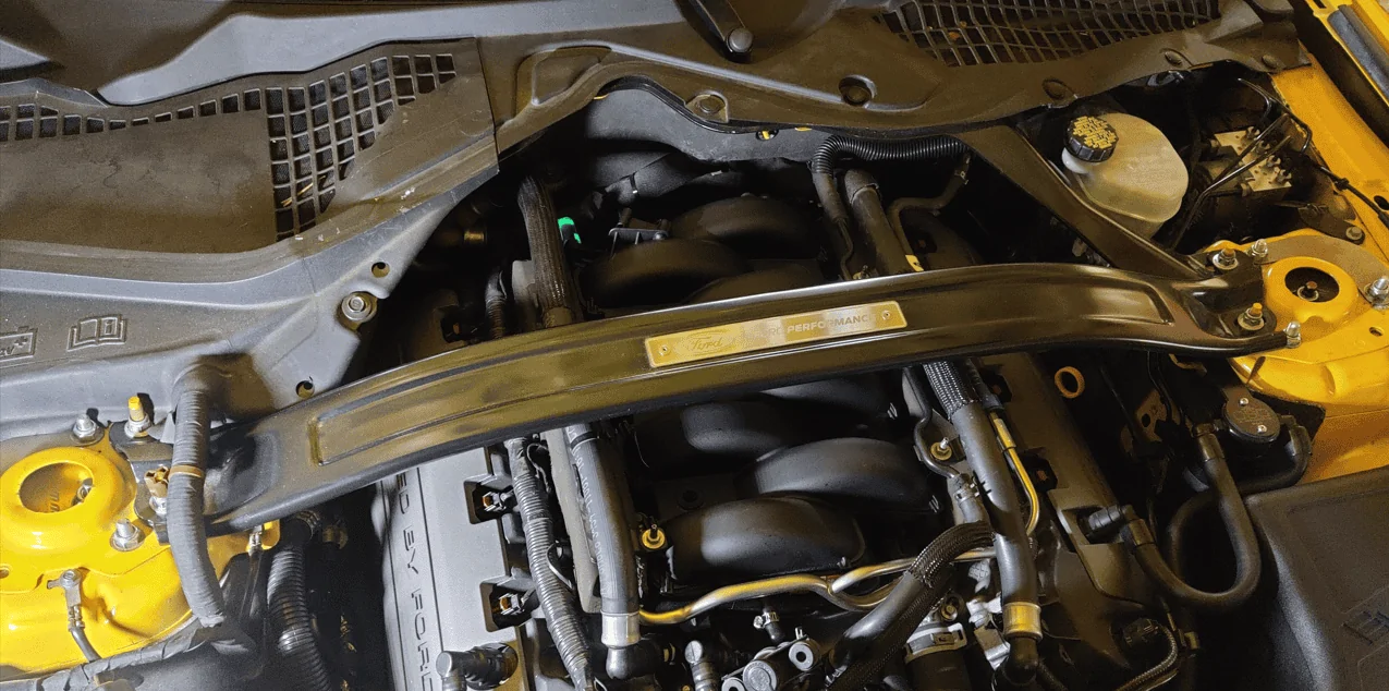

Here's pic of the camber plate adjustments that they did to show these are at extreme ends:

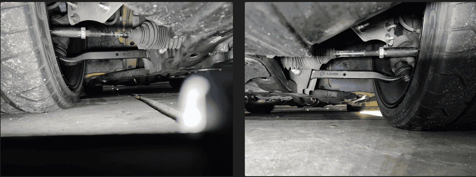

Tie rod adjustments:
Passenger - driver

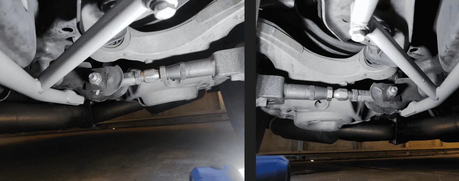

Rear toe adjustments:
Passenger - driver

that passenger front camber should be 3+, and the driver should be <2 with those strut tower positions unless something else is whack. What shocks do you have? Are there slotted struts or camber bolts in there? Strut mounts can get bent. Is you caster even or is it also whacked out?
for the rear, I bet the shop doesnt lnow where the stock camber is adjusted and they’re trying to do it all with those aftermarket parts and are neglecting to adjust the factory camber slotted pickups. The rear is a PITA to adjust but you should not settle with that crap camber alignment.
edit: for stock strut tower openings the passenger might be ok but the drivers side is sure not right.

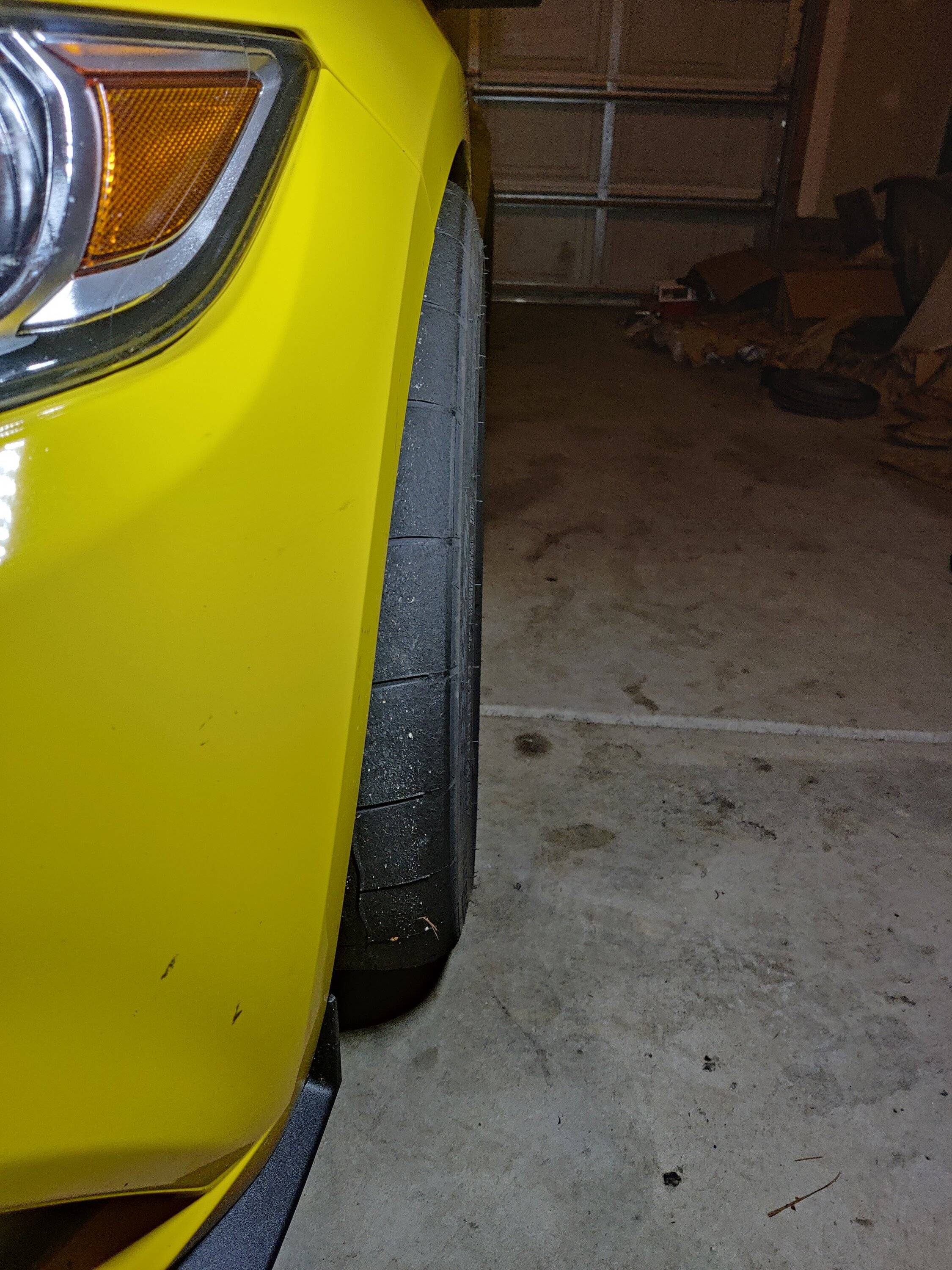

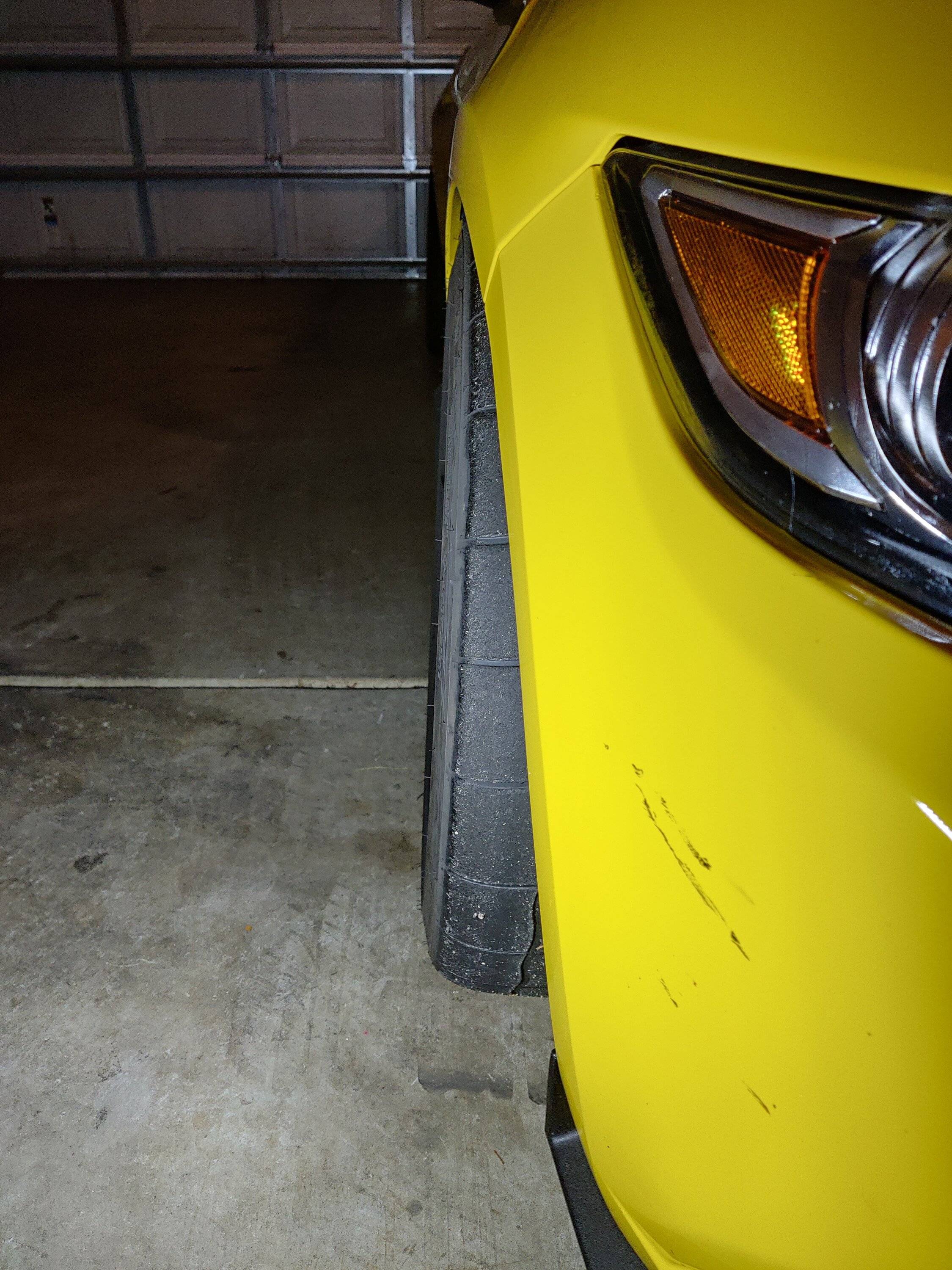

Also...I just did another visual ..and am I crazy or does it look like I have significantly more camber on passenger vs driver...or either the tire is just stuck out more on driver side somehow?
Passenger:
Driver:
Also attaching their alignment sheet for reference:

Yeah the photos jive with the strut tower photos - and they’re inconsistent with the printout. I think your alignment guy doesn’t know how to mount his equipment on the wheel or something.
so back to step 1 - find a better alignment shop.

Yeah...The plate adjustments do seem to match visually with the tire angle and does not match the printout. The rear does unfortunately look to match the printout but either way. I'm going to try to find a more competent shop or figure out a way to just do my own alignments at this point.

The rear stock alignment points (which are probably the issue w/r/t the rear camber) are a pain to adjust. Best to find a shop which can do it. Plus the toe and camber adjustments cross-talk with each other.
but front camber you can kinda to at home and just take it to a shop to fix the toe (or go get you some toe plates and do the front yourself). Either way tho unless you have an alignment rack, you’re lrobably going to want to take it someplace to do the rear alignment.

Yeah, I agree. This place seems like they just measured wrong to begin with on the fronts. I didn't take exact measurements, just a leveler I have, but it's clear now that passenger has more camber than driver (doesn't match the sheet at all).
