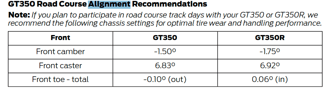

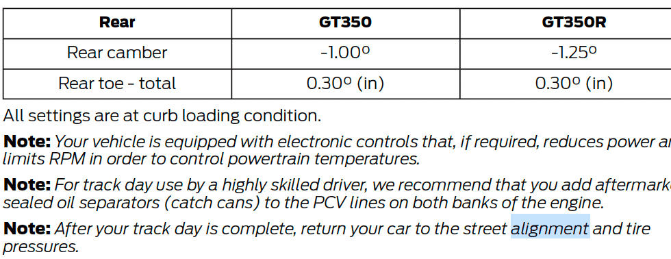

Im trying to figure out what would be the best alignment to get on my car to get it dialed in with the new suspension mods ive done on my car. I was originally using ford performance specs (i cant find them anywhere anymore) but ive added quite a bit more to it since then. It will be a daily driver but the occasional road coarse but mostly going through twisty back roads. Any suggestions would be appreciated.

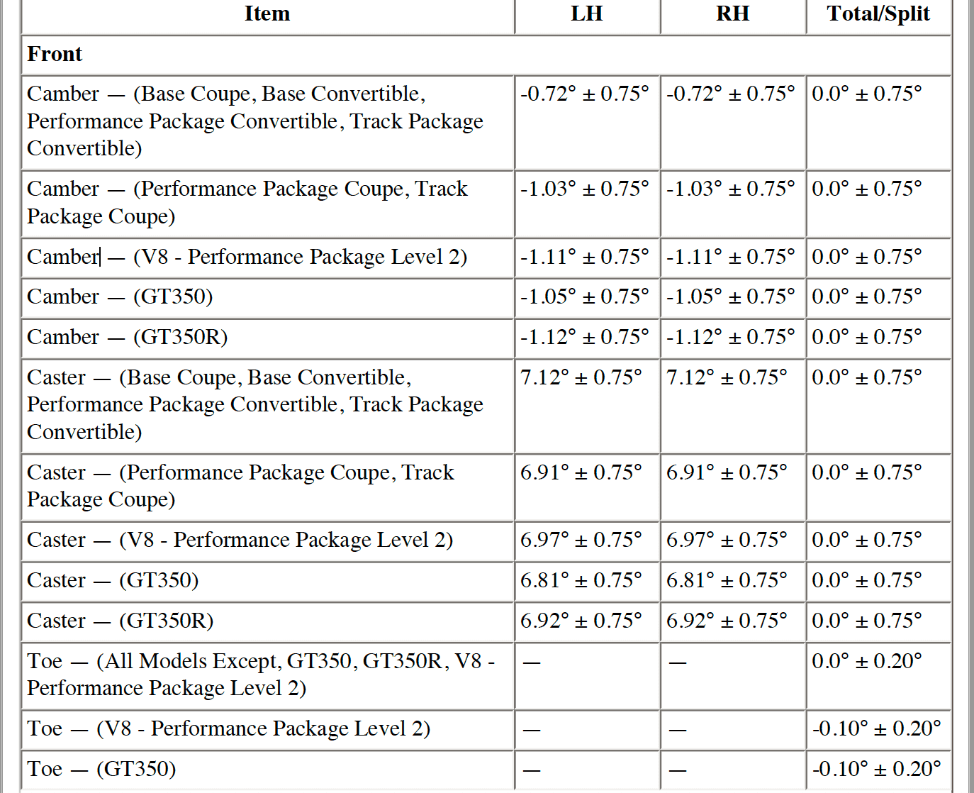

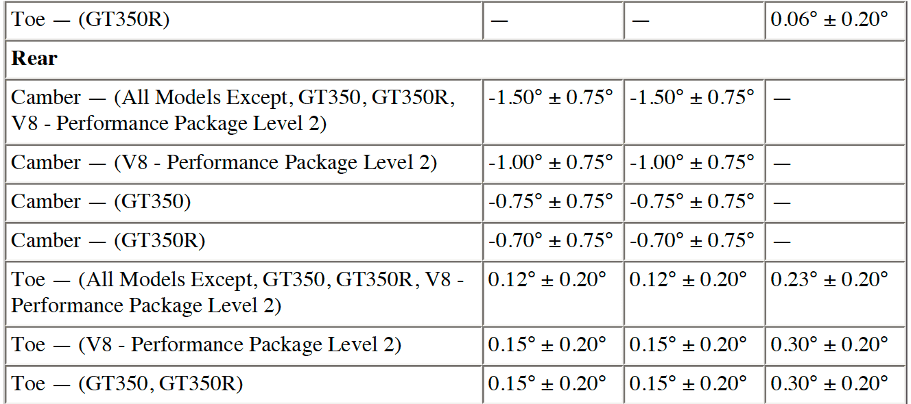

Well he should be. I am running almost the exact same setup (mods) and I always run stock alignment specs unless I am tracking my PP1. Frankly most of these mods are for removing lateral defection and work perfectly fine with stock alignment specs. In other words, your alignment should be as neutral as it gets (e.g. stock) for normal everyday street driving. Not to mention the 350 and 350R (not track specs) are very aggressive. If he wants Ford specs for track days, I'll provide that too.
Just curious are you his father or brother? I find that only they tend to talk for someone.
